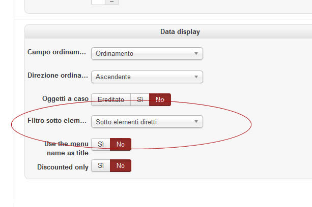

In the "products options" tab of the settings of your menu item, set the "sub element filter" to "direct sub elements".

Hello
I did what you sayd but I still see the product on the home page.
I link the page: www.redskull.it and i attach the image of setting
thanks
Frank

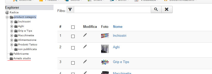

Myabe i Found the problem, pratically when I created the first products I assigned them to their category and to the product category, so I assigned just the category they belong to, and now in home I see the category with no products.
I noticed that i created a category that now I can't modify anymore couse it looks child of root and i dont know hot to delete too.
What can i doo?? I attach the image to be clear the category name is Arredo Studio
Frank

I solved :blush: :blush: About the category that i could not delete
