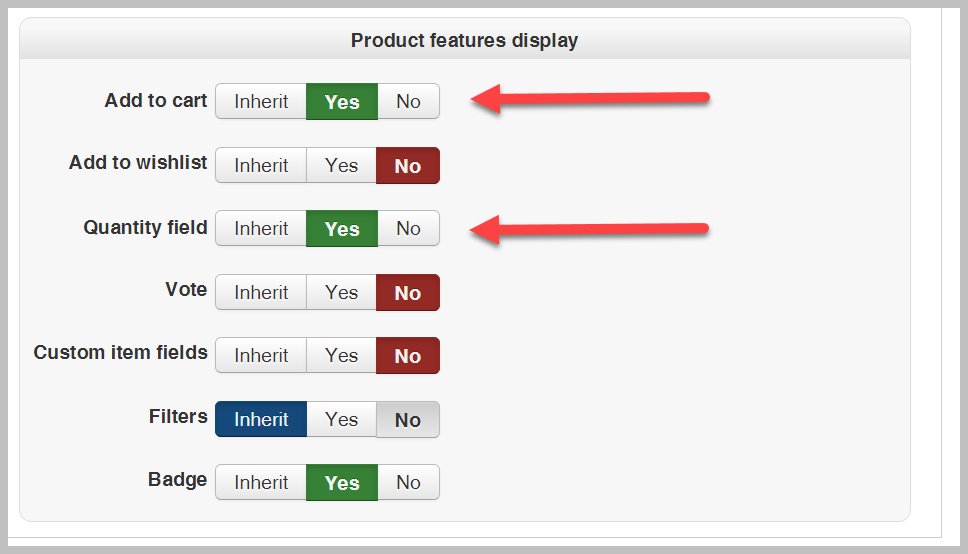

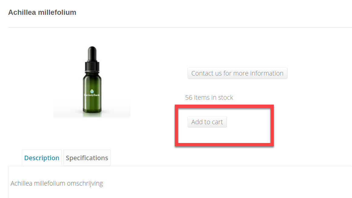

Hi Team,
I want to have the quantity field into the table view. But this is only possible when I turn on the Add to cart button.
But I only want to see the quantity field not the add to cart button. Is this possible?
Kind regards,
Lumiga

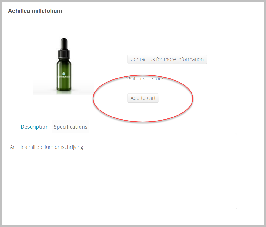

9 years 9 months ago #254182
Hi, sorry for my late response, but I didn't get any e-mail from your replay.
But anyway if I set "Display the quantity field on the product page" setting to "global on listing" in the HikaShop configuration. It looks perfect but it also delete the quantity field on the product-page and that is no what we want. Is there any solution for?
Kind regards,
Lumiga

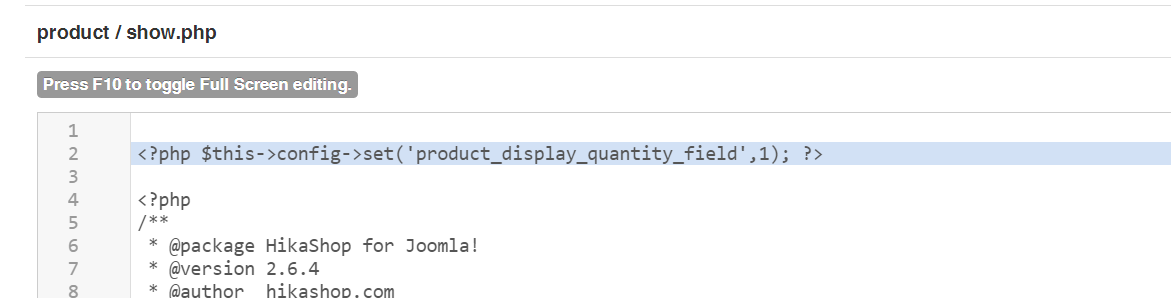

9 years 8 months ago #257958
Sorry for my late response.
I add the code to the "show" file of the view "product" but nothing happens.
I cleared the cache but still no quantity filed on the product page.
I put the code over here.
But still no quantity field.
Kind regards,
Lumiga
Kind regards,
Lumiga

9 years 8 months ago #258004

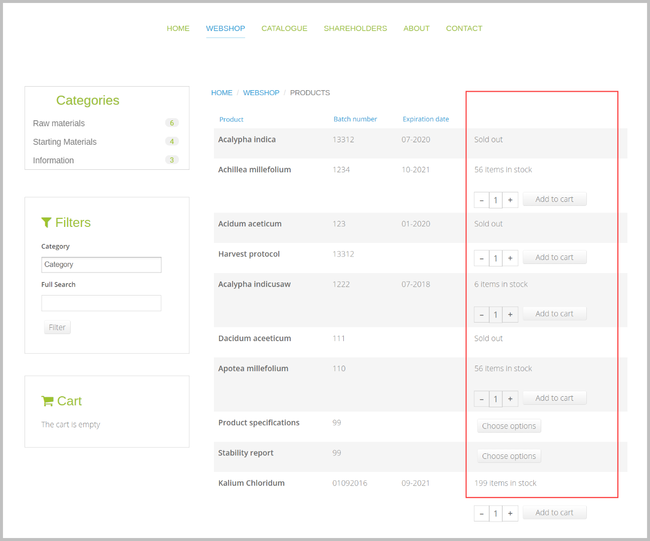

I replaced the code and it works fine now.
But I realise this is not what we need. We need only to display the stock on the list view.
I'll make a new ticket for that. Because this one is solved. ;-)
Thanks!

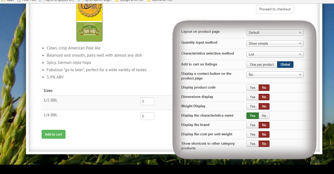

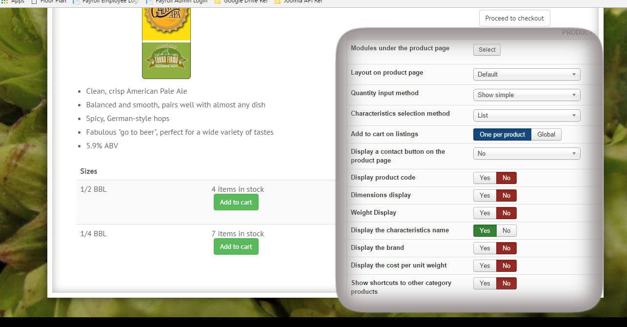

I've been struggling with this same issue (and a few others related to some previous customization) since upgrading from Business 2.6.1 last night. The code overrides detailed in this thread are not currently working for me, but it seems odd that they should be needed. I would expect that the "Show Quantity" configuration should apply regardless of the layout style chosen. It's also puzzling that the ability to input a quantity changes with the One Per Line-vs-Global Add To Cart config option. Am I missing something? (I usually am...)
Matt
