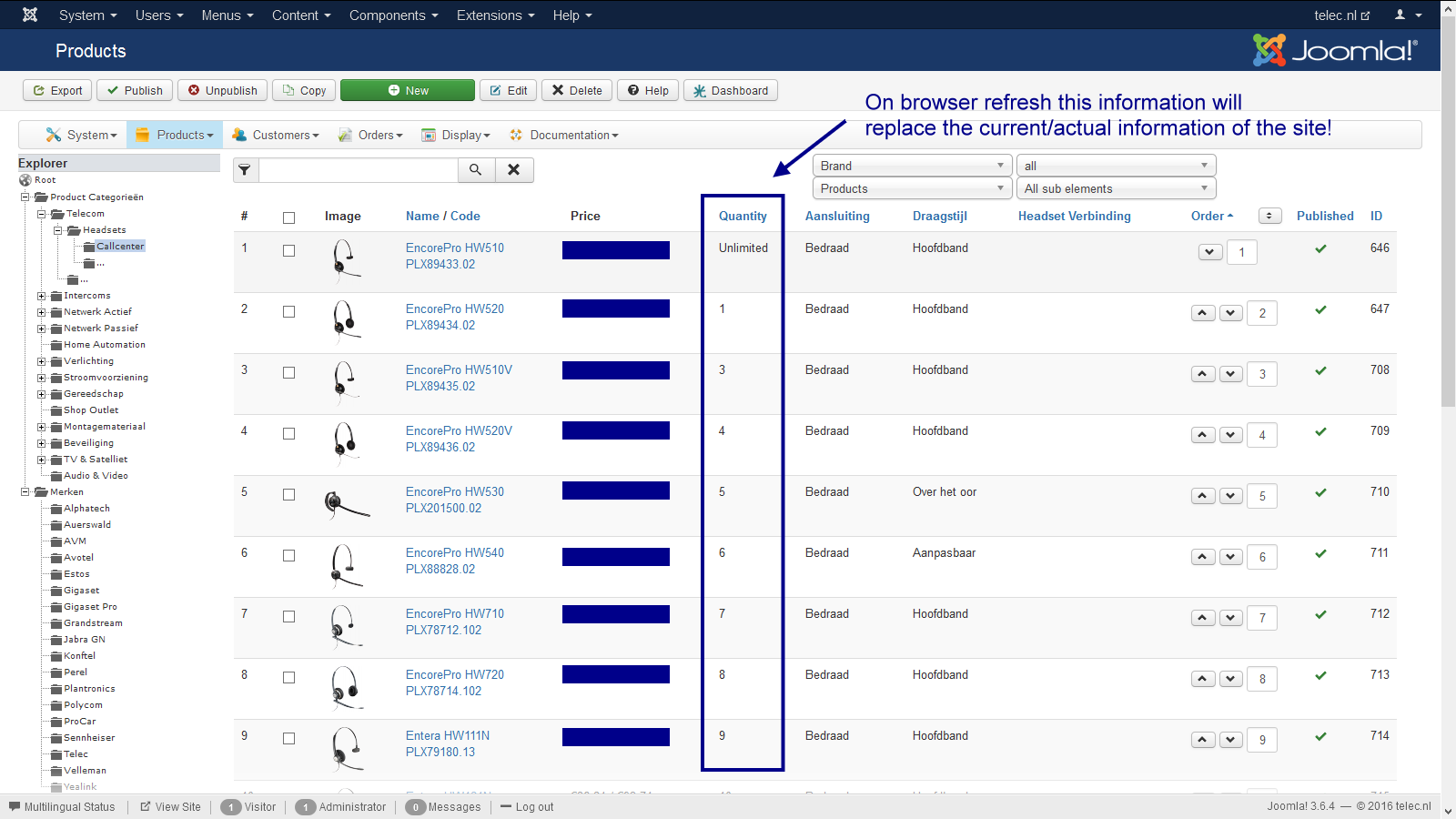

That is what it is expected to do, but what I find is that if the stock is changed because an item is sold and you will refresh the front page it will display the new stock, so that is as it should be. But if you are in the back end viewing the same articles as been sold and you hit refresh after the stock is updated the stock is updated again with the stock currently displayed in the back end.
So the item in the picture with cid 647 is sold and the stock will be changed to 0 in the database and the correct stock is displayed in the front end.
But you are working in the back end and hit refresh for that screen, so you do not open the items page, and the stock is updated again with the values displayed at that moment.
If you would leave the screen and open it again without using refresh the new stock is displayed as it should.
Just try it and see for yourself what is happening, if you do not see it changing in the database then there is something wrong on my side, otherwise it is not doing what it is expected to do.

  • Posts: 101
  • Thank you received: 8
9 years 9 months ago #255307
Afternoon Nicolas,
No you do not understand, I am NOT opening the item I just hit refresh in the screen of the attached picture, there is no option in that screen to adjust the stock only to change the order of the items, that is what made me worry.
I will test it again, just to be certain and let you know.

I did find my mistake for the page refresh and the stock update, it is more or less in the browser warning: “To display this page, Firefox must send information that will repeat any action (such as a search or order confirmation) that was performed earlier.”
1- So I open an item and in this case change the stock from 0 to 1
2- I press save and close and return to the global item view as in the picture
3- The item I was working on is sold so the stock goes to zero
4- Still in the global screen as in the picture I refresh the browser page
5- I get the Firefox warning and select Resend
6- Stock is update to 1 again
This does mean that Firefox is repeating my steps, so opening the item and changing the stock in the background.
If I would leave the screen, as in the picture, and open it again (at point 4) and do a refresh the correct is displayed being zero.
I find this behavior a bit confusing, but I will pay more attention to these browser warnings.
