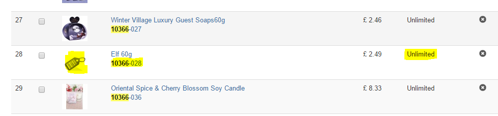

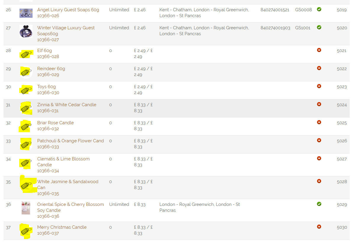

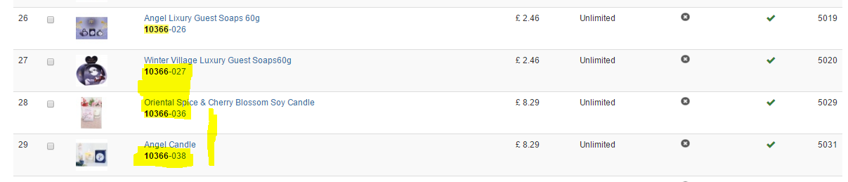

At first I thought it was because the items were not published was the reason they were not showing up in the back end. All of the ones that are missing have no picture. Could this be the reason?
How can I get all the products to show up in the back end?
I have attached a picture showing the products from the front end (they do exist), and also another picture from the backend (they are skipped). You can see the product codes 10366-XXX in the images which are in sequence. You can see the gaps in the numbers (the ones without images) in the bottom image.
Thx, Darrell

9 years 9 months ago #255293
Forget the picture thing.
The products don't show up in the backend if the quantity is zero. It has to have a quantity or unlimited.
10366-028 is now showing up in the backend (example). It is not published, and has no picture but it now has a stock quantity of unlimited. It has a stock quantity of zero before.
How do I disable this so that all items show in the backend? Is this a setting?
Thx, Darrell
