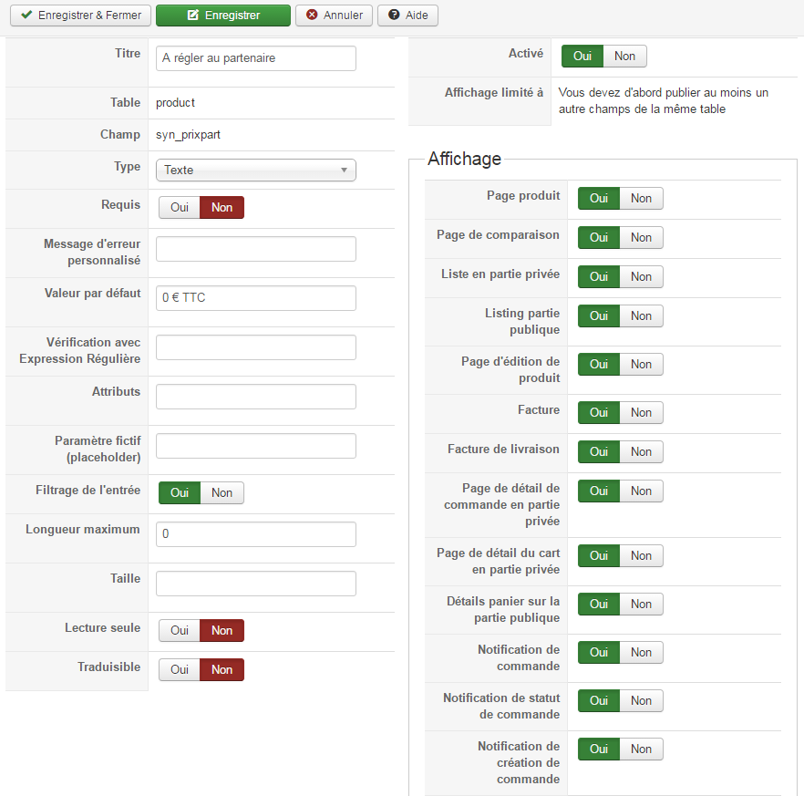

You sure can use a custom product field. You can just create it via the menu Display>Custom fields and use such code:
<?php $row->XXX; ?>
where XXX is the column name of the custom field.

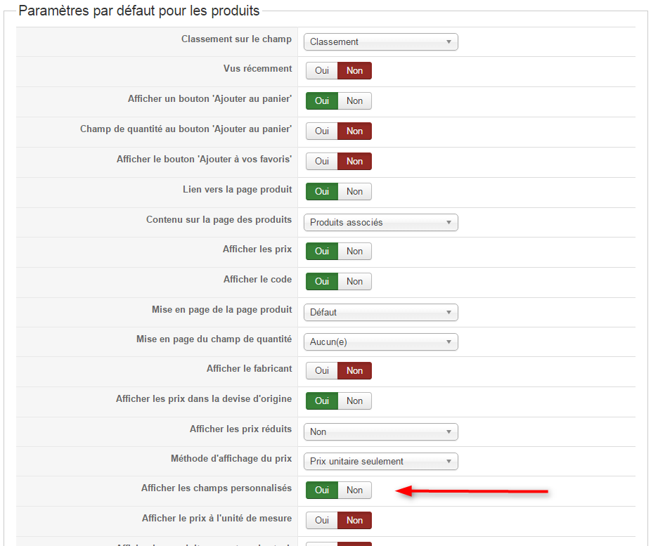

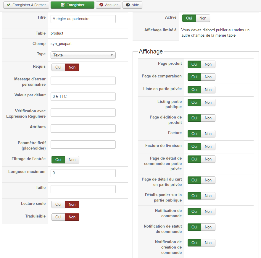

  • Posts: 88
9 years 9 months ago #255389

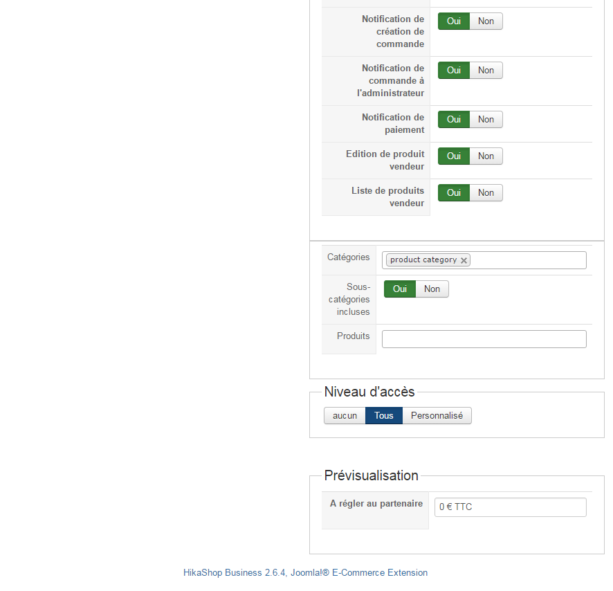

I have created a personal field for products like this :

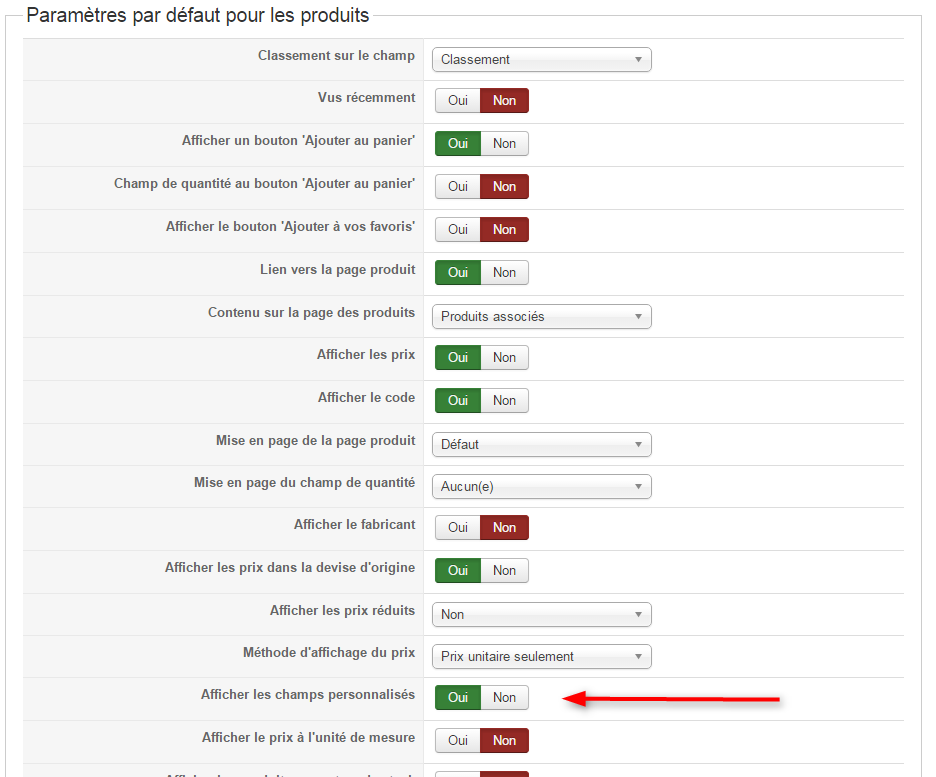

Have also changed the hikashop configuration like this :
But this field is only visible on Hikashop product page backend...
What have I done wrong ? maybe not done ?
Thanks for your help and advise,
Best regards,
Stéphane
Last edit: 9 years 9 months ago by steph3838.
9 years 9 months ago #255392
If you have set a value for that "product" custom field through your product configuration page, that value should be displayed through your front-end product page detail.
Can you also show me where do you exactly want that field to be displayed and how through some screenshots for example ?
Thank you.

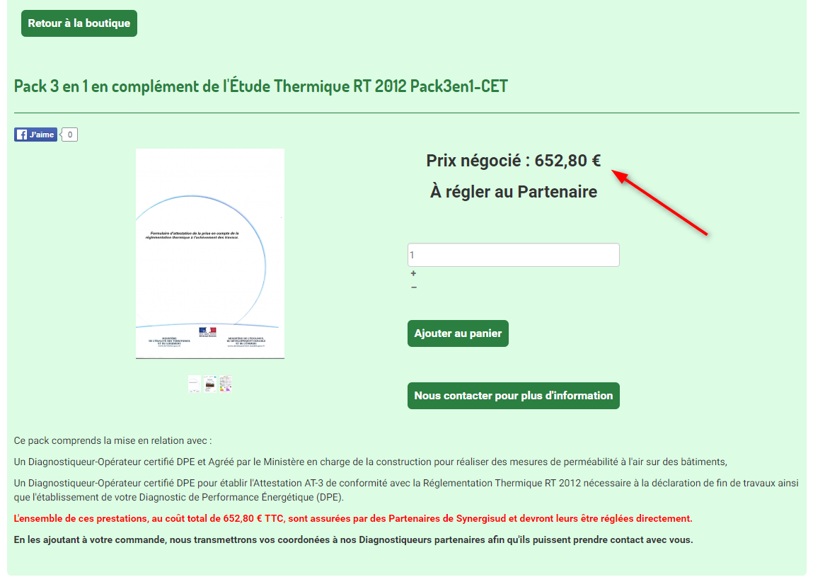

  • Posts: 88
9 years 9 months ago #255457
Hello Mohamed,

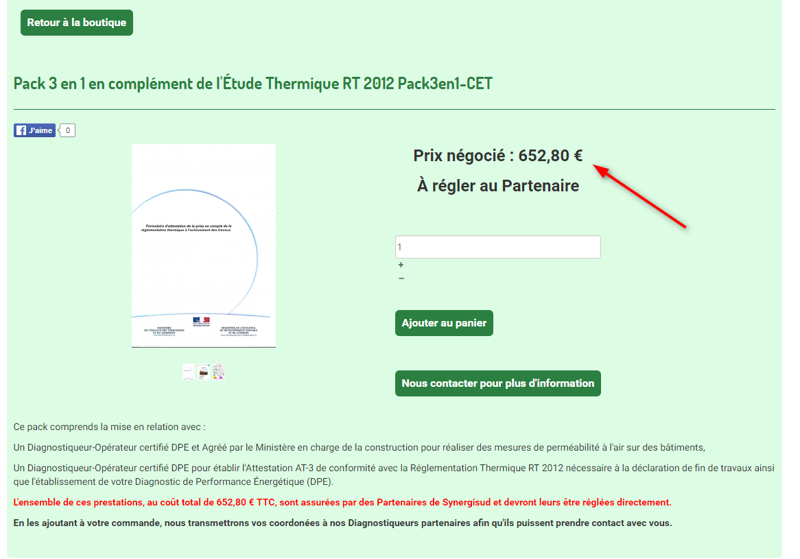

I would like to display it on the product page beneath the shown Retail price (arrow, I have overridden the text)
Beneath the description in the basket (with the text : "À régler au partenaire : " before it
Same on the mails, and invoice.
Thanks in advance for your help and advise,
Best regards,
Stéphane

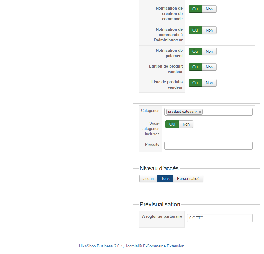

9 years 9 months ago #255464
The field will only appear once you enter something in it in the backend for the product.
If the value is empty, then there is nothing to display and you won't see it on the frontend.

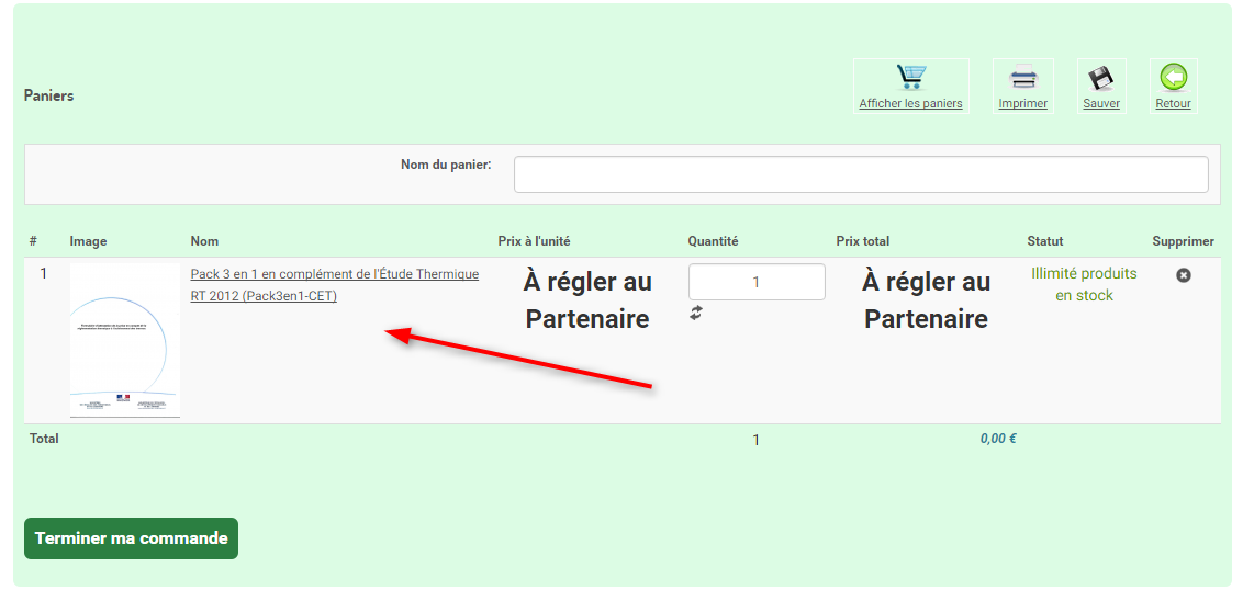

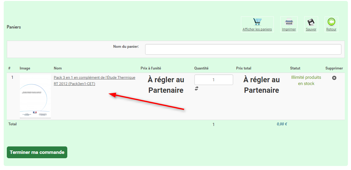

  • Posts: 88
9 years 9 months ago #255537
Ni,
It appears now in the basket and product pages, but when I go through the order process (checkout), this information disappears ...
I should have it on the checkout process, the invoice, the mails etc.
Best regards
Stéphane
  • Posts: 86058
  • Thank you received: 14184
9 years 9 months ago #255558
The custom fields will also display there.
So either you have view overrides of an old version of HikaShop which don't have the display of the product custom fields, or you have an old build of the 2.6.4 with a bug.
So you can try download the install package on our website and install it on yours in order to get all the latest patches.
And you can try switching to the default template of Joomla, and remove the customizations of the emails and see if that helps, which would indicate old view overrides.
9 years 9 months ago #255667
1. Thank you for your feedback on the invoice. I've added a fix on our end for that.
2. That's normal that you don't see the custom product field on the cart of the checkout as there is no display option for that.
To add it to the cart on the checkout, you would have to add custom code in the file "cart" of the view "checkout" via the menu Display>Views.
