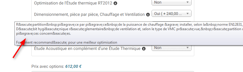

I have a little problem on the product page with options. When I hover the little i for information, the French characters with accent are not displayed correctly.
How can I correct this ?

Change the line:
$description = $this->escape(strip_tags(JHTML::_('content.prepare',$optionInfo->product_description)));
to:
$description = $this->escape(html_entity_decode(strip_tags(JHTML::_('content.prepare',$optionInfo->product_description)), ENT_NOQUOTES | ENT_HTML401, 'UTF-8'));
in the file "option" of the view "product" via the menu Display>Views and that should do it.

Thank you so much Nicolas !
This is solved !
