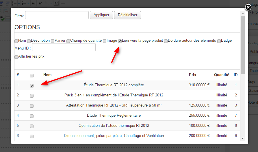

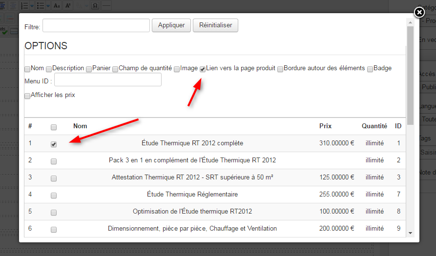

I can't get the link when selecting it in the article creation of Joomla backend button "product"

9 years 9 months ago #255305
Hello Stéphane,
The solution will be to at least check the "Name" and "Link" checkbox through the "product" popup you showed us on your screenshot.
The final tag to add to your Joomla article will look like this :
{product 2|name|link}
We can't add a tag if you only check the "link" option because there won't be any text to add in that link, so the solution will just be to check both "Name" and "Link" checkbox.
Best regards,
Mohamed Thelji.
