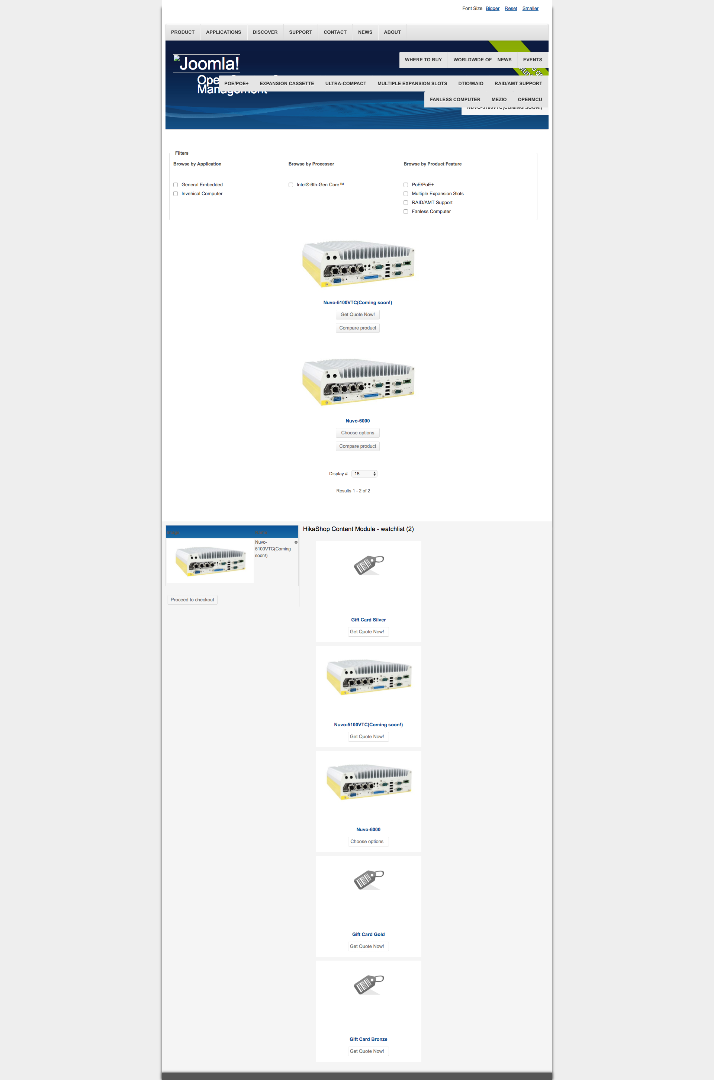

DEMO site: neousys.tellustek.com/index.php?option=c...g&Itemid=201&lang=en
The link is a hikashop product listing page.it's a one of categories in this site.
Watchlist and cart module is working in the sidebar. (watchlist is a content module)
But when i click product link to product detail page. Watchlist and cart module did't work.
Two modules are assignment "on all pages"

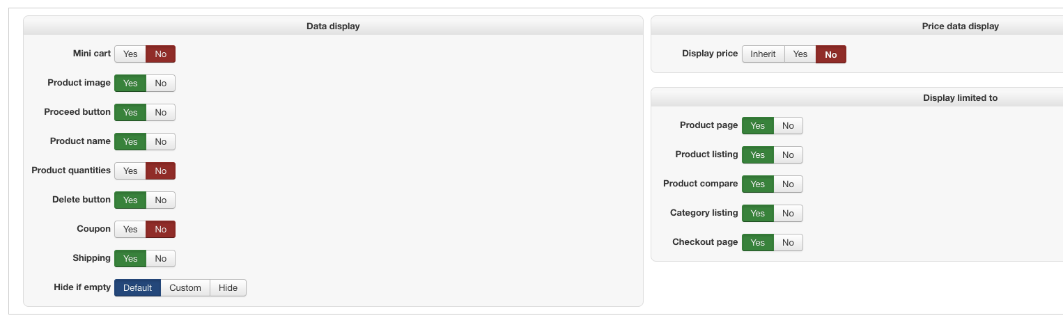

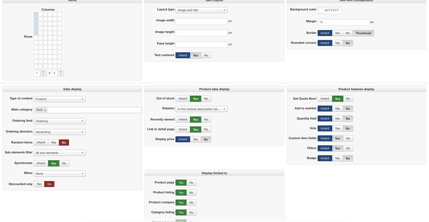

Can u help me?

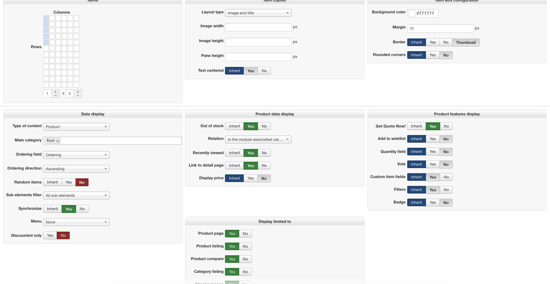

Attachments is module options

9 years 8 months ago #255745
In the settings of your modules, you'll find a "product page" display setting which allows you to say if you want the module to display or not on the product pages of your website. So please make sure that this setting is turned on for these modules.
  • Posts: 9
9 years 8 months ago #255813
it's turned on for two modules. but they did't work.

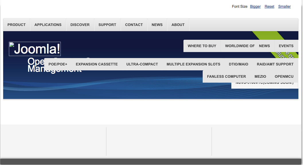

  • Posts: 9
9 years 8 months ago #256036
hi,
When i switch to the default template(like Beez3 & protostar),
The modules still does not display properly.
Even the product detail page can't display properly.
I had checked source code by chrome dev tools.
There are not any html codes generated by hikashop at the positions.
Can u help me?

9 years 8 months ago #256402
We got the access.
I've checked to display the cart module on the default template of Joomla and the cart module displays fine.
I've then configured the cart module "HikaShop Cart Module test bottom" to display in the bottom1 position of your template and I could also see the content of the cart module at the bottom of the page.
I've left the module disabled so that you can enable it and try for yourself.
As the cart module displays fine on other templates and in another position of your template, I can only conclude that the problem is with the way your template display that position in the left slider that it has.
Thus, we can't help you on that problem and you'll have to contact your template provider to ask them why the module content is not displayed in that position.
  • Posts: 9
9 years 8 months ago #256476
HI
Please check this link.
neousys.tellustek.com/index.php?option=c...n&Itemid=200&lang=en

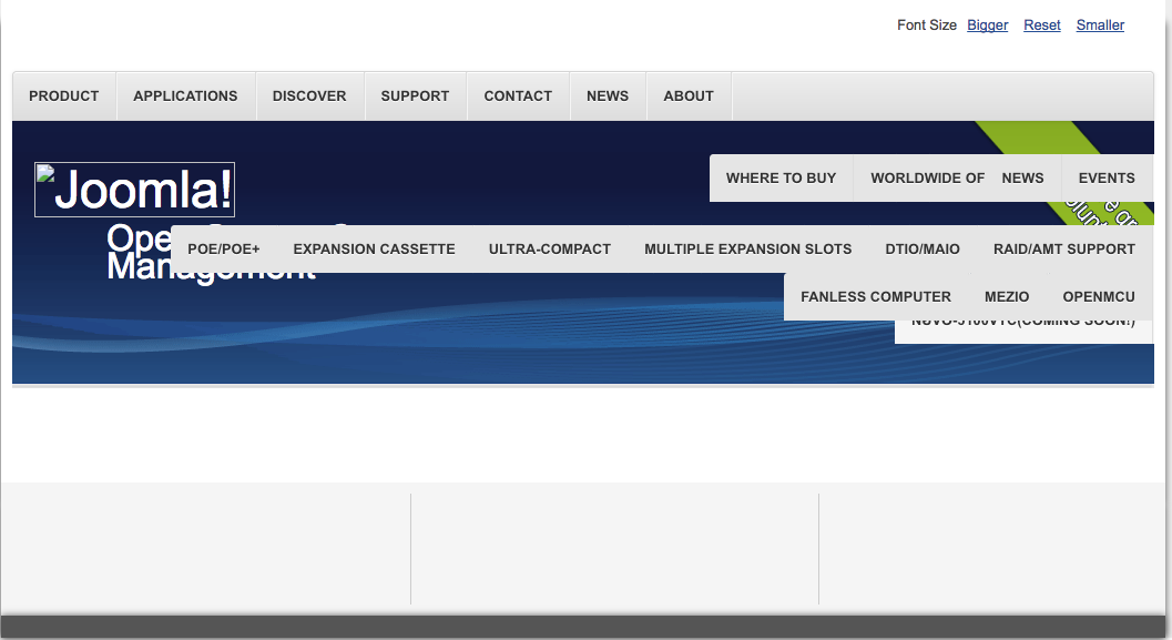

Really fine? Cart Module and Content Module didn't displays in Product Page , not Product Listing Page. Even if in default joomla template !
I try myself and use the module you left, but it's still have a problem.
And in default joomla template. Product data(Nuvo-5100VTC) didn't display. but in other templates, it's display fine.
neousys.tellustek.com/index.php?option=c...=200&lang=en&popup=1
The link displays fine, but it's product listing page. Are u test in this page?
Last edit: 9 years 8 months ago by jerous.
  • Posts: 86058
  • Thank you received: 14184
9 years 8 months ago #256498
I indeed did my tests on the listing page since that was the link you provided and where you had the issue.
And on the listing page, the cart module does display fine in the bottom position and doesn't display in the slider of the template. So it doesn't indicate a problem with the template.
And regarding the product page link you gave, it doesn't even display the product page content itself. That's not normal. The default templates of Joomla are not supposed to not display the content of the product page. So something is messing up the default templates too on the product page which would explain why the cart module does display there. Hard to say what is the source of the issue, but what's stranger is that the product page content does display for your template and not the default ones so it's not like HikaShop is not sending the content of the product page to the template... I don't knwo what you did but a normal Joomla website isn't supposed to do that. It might be linked to system plugins interfering with the display. You could try disabling them one by one.
But that's not linked to the cart module not displaying on the left slider once you had a product in the cart on your listing page.
That's clearly independent from HikaShop.
