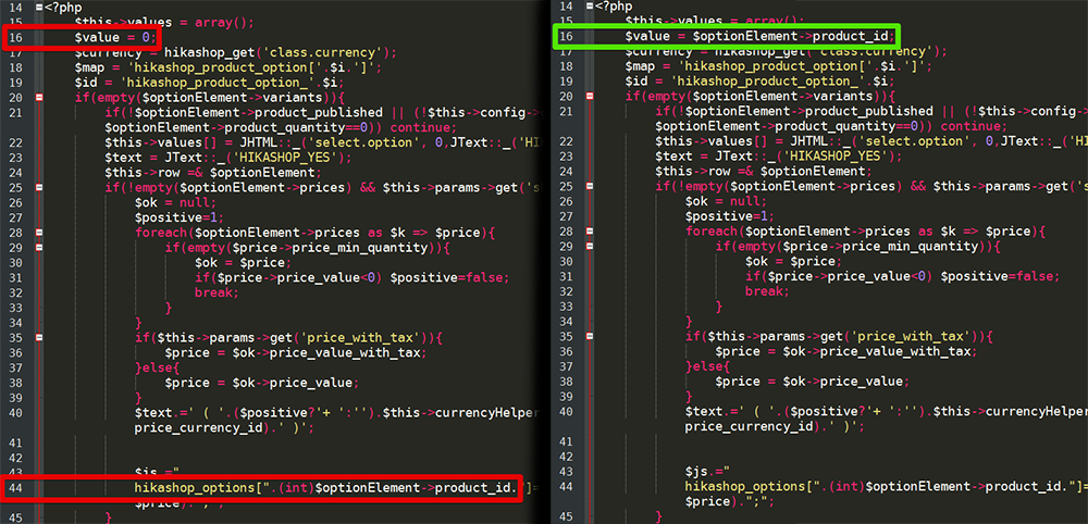

See the code :
originale, find $optionElement->product_id & and put it in the $value (around line 16) :
That must able your product page to have by default the first option selected AND the option price add in "Price with options".
Maybe, some Css add in order to highlights this price with options will be needed.
Hope this will fit your needs

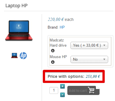

I simply want to DISPLAY the "price with options" on the product page. Right now I can not.
Are you telling me that in order to achieve the Hikashop demo shown in your picture, that you have made changes to the php of the views?

No, the price wih options is automatically displayed on the product page. There is no change necessary to display it. There is actually no option to not display it and you would have to add custom code to remove it.
So this means that either you or your template provider did something to not have it displayed on the product page.
