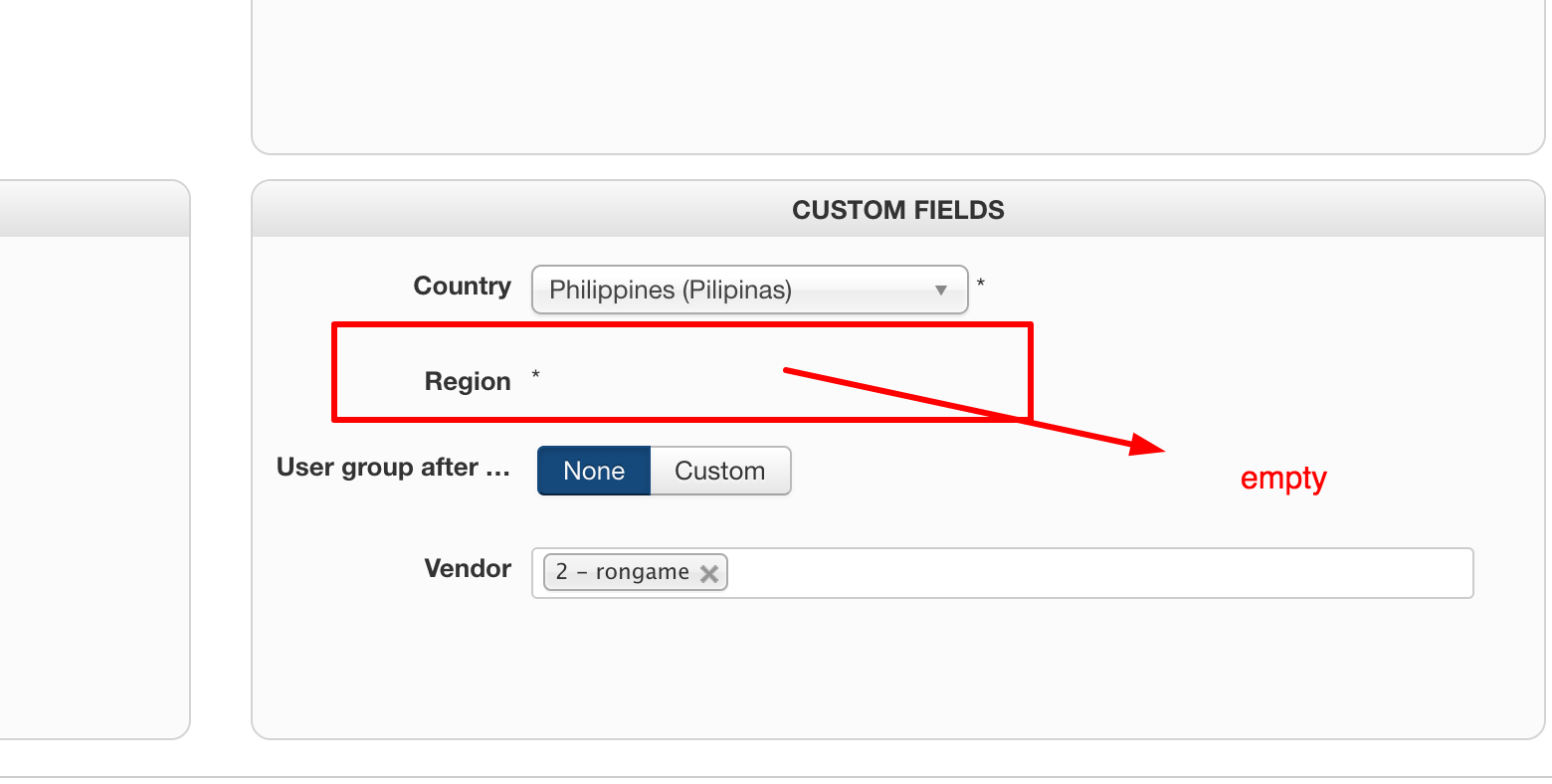

i created a custom field for the products to find out where the products are located
i created custom fields country and region to appear in the the add product form.
the country is ok but the state or in my case region is blank
what to do?

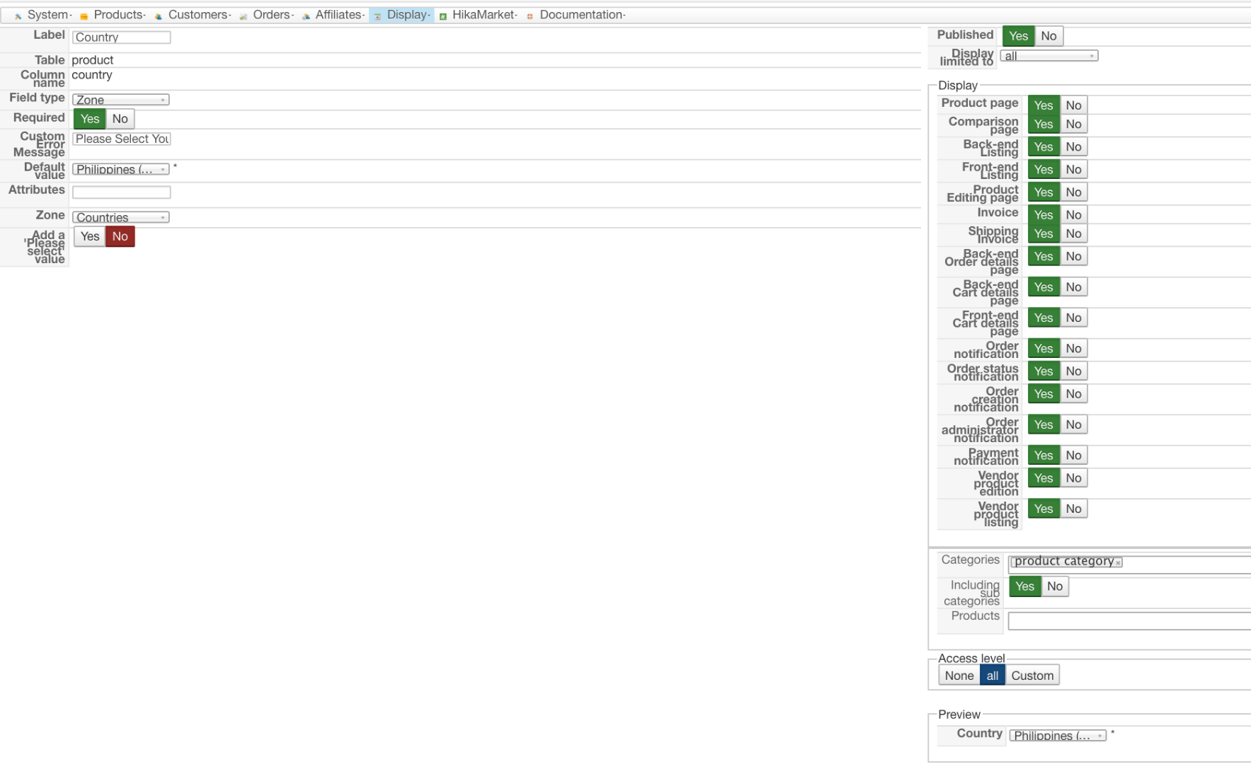

Please provide details about your two zone custom fields.
  • Posts: 490

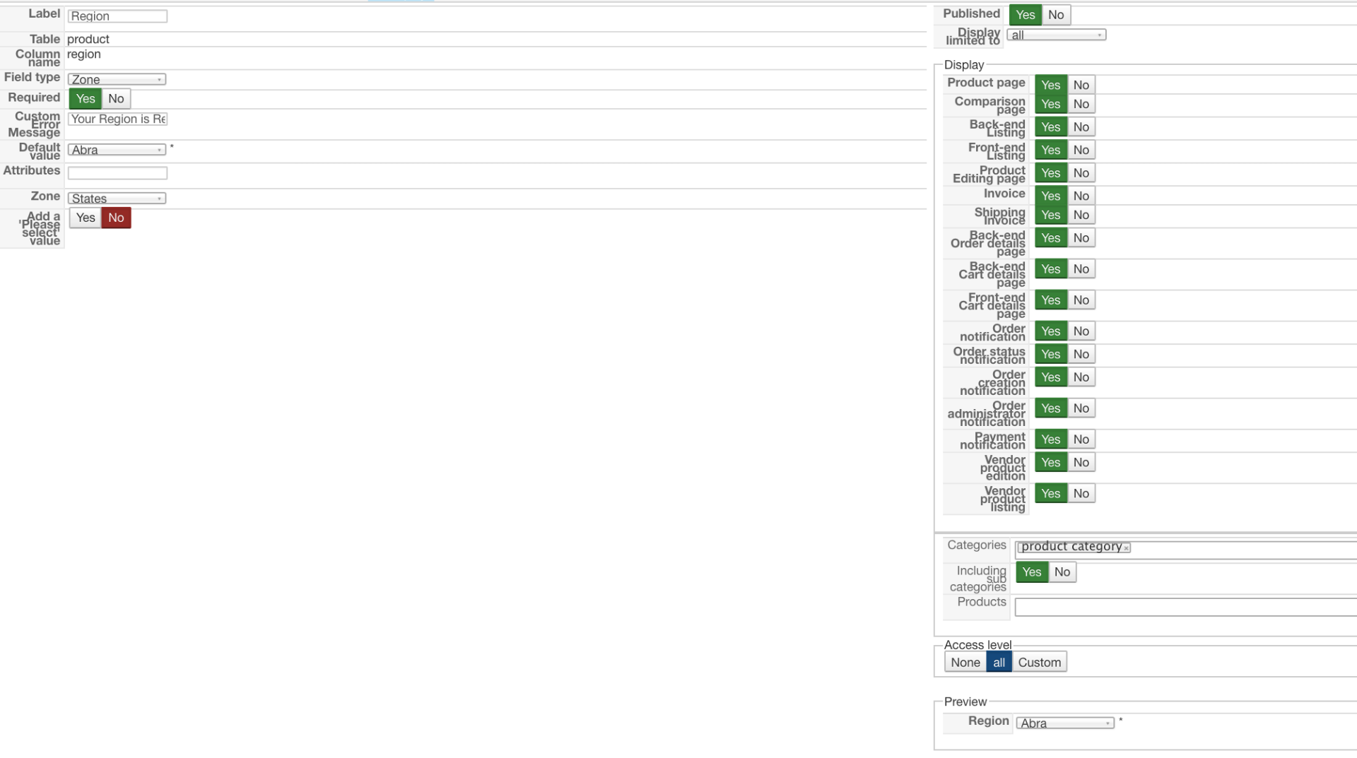

9 years 8 months ago #256899
here it is
custom field region / state
custom field country

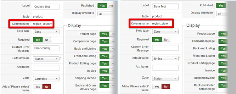

Ok, you have to create a link between your 2 products custom fields, this will be possible in column name, here my configuration that works :
You can see that my 2 columns name use the same prefix ("region_") , in order to link them and able the first choose (country) to allow states displaying.
Hope this will help you.

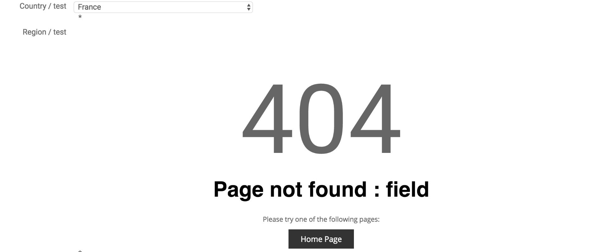

it didnt work for me
i got a 404 error for the state.

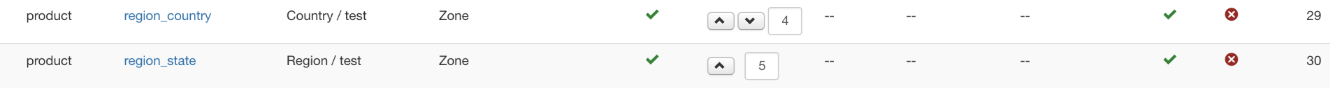

9 years 8 months ago #257205
I Get it ! You can't configure region_states WITHOUT publish region_countries !
You must understand that your first product/zone (region_country) able your region_state to works.
And so, if the first isn't published, the second won't work.
Right now, I switch off back your configuration.

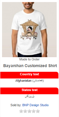

Ok I was able to reach your back-end, I create NEW product/custom field (Country test & States test), see by yourself :
You have just modify their name in order to remove the "test" and maybe delete the previous.

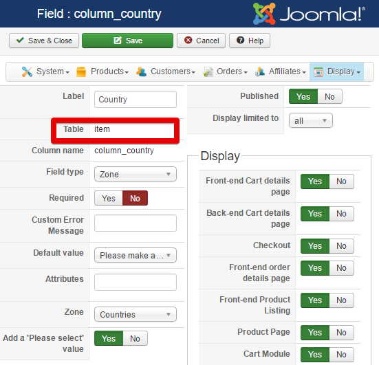

There is a misunderstood, product custom fields are bonus data on your product, the aim isn't to be defined by customer on the frontend, as explain in our custom fields tutorial , here I quote :
"Front end : If set to yes, address and user customer fields will be used during the checkout process to ask more information about the customer. Product custom fields will be displayed as specifications on the product page."
So you have to use in table Item in order to have what you need, see this screenshot, note that for other configuration points everything will be the same :
That's why, you must be more specific when there is a trouble, like this : "What I need"/"What I do"/"What don't work or seems impossible"

The you want custom fields of the table "product".
I've created two in your backend and I'm able to see them on the backend when I edit/create a product.
However, as a vendor on the frontend I don't see the fields. I suppose that it's because I would have to add them to the ACL settings of HikaMarket, but the access you provided didn't allow me to do that. So I can't say more.

9 years 7 months ago #258258
Thanks, I was finally able to see the problem on your website which comes from the fact that HikaMarket uses the URL index.php?option=com_hikashop&ctrl=field&task=state&tmpl=component&lang=en&field_type=product&field_id=data_product_product_state&field_namekey=product_state&namekey=country_Philippines_168 to refresh the state custom field while that URL is invalid.
It should be instead index.php?option=com_hikashop&ctrl=checkout&task=state&tmpl=component&lang=en&field_type=product&field_id=data_product_product_state&field_namekey=product_state&namekey=country_Philippines_168
This can be fixed by changing the line:
$fields = $fieldsClass->getFields('display:vendor_product_edit=1', $product, 'product', 'field&task=state');
to:
$fields = $fieldsClass->getFields('display:vendor_product_edit=1', $product, 'product', 'checkout&task=state');
in the file components/com_hikamarket/productmarket/view.html.php so please try that modification.
