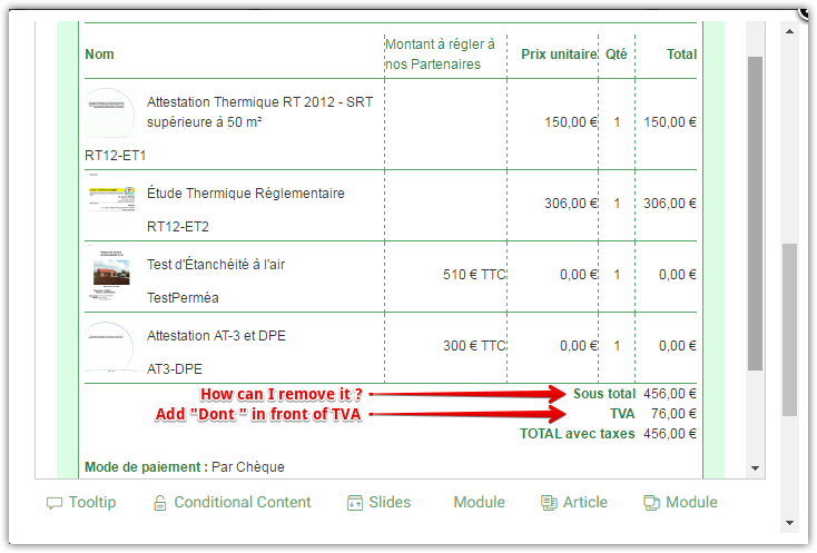

-- url of the page with the problem -- : synrgi.latelier-des-spheres.fr/

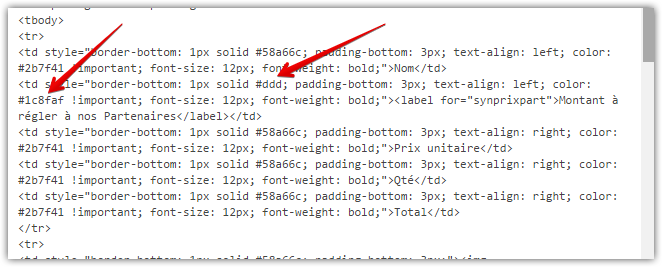

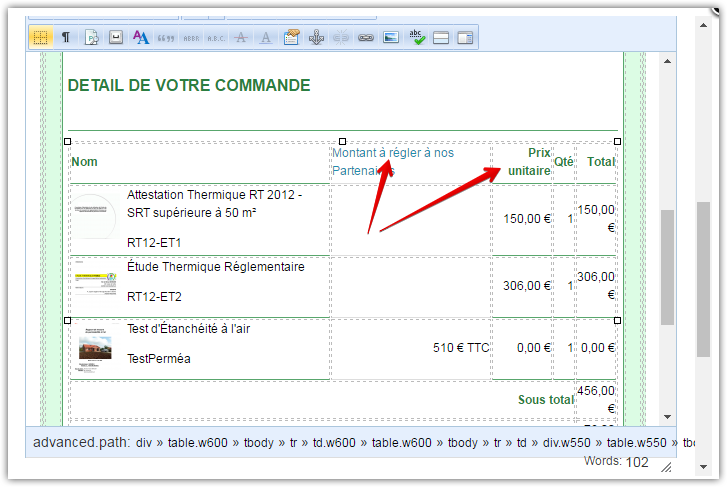

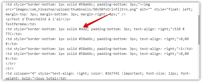

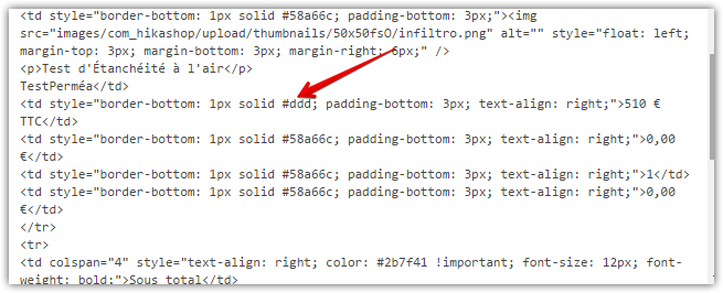

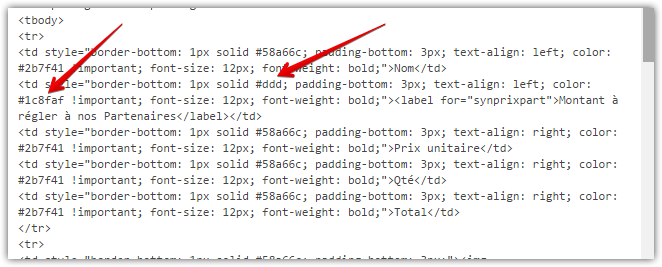

I am in modifying how the Email are displayed and their CSS
I've setup all the CSS inside the Order Admin Notification but the custom fields are not affected by my modifications.
I've never found how to customize those fields... is it because they do not have a HTML code here :
Should I add the HTML ?
How can I also adjust the width of that custom field column ?
Thanks in advance for your help and advise,
Best regards
Stéphane

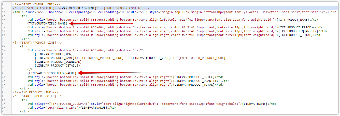

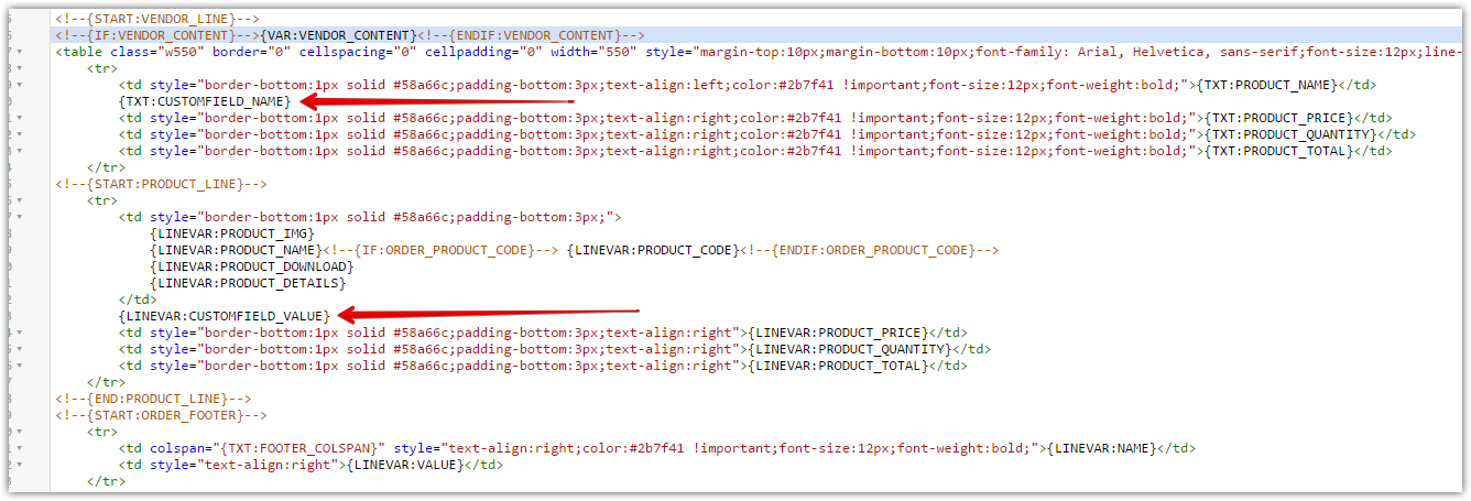

I found that this column is generated in the "preload" part of the Email... But the title does not appear in bold even if set with !important...

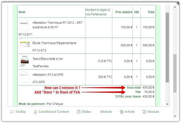

Other point : how could I remove the "sous-total" and add "Dont " in front of TVA
Best regards
Stéphane

1. I don't see why the bold would work differently in the custom field td. I can only think that there is an error in the CSS you put which makes it invalid. So I would recommend to double check it.
2. To remove the sub total row, you can remove that code in the preload:
$cartFooters[] = array(
			'NAME' => JText::_('SUBTOTAL'),
			'VALUE' => $currencyHelper->format($subtotal,$data->cart->order_currency_id)
3. The TVA part either comes from the name of your tax rate that you configured via the "Manage tax rates" of the menu System>Taxes, or from a translation key (based on whether the "display detailed taxes" setting is turned on or off in your HikaShop configuration.
So if it's a translation, you can override it: www.hikashop.com/download/languages.html#modify
And if it's the tax rate name, you can create a new tax rate with the name you want, select it in your tax rules instead of the one you have now and you'll be done.
  • Posts: 88
9 years 8 months ago #257329
Thanks you so much for your help Nicolas !
For point 1, the screenshot comes from the preview popup in the order edition front end panel. The emails sent have it in bold... I had already double-checked before posting, strange... but not blocking.
Point 2 : i will do so Thanks for the code.
Point 3 : I will investigate, but anyway, you gave me manageable possibilities, should be donne easelly.
Again thanks for help,
Best regards
Stéphane
