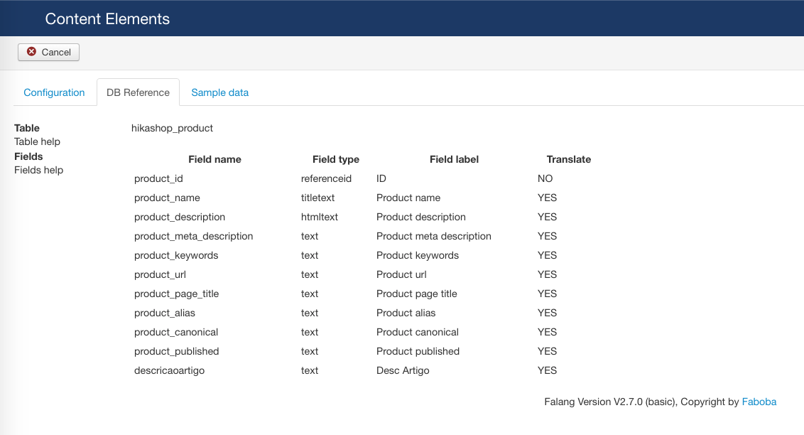

We added the configuration necessary to Falang on contetelent/hikashop_product.xml (<field type="text" name="customfield" length="255" maxlength="255" translate="1">Custom Field Desc</field>) and on Hikashop XML files as well.
And the translations work well, both on the administration page (Falang Component) and in our process too.
