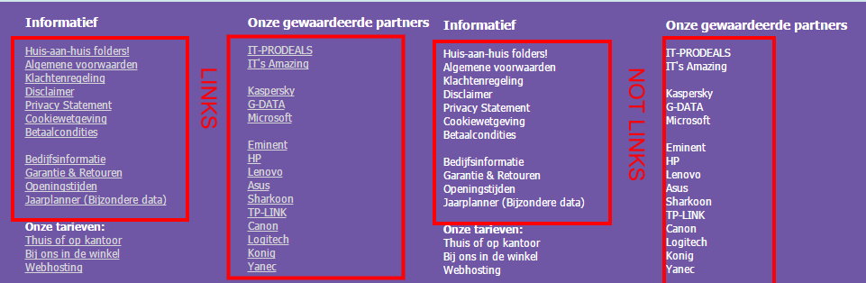

  • Posts: 154
  • Thank you received: 10
9 years 6 months ago #260183
Hi Jerome,
Did you read mine?
The WORDS are there, but they arent LINKS anymore.
Go to my site:
www.hetcomputerwinkeltje.nl
The words in the footer are LINKS to certain websites or pages on my site.
Go to my site, a page from hikashop, and the words in the footer are NOT LINKS anymore.
See attached screenshot. Left side is on any page on the site, right side is on hikashop pages.
Dont really know how much better I can explain this...

  • Posts: 86058
  • Thank you received: 14182
9 years 6 months ago #260198
There is no reason that HikaShop would remove the a tags on your footer.
HikaShop has no such function.
And from what I can see, it's not just the a tags:
monosnap.com/file/pgdjXj4oMYeFRv0febsonwe5zOLiwH
The any-nostyle div is also not there, the HTML comments around each column are not there either, the custom div is not there either.
How could HikaShop remove all that ?
What I think is that it's another module which displays on your footer on the product page link you gave than elsewhere. And that you have one module configured to display on HikaShop pages and the other one configured to display on the other pages.
