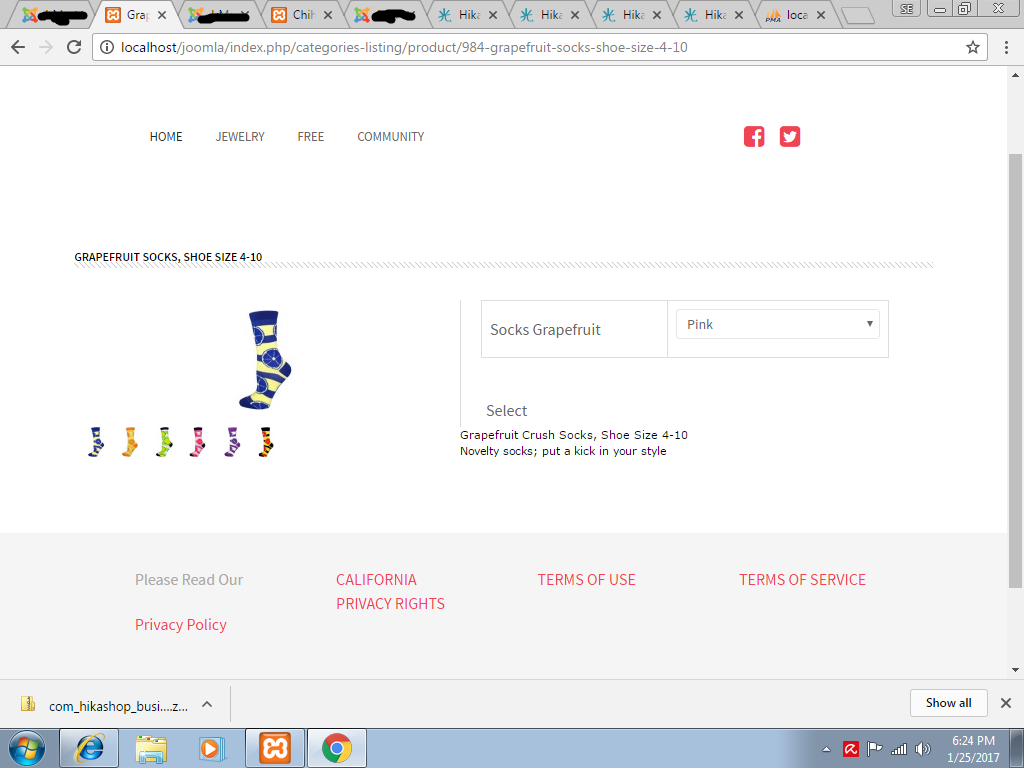

I configured this exactly the same way as another functioning product page on another site. The product picture is not changing on my product variants. i have individual pictures for each variant. i tried to use .csv file to move products. it did not work, so i added the products from scratch. did i create unnecessary tables that would cause this problem. could i use table exclude on akeeba backup to fix this? Any ideas

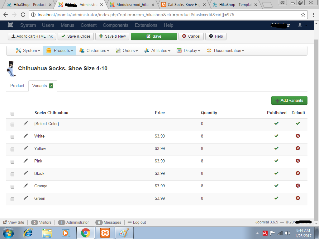

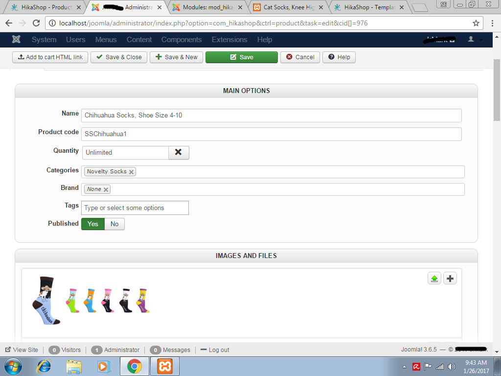

9 years 6 months ago #260432
Did you add one image for each variant ? And not all the images to the main product ?

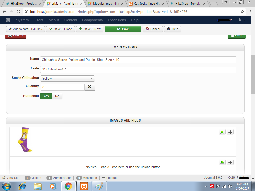

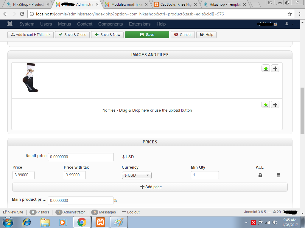

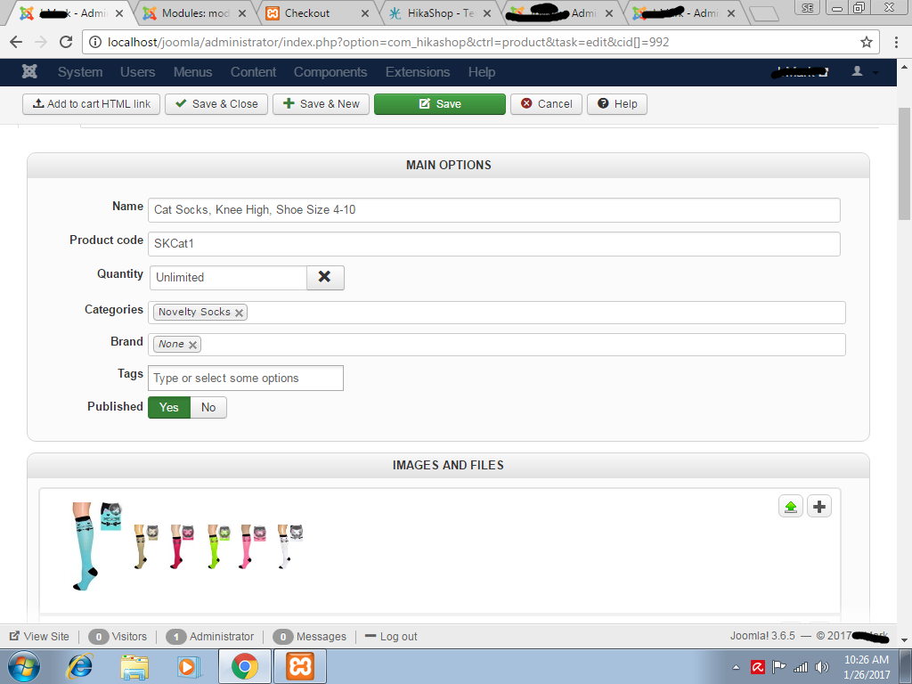

Could you provide a full screenshot of the settings of the product and of one or two variants ?
Try with the default template of Joomla. If you don't have the problem with it, it's likely related to a template override.

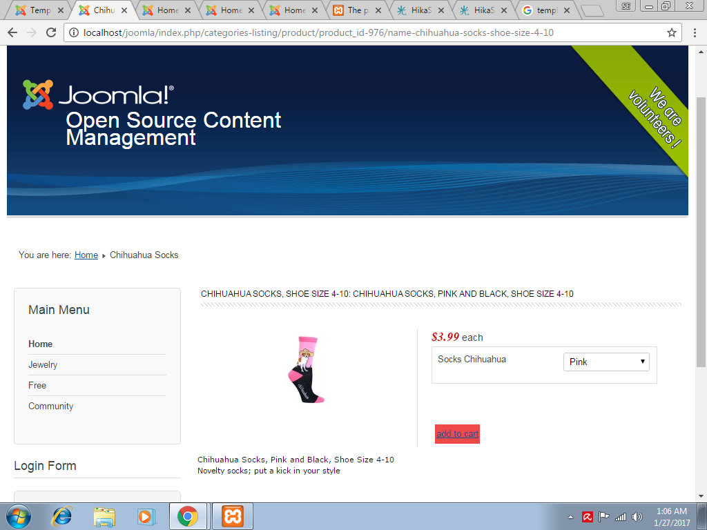

  • Posts: 52
9 years 6 months ago #260479
i did add 1 picture per variant
i have all the pictures in the main product for display only. it usually changes when selecting color to a single picture
im not comfortable with trying the default template for a test
I have it configured identically on another website and it works fine
Its likely a template override because i have had it work perfectly configured exactly the same elsewhere.

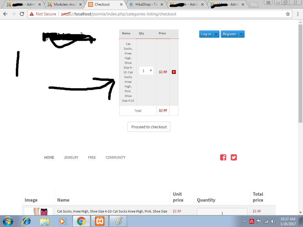

  • Posts: 52
9 years 6 months ago #260484

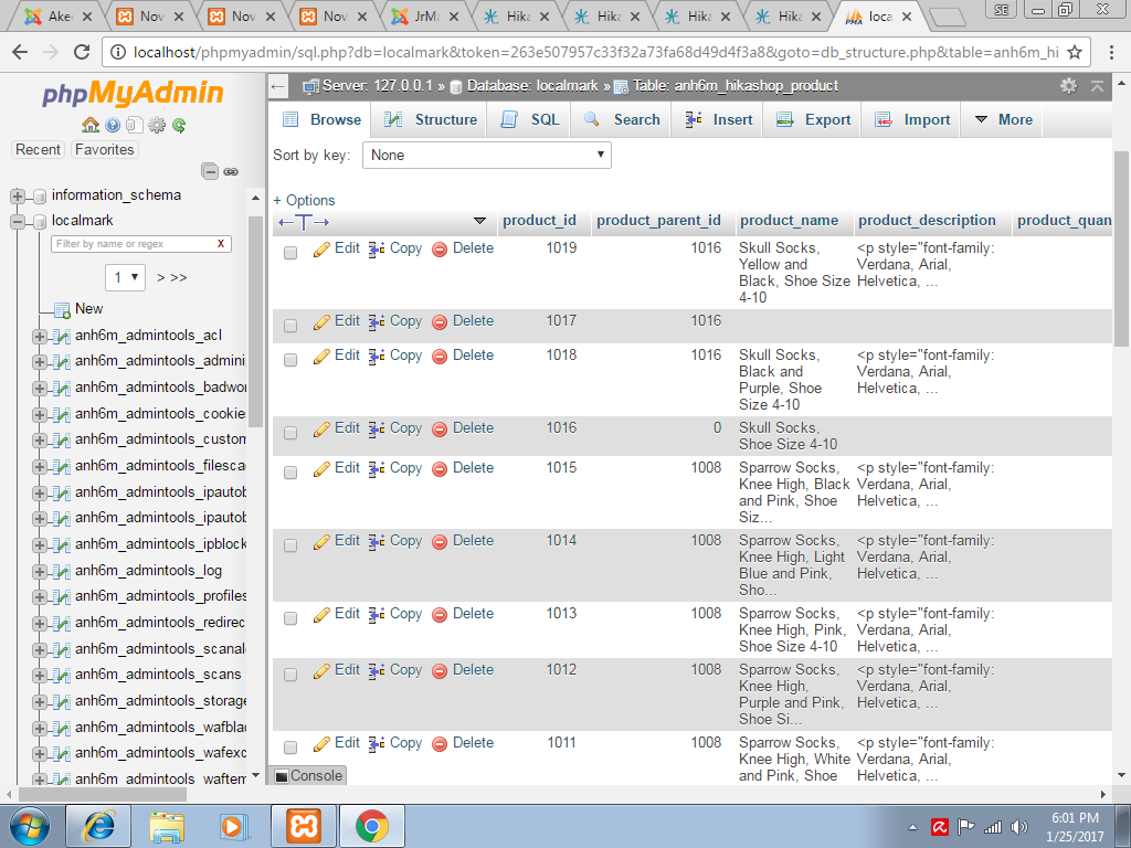

Im getting a duplicate when i add product to cart
I feel as if when i tried to import products form .csv file it created some sort of duplicate

Your settings look fine.
Without being able to look at the page, I can say much.
But I suppose it's linked to the template view overrides.
Switching the template temporarily would allow you to test if that's the case or not.
  • Posts: 52
9 years 6 months ago #260540
I tested it using Beez3 templete, it works fine now.
i how should i do the template override?
kind regards

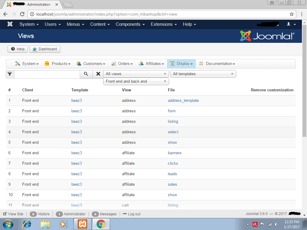

  • Posts: 52
9 years 6 months ago #260618
i tried all of them
where my mouse is with the little trash can
There were none that had the trash can
Kind regards
  • Posts: 26381
9 years 6 months ago #260620
Your screenshot is showing view for the "beeze3" template ; which is a template you just told is working fine.
So you need to use the dropdown filters to only display the front-end elements, for the "product" view and for your front-end template which have the problems.
One other possibility is that your template have some errors (javascript errors) which stop the processing of the HikaShop javascript.
But in that case, I'm afraid that you will have to see with your template provider to fix the issues.
