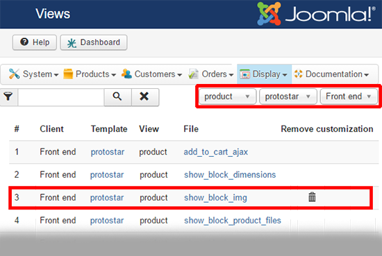

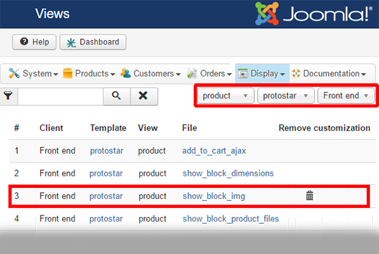

I think about an override issue, can you go to check this:
- In Components => HikaShop=> Configuration
- On Display dropdown select Views
- Use the three dropdown filter to find your "show_block_img" view
- If you have a little trash icon, save your code on your side, then click on the little icon to delete your custom code.
If that solve your issue, your override view is the root issue.
Awaiting news from you.
