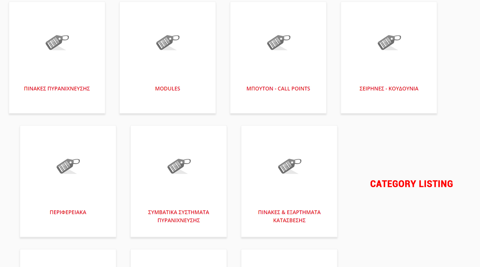

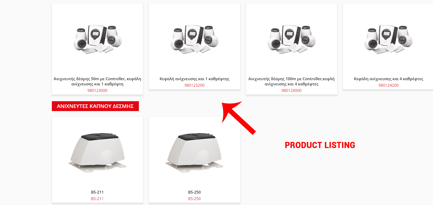

I have a category listing menu item and for some reason the boxes look like in the attached image. They are not displayed even, also the products box do not have the same height. I'm not sure what is wrong here. Could you please take a look?

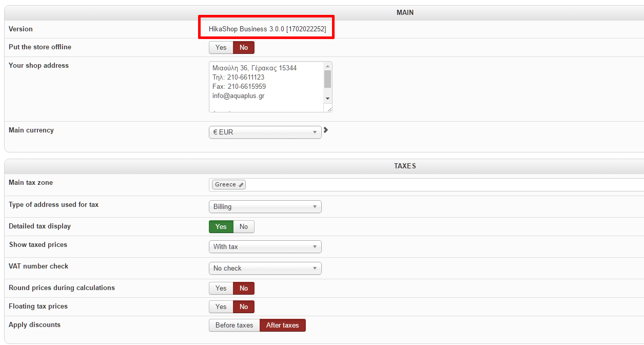

9 years 6 months ago #261145

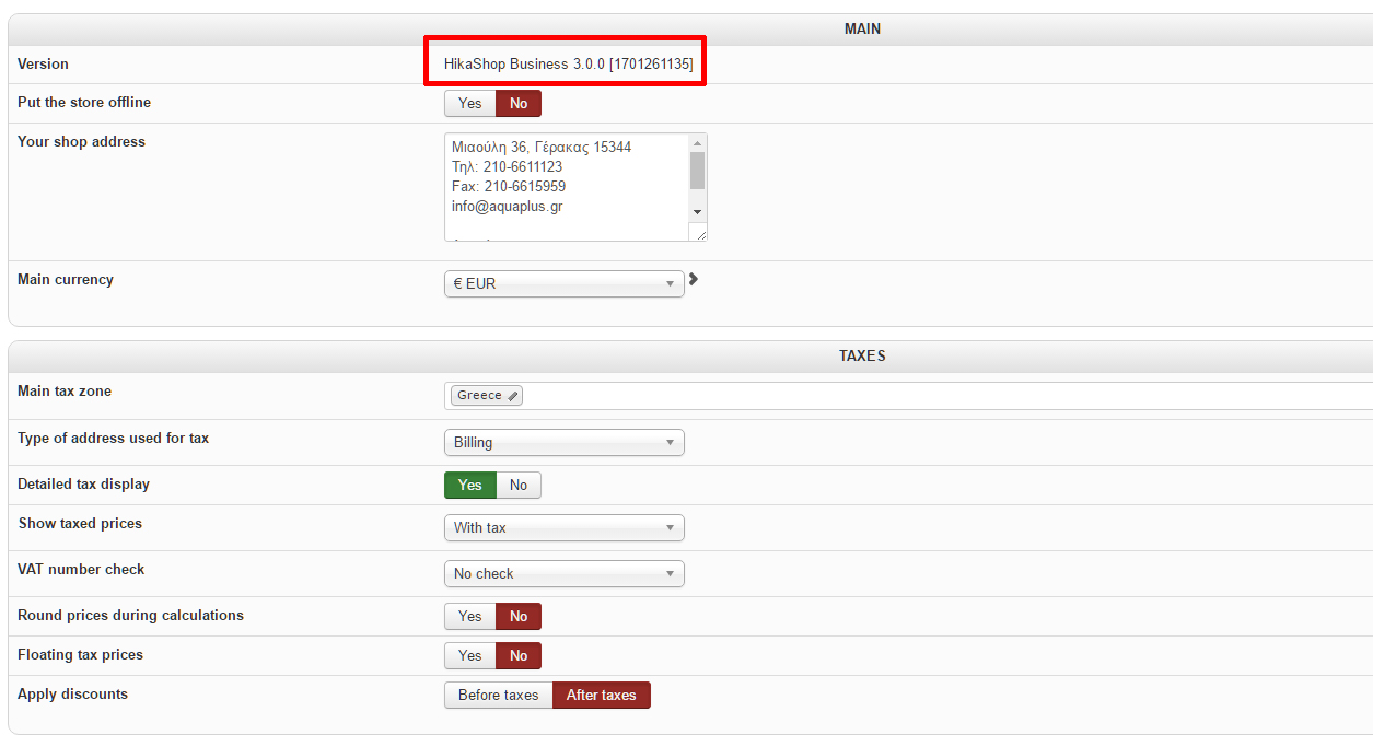

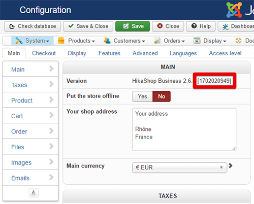

Check that you have this build (see screenshot) if you have a different build download the lastest build and install it, that may solve your display issue.
We have correct this issue as an answer to this topic.
Awaiting news from you.

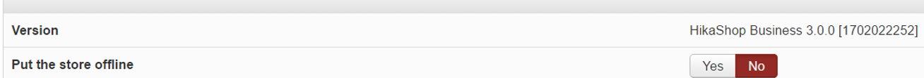

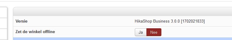

9 years 6 months ago #261251
i checked and i have this build now
i updated hikashop and now i have this build
Problem still remains, am i doing something wrong?
Thank you

  • Posts: 11
9 years 6 months ago #261290
it works for me now. Thank you!
Last edit: 9 years 6 months ago by henk de kip.
  • Posts: 4
9 years 6 months ago #261292
How did you get it right?
  • Posts: 11
9 years 6 months ago #261294
I updated Hikashop to this version

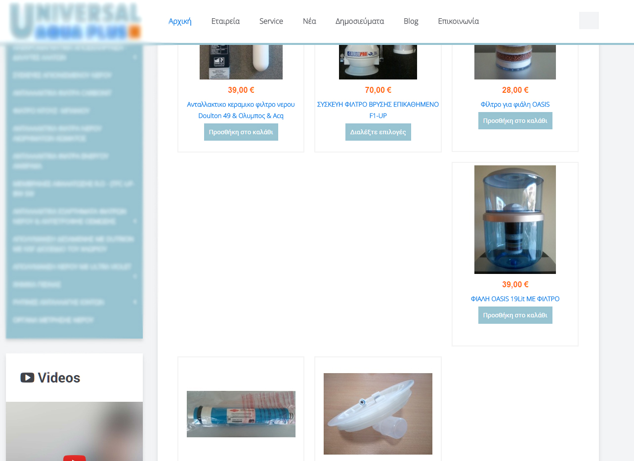

Hi nicolas,
i'm sending you link to another site with the new version of hikashop to check the issue.
This is the result after today's hikashop's update
Thank you

  • Posts: 26381
9 years 6 months ago #261299
HikaShop have a "height consistency" script which allow to put the same height to every elements of a listing.
If that script is not called (due to some JS error in your website) or you have some loading "issues" (so the script is called but some images are not displayed yet), it can cause such kind of display problem.

I've checked on your new link aquaplu but there is no categories listing on the main area on the link you provided, and even if I go on a category listing like this one:
monosnap.com/file/MyKmse80jes4gcbDxwKWFg7FCkmj0S
As you can see there, the categories listing itself displays fine.
Your problem seems to be with the products listing and thus, the fix we added for the categories listing doesn't have any influence on the problem, and whatever the build, it's normal that it doesn't change anything for you.
For your products listing, as Jerome said, it seems that the consitency height javascript doesn't work on your website. While no error appear, I suppose that if you switch to protostar, it should work properly.
So I would recommend to simply force the height in CSS by adding such CSS:
.hkc-md-4 {
height: 350px;
Time to create page: 1.441 seconds
