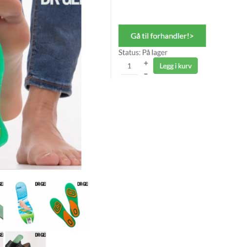

OK this is what my product page on my test-site looks like now.
When I paste a URL in the in the product "brand url" field the button "Gå til forhandler/Go to dealer" links to this url.
But now both button displays. I need the standard "add to cart" button to be HIDDEN when the product "brand url" is filled out
So that only the new button "go to dealer" displays.
NOTE: I know that I can use code to remove the standard "add to cart" button, but I have some products that I sell myself so I need it to display on these products.
Any advice on how two write code like that ?
tnx
How my explenation makes more sense.
tnx

9 years 9 months ago #261260
by nicolas
Replied by nicolas on topic Hide "add to cart button" when brand-url is filled out
I suppose you could add such code at the top of the "quantity" view file:
Code:
<?php if(!empty($this->element->product_url)) return; ?>

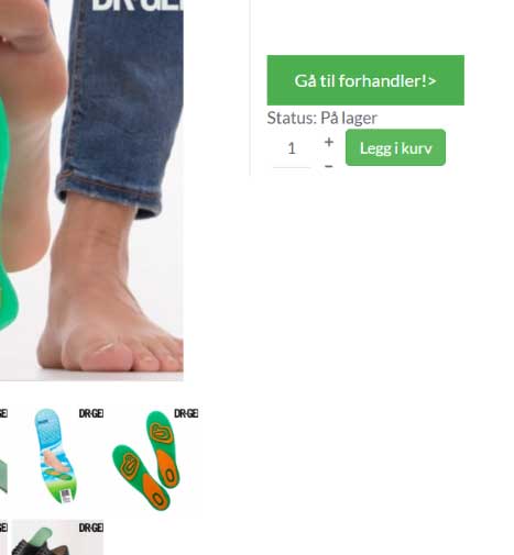

9 years 9 months ago - 9 years 9 months ago #261317
by river
Replied by river on topic Hide "add to cart button" when brand-url is filled out
OK tnx for reply
This works ! Excellent.
Now the begining of my product | quantity file look like this
Is it possible to add another small function to this code.
Now both buttons are displaying when the "Brand url" is NOT filled out.
Is if possible to add code so that ONLY the "add to cart" but is displaying when the "Brand url" if NOT filled out ?
Code:
<input type="button" onclick="window.location='<?php echo $this->row->product_url; ?>'; return false;" value="Gå til forhandler!>"/><br/>
<?php
* @package HikaShop for Joomla!
* @version 3.0.0
* @author hikashop.com
* @copyright (C) 2010-2017 HIKARI SOFTWARE. All rights reserved.
* @license GNU/GPLv3 http://www.gnu.org/licenses/gpl-3.0.html
Last edit: 9 years 9 months ago by river.
