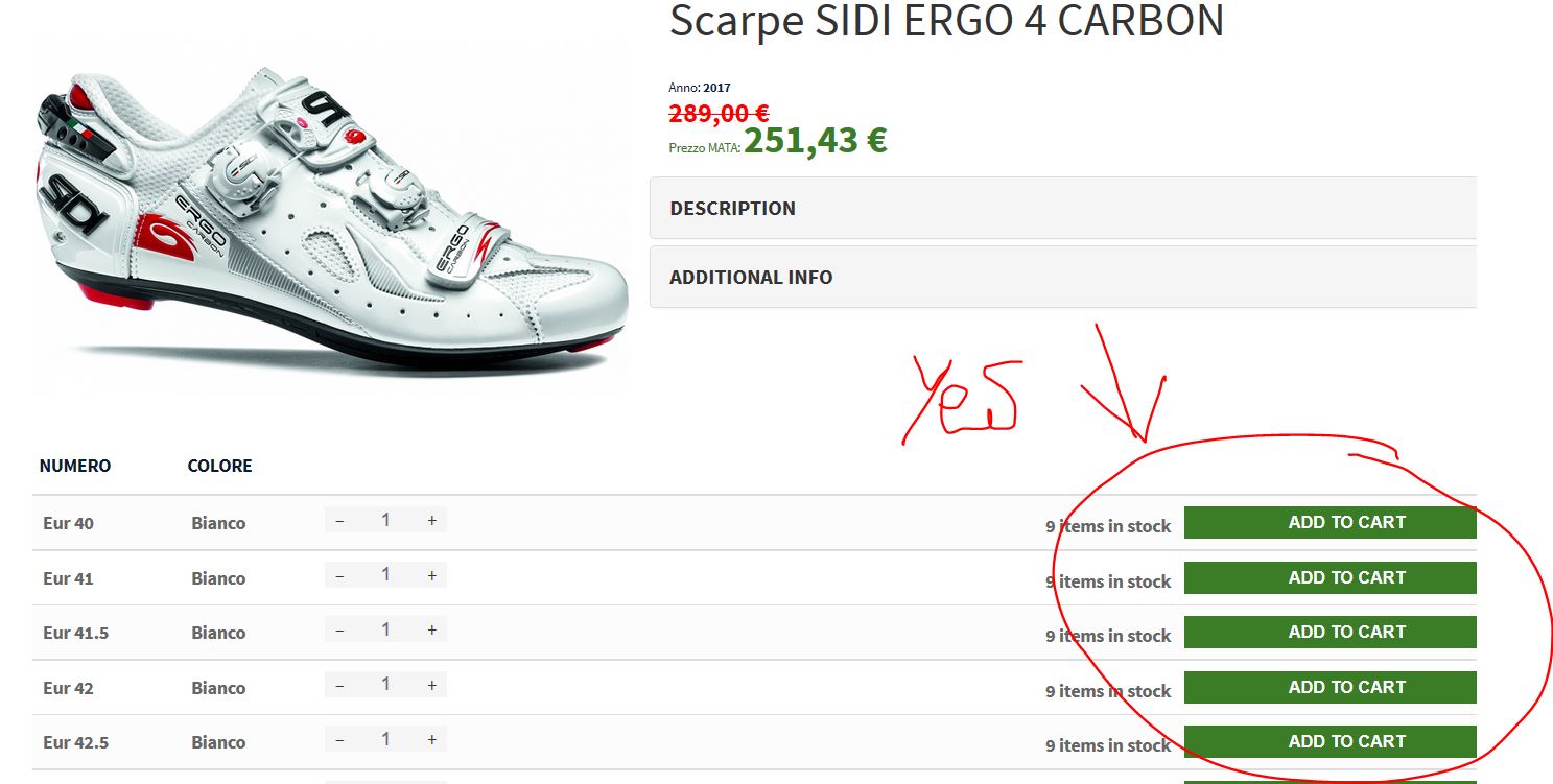

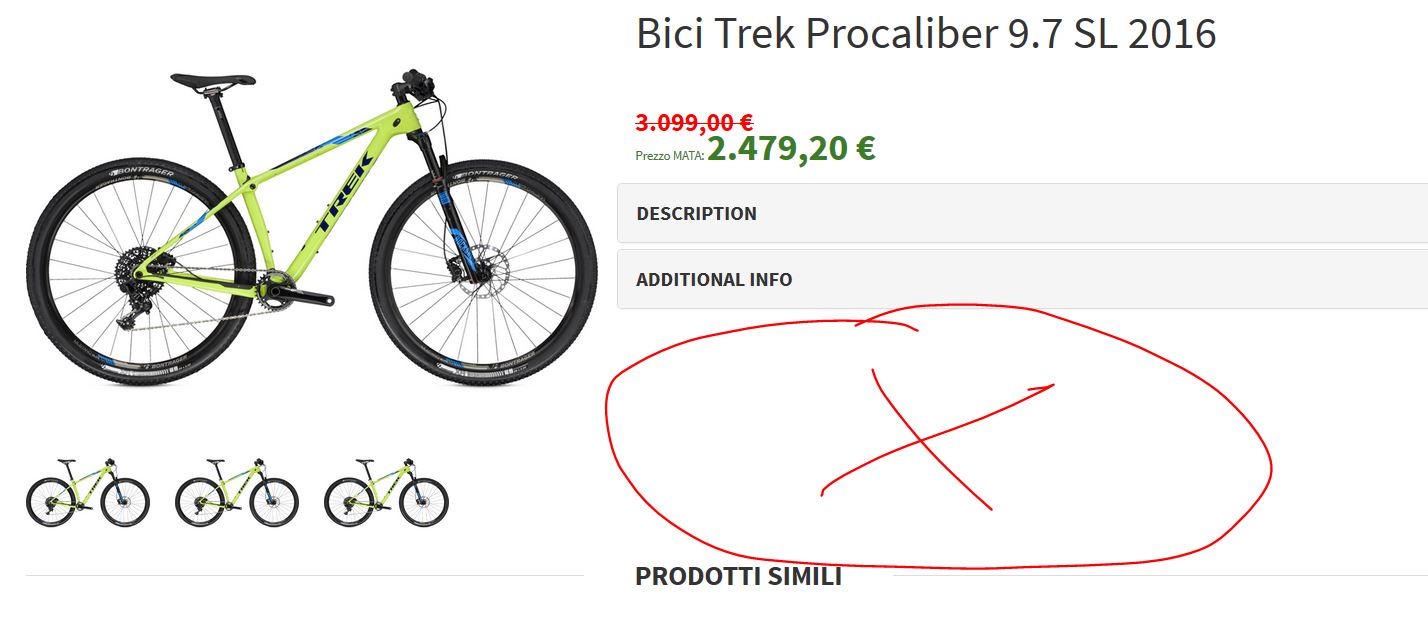

I have products with characteristics; I set LIST for characteristic
selection method BUT if a product hasn't got characteristic, the buy button doesn't appear.
Thanks for your support.

I introduced some personalization, but only on the CSS... I hope ...
well, I attach 2 links, for permit you to analize the page:
- No error:
www.matabikeshop.com/index.php?option=co...es-orange&Itemid=503
- Error:
www.matabikeshop.com/index.php?option=co...7-sl-2016&Itemid=136
Thanks.
