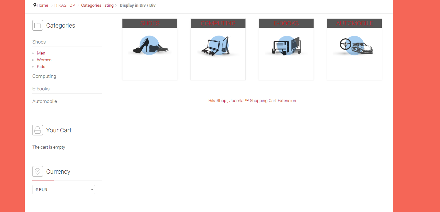

The owner wants us to make the website looks like the following please see attachments on order, thanks.
In screenshot this the website under all caetogries , please click the website link, that was provided private, then take a look at the screenshoot2 which is from your demo,
the website Owner want the another module on the left side has the categories and the categories on the right of it, like your demo on screenshoot 2
your help appreciated, thanks

9 years 6 months ago #262651
You can enable the "Categories on 2 levels" module via the Joomla modules manager. It should be preinstalled with HikaShop when you install HikaShop on your website.
It is already preconfigured to display like that but you can also recreate it as a new HikaShop content module configured like the module on our demo website:
monosnap.com/file/BjEQDqYesPBuUSBK7wwNeIHh9B9fyb

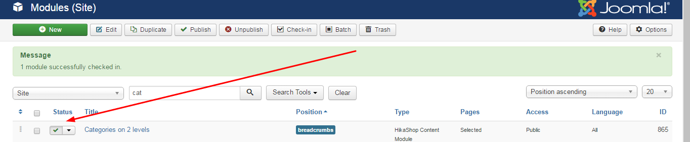

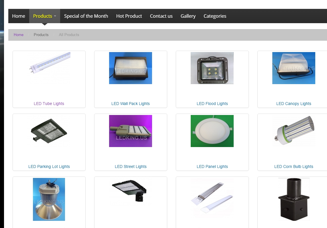

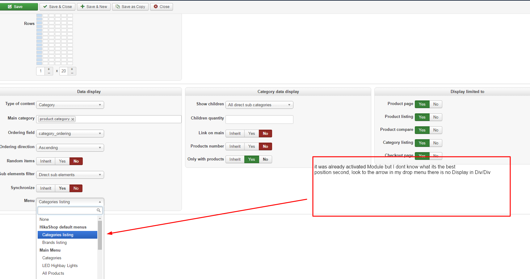

Hello Nick < I found the module, and was already activated , I'm trying to put this module under all product drop menu from Products, which is mean when you go to the home page then you go products there is a drop menu, then if you click on the first option which is All products, when want to see Div / Div
second as you are going to see in the screen shoot below , I did not see under menu and Display Div/ DIv
please screenshot, thanks

9 years 6 months ago #262700
That's not this opiton you need to look at.
You need to look at the menu assignment tab of the module. That's where you define on which menu items a module can be displayed or not.

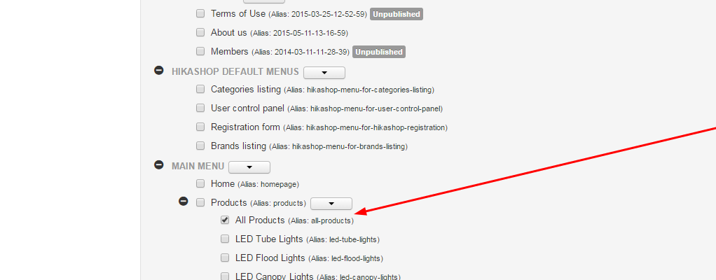

9 years 6 months ago #262819
Hello Nick and Jeremy,
thanks for all help and support, but either im not able to explain my concern or im not understanding your instructions,

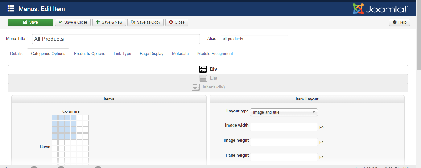

I took more screenshots might clear this up for both,

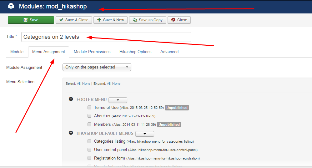

this screenshot above where you ask me to start which is what i did , I went to module, then i activate it then I went to menu assignment and i choose all products as the next screen shot down please see
im not sure what else i have to do in this area, also i have this screenshot from the menu item
take a look and let me know if i have to work in this area or i have to go back to the module,
Again im not arguing , I'm not following your instructions so far could you please be more detailed if possible, thanks

  • Posts: 86058
  • Thank you received: 14182

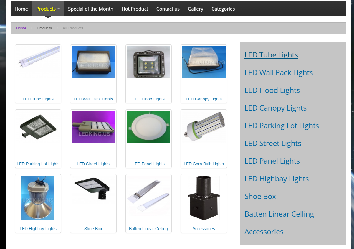

9 years 6 months ago #262932
I do see the module displayed on the page:
monosnap.com/file/C12He3cT8XeF02bMxchFg5Vg8ATtwp
But if you want it on the side and not at the top like that, you should use the sidebar position of your template for your module's position setting and not the top position like you have now.
  • Posts: 154
9 years 6 months ago #262940
Now we are getting somewhere,
please take a look to the screenshoot, its on the right, how i move this to the left,
thanks
