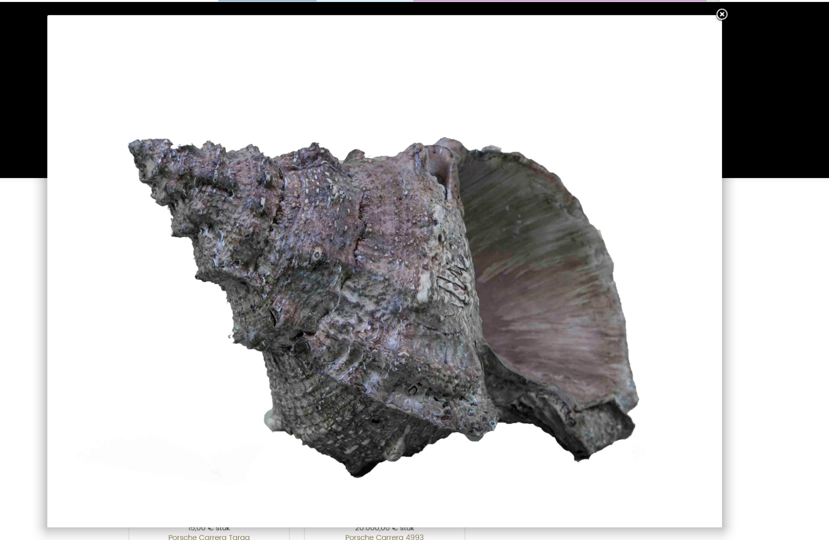

I make a webshop for a customer with the template J51_Chelsea - Example Style 2
I use Hikashop when i click on an image on the desktop version is it a large picture.
When i open the site in mobile mode or on a GSM the picture is too large and the proportion is not correct.
Is that a problem from Hikashop or the Template and how can i solved that.
This is the direct link to an image Large picture

9 years 5 months ago #264591
It comes from the CSS of the popup system of Joomla. Add such CSS to prevent that:
#sbox-content { height: auto !important; }

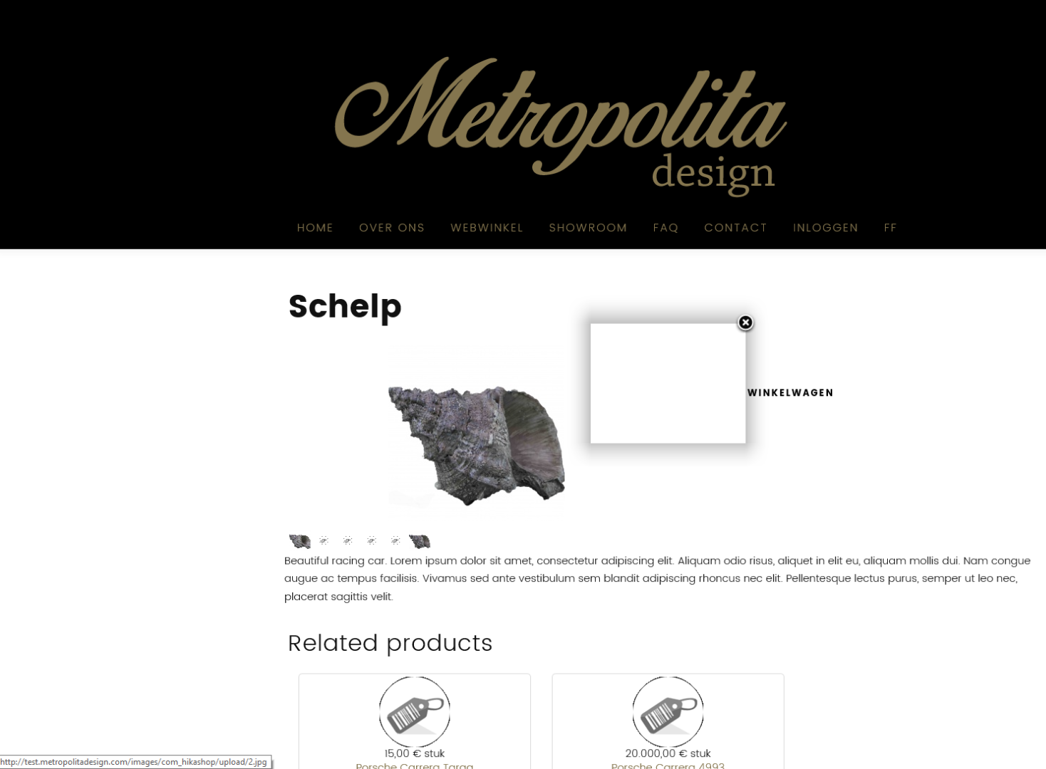

9 years 5 months ago #264729
Thanks for the solution :)
I added and works fine :)
Only now i have the issue when i click a image: see a white pop up no picture and click again the same picture than i see the large image. I upload 2 files than can you see the issue.
Any idea?
test.metropolitadesign.com/index.php/hik...porsche-carrera-4964
In Firefox works it perfect only in IE 11 sometimes i have that issue, i tried a larger and smaller image but same issue.

9 years 5 months ago #264741
I'm not able to reproduce the problem on your link. I always see the image in big when I click on the thumbnail.
However, the first time I do, I do see a small popup square for half a second until the image is downloaded.
I suppose that you must be on a slow internet connection and it takes more time for the browser to load the image on the first click because the image size is too big.
