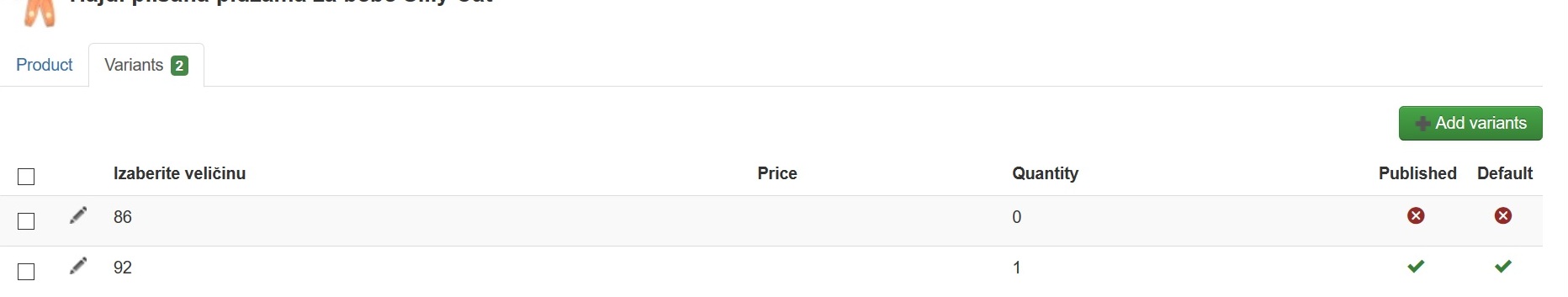

I have issue with unpublished variants. When I unpublish variants in backend it is still published in frontend. I attached screenshot, and u can check link I provided. As u can see, variant is unpublished but yet, it is displayed in frontend.

I have that option enabled cos I want products to be shown even if they are sold out. I just checked - even if variant have quantity higher then zero, and I unpublish it in backend, it is still getting displayed in front end.
In 2.6.4 version (out of stock is enabled too), If I unpublish variant it's now showed in front end. So unpublishing was working back then.
I didnt change product related options since 2.6.4 and I just tested for same product and it's working on that version.
I checked with default template and it's still displayed.
What I generaly need is, if one product have for example two variants and one of them is sold out, I need sold one to not be shown(product should be displayed no metter if both variants r sold out). Till now I did this manually, but I guess there is better solution for this.

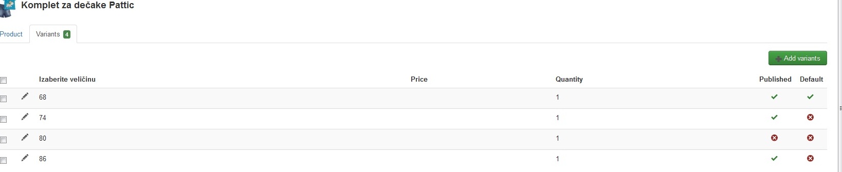

Seems like u read only first sentence.. It's not just about out of stock items, there is problem with items that I have on stock.
- I am manually unpublishing variant with quantity 1(check screenshot), it shouldnt be displayed in frontend, yet it is. You can check it on link:
bebili.rs/odeca-za-bebe-decake/komplet-za-decake-pattic
- Everything is working fine on 2.6.4, but on 3.0.1 it's not
And question: is there any solution for variants to be unpublish when they reach zero BUT with option "show out of stock" ON?

We fixed that on our end, and we'll add it on the next Hikashop release. To fix it you'll just have to edit the file "components\com_hikashop\views\product\view.html.php" and change the content:
		$filters = array(
			'product_parent_id IN ('.implode(',',$ids).')',
By :
		$filters = array(
			'product_published = 1'
The following user(s) said Thank You: kivici
