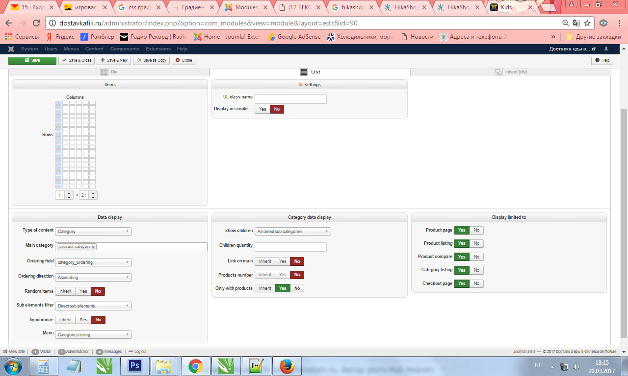

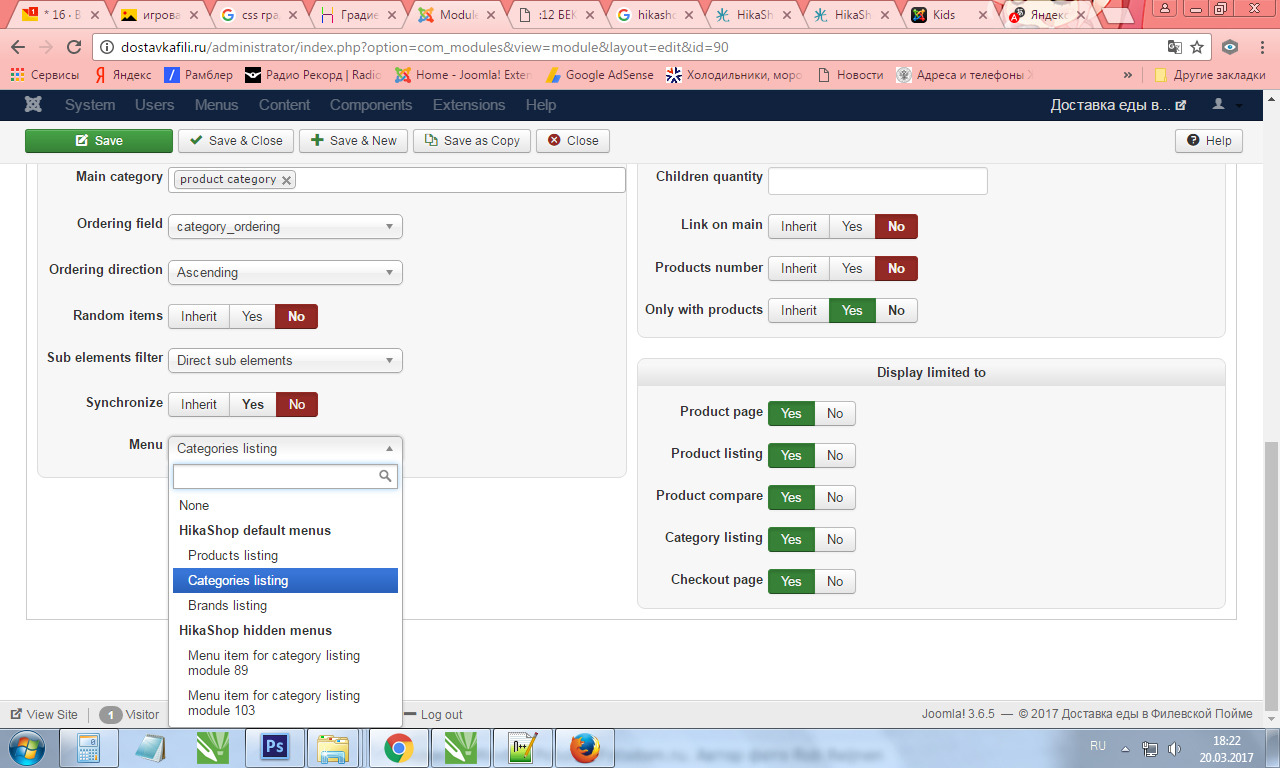

Hello!
There is a problem with accordion effect of content module. I want to display categories like on demo site demo.hikashop.com/index.php/en/hikashop/...div/category/16-kids . I used pictures from Nicolas's posts with settings of content module but no results. I can't find how to set "Display in Div / Div" - there is no such line in my module))) Maybe I did something mistakes in configuration of module...
  • Posts: 86058
  • Thank you received: 14182
9 years 4 months ago #265438
The settings looks correct. So it's probably something related to your template. Try switching to the default template of Joomla in order to make sure that it works fine with it.
Then we would need to analyze the page with the accordion module to be able to check what's going on.

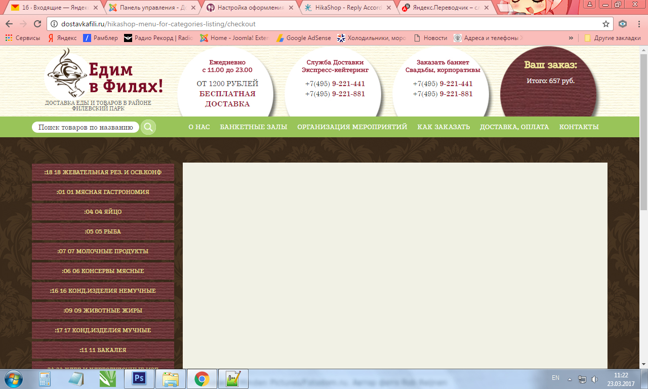

Here is my accordion : dostavkafili.ru/
And today I found that checkout doesn't work - only clean page. Yesterday it was OK
Thank You so much!
Olga

  • Posts: 45
9 years 4 months ago #265647
Hello, Nicolas!
I added Your code and It fixed my problem with menu effects. Now it works excellently! Thank You so-so much!
But something is wrong with checkout. It disappeared again(
Yesterday it disappeared and in some hours started to work. Now it isn't working. I've cleaned cashe many times but still it isn't working.

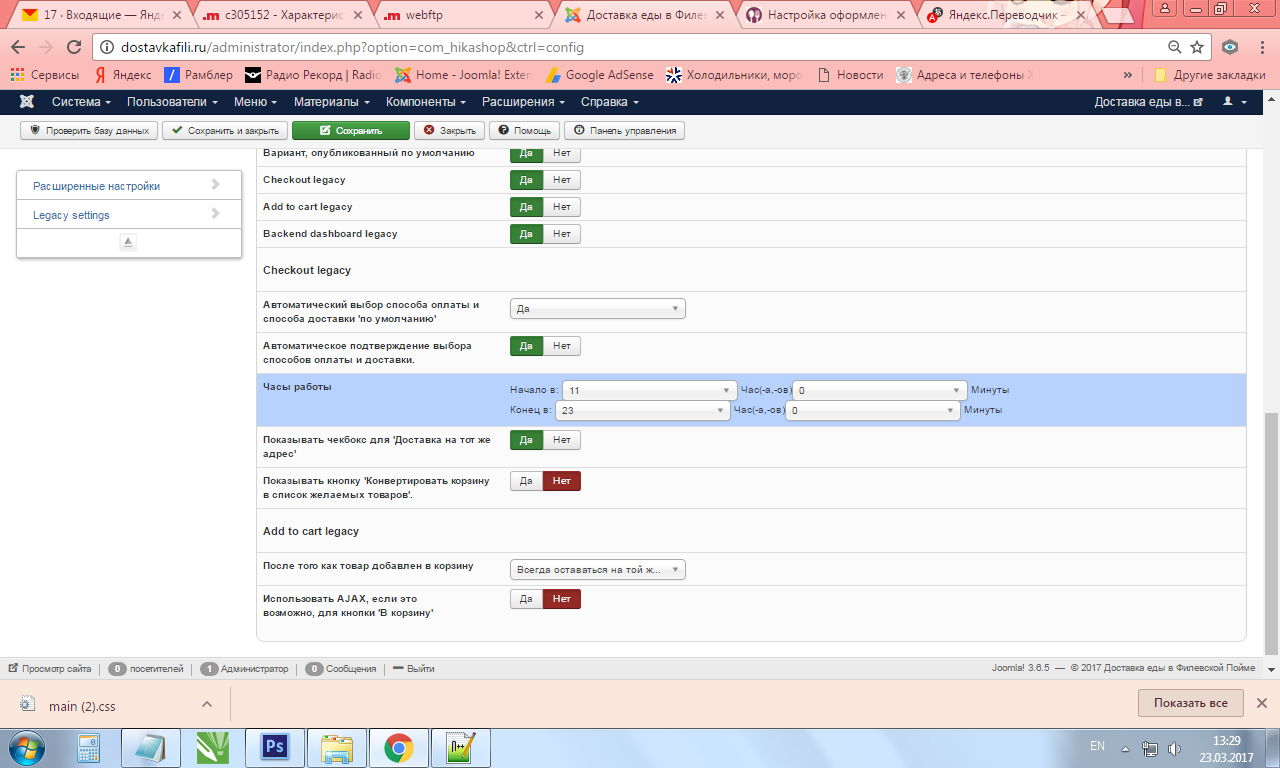

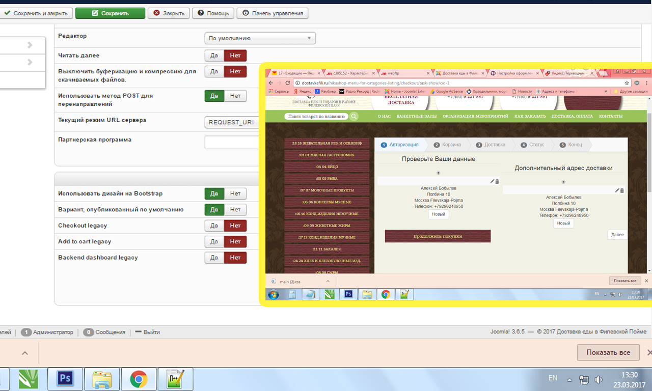

_________________ additional__________
I found that checkout works only when the Advanced setting "Checkout legacy" is turned off. Tell me please, is that OK?
And how can I set "same address as billing" to Yes - this field disappeared )) Maybe I can remove the delivery address l.... Help me please
Thank You so much
Olga
Last edit: 9 years 4 months ago by Displey.
  • Posts: 86058
9 years 4 months ago #265659
Please open a new thread when you have a new question.
With the checkout legacy setting turned off, you're using the new checkout of HikaShop, which is much better than the old one. So if that's ok with you, it's better to keep that option turned off.
The checkout not being accessible sometimes is because the business hours you configured. This option allows you to deactivate your checkout outside your business hours. So you want to not configure that option if you don't want to deactivate your checkout.
Also, when the checkout is deactivated, HikaShop displays an error message on the page, but it seems that your template isn't displaying the messages. I would recommend to check on that as it is important to let customers (and you) know when there is a problem :
www.hikashop.com/support/documentation/6...tibility-issues.html
