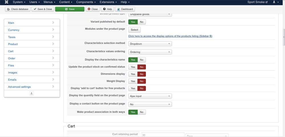

-- Joomla version -- : 3.6.5
Hello, I am finishing up a migration from 2.5 to 3.x and i noticed that all of my product pages have a module, that I have never seen before, displaying at the base of the product descriptions. The odd thing is that this module is not being displayed in a template module position, and there is no record of the module in the module manager. the module is called "the Sidebar.." and can be seen at the link provided.

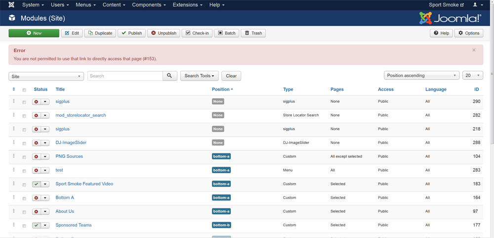

I went to Config> Display > Product Options > Modules Under the Product Page and sure enough there is a reference to this module (see image 1). Whenever i click the link to the module however i always get an error (see image 2). I googled around i tried to solve this error but to no avail. I dont know where this module is coming from or how to remove it. Your help would be greatly appreciated!

9 years 3 months ago #265618
That's indeed that option.
Instead of clicking on the link, you should instead click on the "select" button.
That will open a popup where you can disable the module and save.
Once done, save the configuration and that's it.

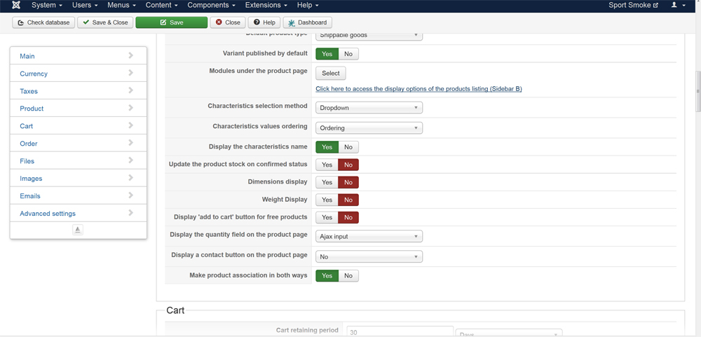

9 years 2 months ago #265785
Then, let's do it differently.
Go in your PHPMyAdmin, and in the table hikashop_config, search for the entry with the namekey product_show_modules and change its value to nothing.
That will remove the module from that setting.
  • Posts: 56
  • Thank you received: 4
9 years 2 months ago #265902
This worked, Thank you Nicolas!
