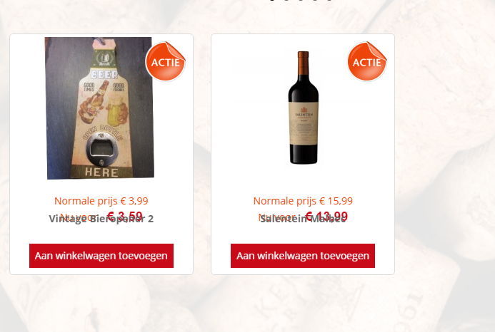

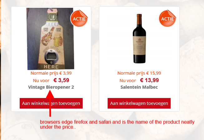

What can we do to make the shop look the same in chrome. As far as i can see with our developing site.
In other browsers such as firefox, edge it is showing neatly. But as far as i can discover not in Chrome. In the attachments you can see what i mean.

9 years 4 months ago #266312
That's because of the line:
height: 45px;
that you have in your custom CSS:
span.hikashop_product_price_full {
color: #666;
display: block;
height: 45px;
Remove that and it will display properly.

9 years 4 months ago #266367
We put that line in the css. because then, as you suggested in other topic. the add cart button will stay at the bottom. That is why we put the height in it. In the most common browsers it looks fine except in chrome. So in order to make it neatly i will have to put the line height higher. but then in the other browser i get more space between it. Or do you have another solution to get the add to cart button to stay on the bottom?
if i remove that line. it will be displayed like this:

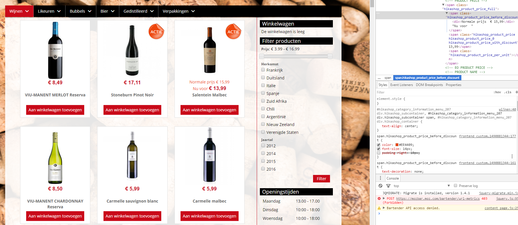

9 years 4 months ago #266377
I think the issue you have is coming from this:
span.hikashop_product_price_before_discount {
color: #EE4409;
font-size: 14px;
/* padding-right: 10px; */
if you remove padding-right it looks fine.
Also there is another issue that in this span you have div which shouldn't be like that.

Hello Kyratn,
The issue was not comming from that span.. :) and the div, yes i know but is needed for our look in the price and discount price otherwise it will be on 1 line. but the issue with the browsers is solved as far as i can see with what you mentioned earlier, with het min-height in css.. :)

9 years 4 months ago #266536
Thank you for this notice.. with min-height in css it is solved. only in chrome the to cart button is a little lower. :)
Thank you.
