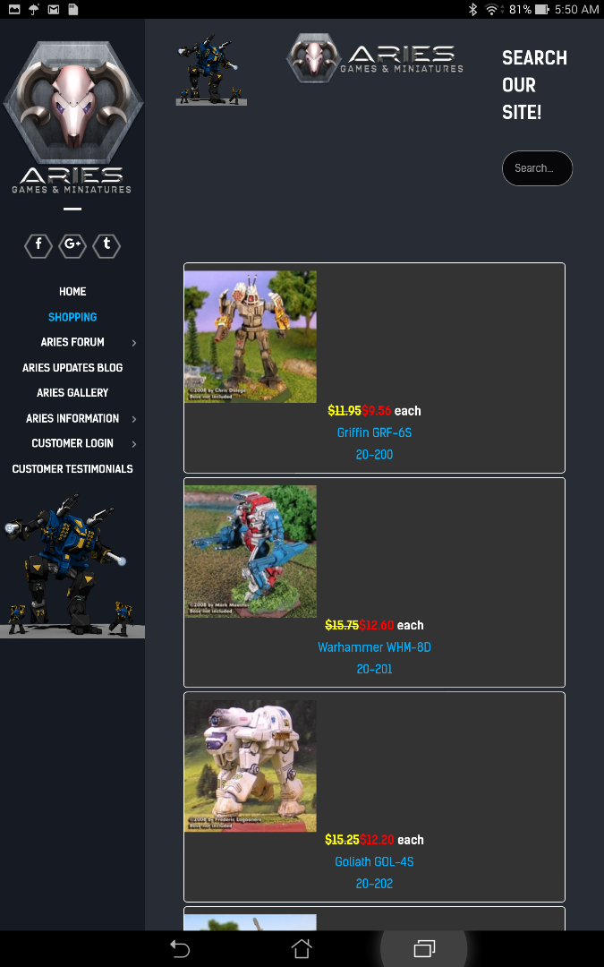

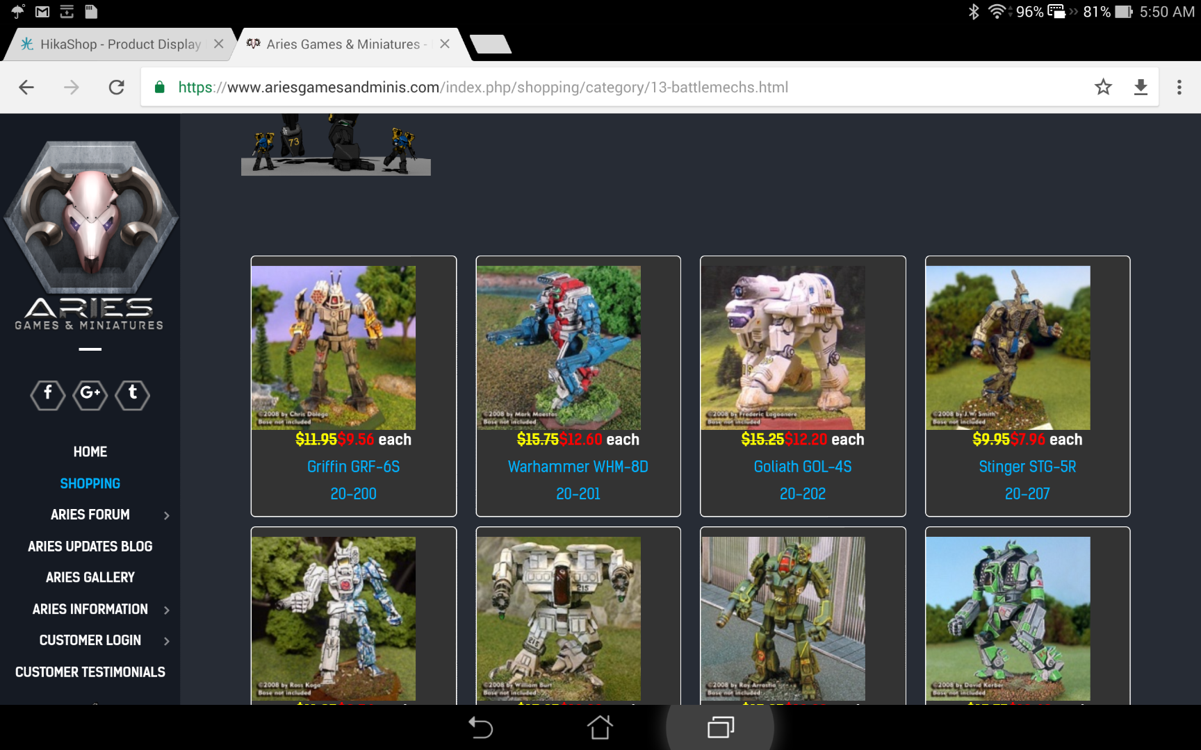

I have a product display issue that came up after installing the 3.0.1 upgrade. Please take a peek at the images attached, this is on both Mobile & Desktop. What can I do to resolve this? All images seem to be left oriented rather than centered. This is on product display...not category.

  • Posts: 86058
  • Thank you received: 14182
9 years 4 months ago #266458
Add such CSS to correct that:
.hikashop_product_image_subdiv { width :auto !important; }

9 years 4 months ago #266729
Wait a minute...so you're telling me that the update you guys pushed out, causes a problem, and you won't support the fix? Since when did this start?
  • Posts: 86058
9 years 4 months ago #266748
That's not that at all.
The problem is that you have customized the CSS of HikaShop based on an old version of HikaShop 2.2.1: www.ariesgamesandminis.com/media/com_hik.../frontend_custom.css
And that's this old custom CSS which isn't fully compatible with the new version of HikaShop.
When you customize the CSS and the update breaks the display of something because you have that custom CSS, it's only normal that you fix that custom CSS. Please remember that we provide user support, not custom development in our support... We always told you so and you keep coming back with customization questions... It's us that should be frustrated, not you.
Besides, the fix I gave you do fix the problem. Here is an example if you add it with your browser:
monosnap.com/file/CB6fxXPDmU9RyZfTTPfTuIpeR8rvEV
However that code has not been added on your website... Please understand that we already went the extra mile giving you the solution, you should be able to apply the modification yourself. The link Jerome gave explains how to add such CSS to your website.

9 years 4 months ago #266803
I was actually on 2.6.4 prior to updating to 3.0.1...and the images were fine.
Is there a reason that this change caused the problems, and wasn't something that could have been avoided? Is this going to be a constant issue in the future?
Also...I tried the fix again, this time it is working. I don't know why it would not work last time...maybe I missed copying over a character or something, so I apologize for that.
