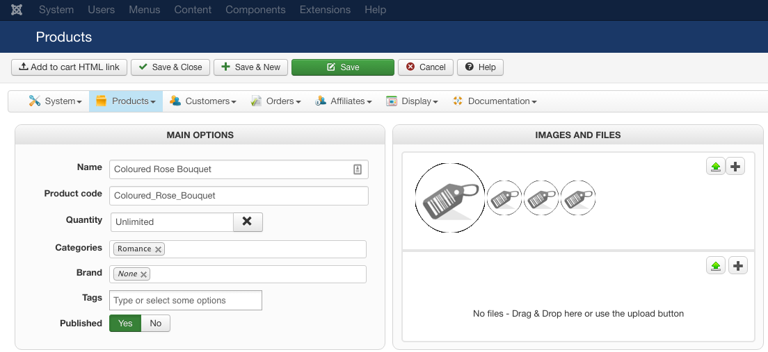

I can drag and drop the product image (or upload it).
It shows that it is uploading.
The image container turns green then...the image disappears.
No images show up in the image area.
BUT, if I save the Product and go into the product again, you can see all the ATTEMPTS I made in uploading the images -- these are represented by the 'default image' icon.

I found the issue:
The filename was apparently too long. Did not like 70 characters.
I have not had this issue before.
Is this perhaps a PHP setting that needs to change?
I'm thinking this is a suhosin issue.
I have contacted cPanel support.
Will let you know.

Regarding the "70 characters" long, I think you're right about suhosin ; that's the kind of check that this module is doing.

YES, it was a suhosin issue. It is working now.
Here is the fix. Set these variables in php.ini:
suhosin.get.max_value_length = 4095
suhosin.get.max_name_length = 512
suhosin.post.max_name_length = 512
suhosin.request.max_totalname_length = 512
suhosin.request.max_varname_length = 512
Note: This variable is especially important to receive back the confirmation code from PayPal: suhosin.get.max_value_length = 4095
Without this set the confirmation URL code will be truncated.
