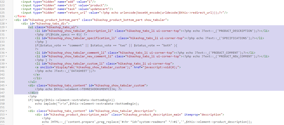

Thank You for the reply. I've done what's explained in the FAQ. I do have the required Tab now. The problem is that the TAB is empty, even though I've added code required to link it to Custom field. I've added a picture of edited region of show_tabular.php, can you spot what I've done wrong ?

If it didn't displayed the value of your product custom field, you should actually check that :
- you correctly used the value of your custom field "column name" through your custom field configuration page.
- you have set a value for your product custom field through your product configuration page.

Replied by svjatoslavs.krasnikovs on topic Add tabs to product view
Oh, misspelled the column name. Thank You for your help.
