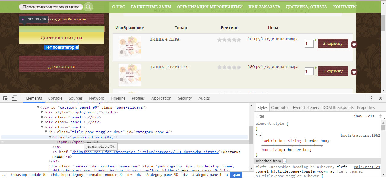

Hello!
When I created a single category of my shop (without subcategories on the second level) I found a strange behavior of accordion. Items without subcategories displayed with an empty tag <a><span></span></a> on the top. And in the bottom part of such items appeares words "No subcategories here". I can't find were I can switch off this feature. Help me please!
Regards!
Olga

I have the same problem with the use of the accordion category menu. In reality all categories are not so deep (subcategories) ...
I replaced :
HIKA_LISTING_LIST_EMPTY="No subcategories"
by
HIKA_LISTING_LIST_EMPTY=""
… in the language file. This solves the problem.
Jerome, Is this solution risky for the operating of HikaShop?

No, there is no problem in doing that.
