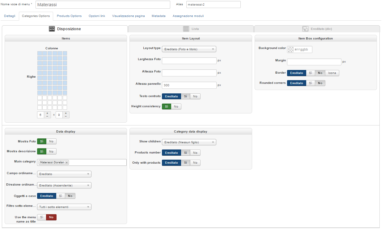

Attached the screen of the menu...

In your screenshot, I see that you have "Nessun figlio" selected for the "show children" option and this translation is for the English "No child" (and thus no sub categories displayed).
So you didn't change that option as I told you.
Change it and you'll see that it should work.
