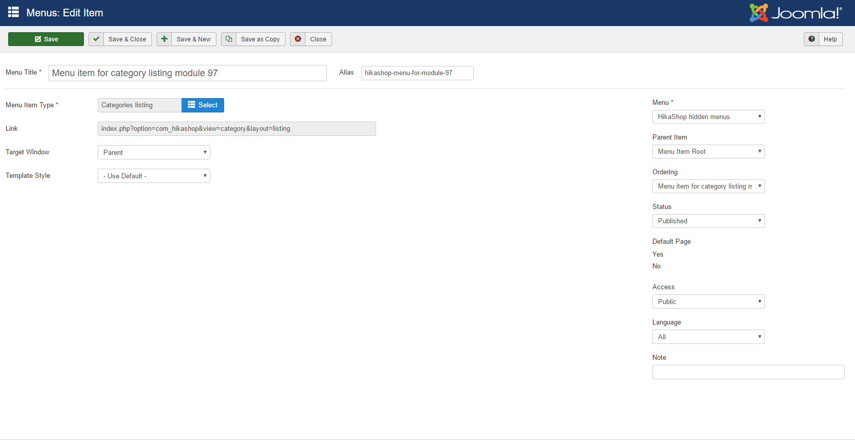

In the backed of my website, none of the tabs are showing in the menus. All of the other menu items are working properly, it is only the hikashop menus. They don't appear to be loading correctly. If you notice on the right hand side of the picture, the default page "Yes/No" slider isn't loaded properly either.

That's an error we actually patched in the 3.0.1 so you shouldn't have it.
Maybe it comes from some browser caching. Please try with another browser.
Also, make sure that the folder media/com_hikashop/js and its files are writable otherwise the installer cannot update the files during the update process and it could also result in the problem.
