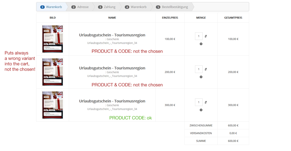

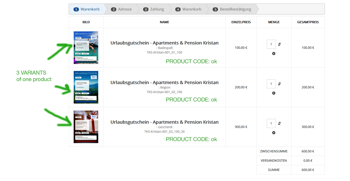

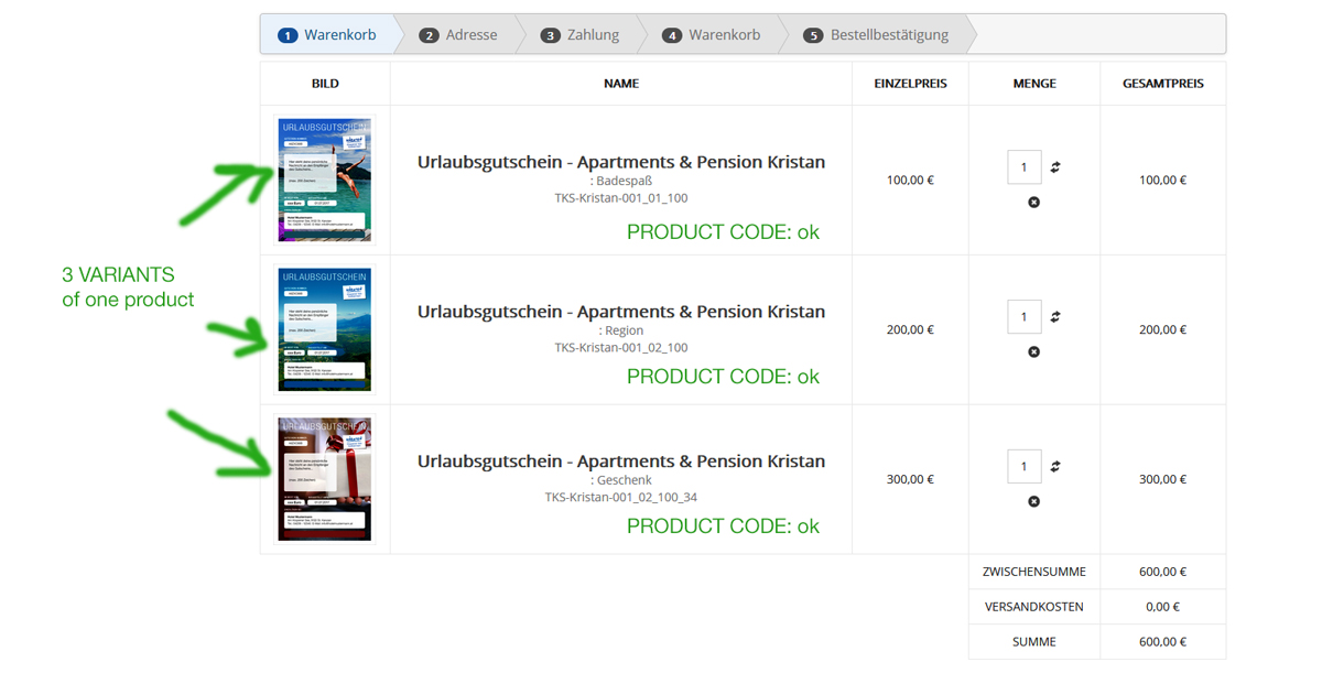

I have two products with variants (3 designs to choose) and a custom field (user puts in value for the voucher).
First product which I added a few days ago works fine and correct. Only the chosen variant is taken to the cart.
But I tried to add other products with the same three variants, same settings, different product codes...

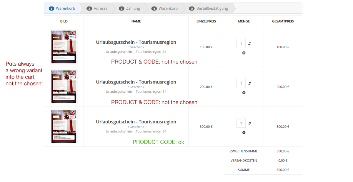

Problem:
- a variant is put into the cart which I did not choose
- the product code and the thumbnail belong to the variant which I did not choose
- it is always the last of the variants of the product, always the same product code
- the custom field is okay - it has the correct value in it
Product #1 - OKAY:
Product #2 - False:
Maybe I missed a setting or something like this...
I am clueless because Product #1 works as it is supposed. Others with same settings do not.
Thank you

The problem comes from the customization of the product page layout:
monosnap.com/file/hnp3WNWYKr1ObnohpwUb5cQHwSwtFd
By default in HikaShop, the variants data is outside of the form of the product page and the variant data is swapped when you change the characteristic. So when you click on the add to cart button and the form is submitted to the server, you only have the data of the current variant in the form.
In your case, you always have all the variant data in the form. And thus on the server side, it always use the data of the last variant in the form.
I suppose that the issue is that there are some </div> missing at the end of the show_tabular view file on your website. Try adding one or two there and that should help.
