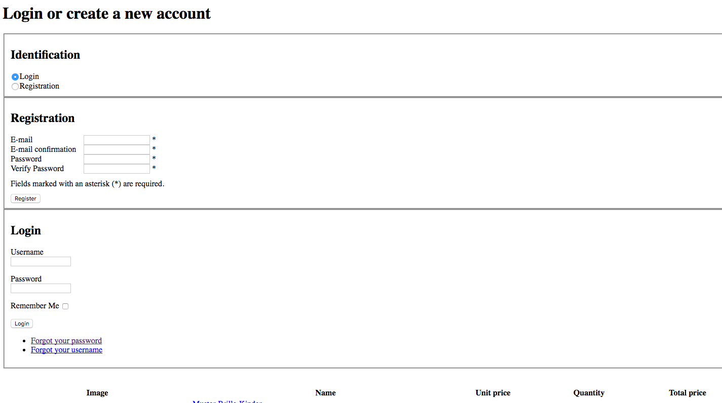

Hi. I have a questions. When i click on "add to cart" then change the complete page-layout.
how can i customize the "shopping Cart" layout? Best in the page Layout. you will see in the pictures what i mean.
And can i add a Menu-point "shopping-Card"???

HikaShop 3 comes with a "cart notify" plugin to display a tooltip or a popup when a product is added into the cart.
www.hikashop.com/home/blog/367-hikashop-3-0-out.html#cart
If that plugin is unpublish, the customer will be redirected to the checkout page.
But in your case, you're using the legacy mode, so the redirection is made via these settings :
www.hikashop.com/support/documentation/5...html#advanced_legacy
And you have a fatal error in your checkout.
That's why the checkout page is not complete and that you do not see your template.
You should take a look at your PHP error log in order to get the fatal error details (full message, file and line of the error).
Only with the details of the error we will be able to give you a procedure to correct the issue.

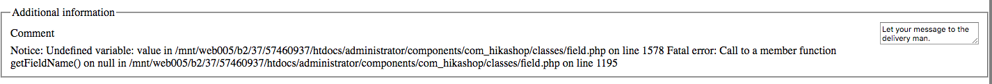

On the picture is the error in my checkout. I hope this is enough to correct the error????
  • Posts: 26381
9 years 2 months ago #270922
Please download HikaShop 3.1.1 to get the fix for that bug.
