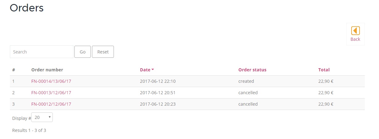

1. Ok. But after 15 minutes the statuses returns to its original settings (they become disabled).

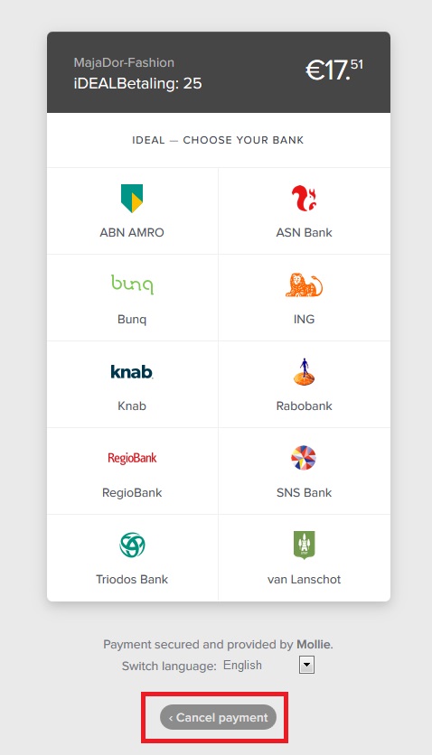

2. I Use the button "cancel payment" at the bottom of the page for IDEAL. The order status change from created to cancelled on backend hikashop propertly, but product does not come back to stock.
3. When I don’t use the button "cancel payment" and don’t pay also, the cron plugin change the status from created to cancelled after 15 minutes properly, but the product does not come back to stock. When I change the status manually from created to cancelled on backend hikashop product returns correctly to the stock.
For paypal everything works correctly.
4. The payment plugins redirect to the payment page propertly, but if I don’t pay and close the payment page, before cron changes the order status to canceled it is available for customer on the front-end as created. Can he then finish the order any way?

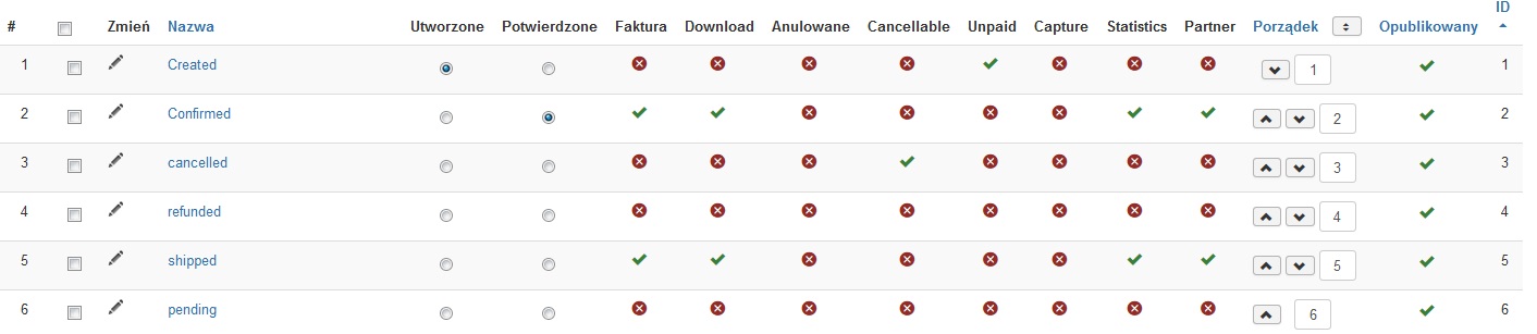

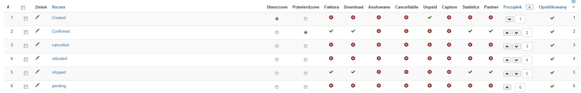

Two days ago I sent you a mail with data to my site, where I asked you to check why the order statuses deactivated themselves?
I wanted to set statuses as you wrote
1 - You should configured your "cancelled" orders statuses (it's "Anulowane" for your language).
Best is to set "cancelled" and "refunded" in that list.
but I can't. When customer cancelled order, order statuses return to the initial settings (att) and product does not return to stock. Can you help me with that?
