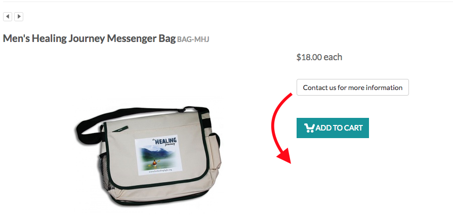

How can I move the "contact us for more information" button on a product page down below the "add to cart" button? I tried adjusting the product > show_defaut, but it didn't work. Am I looking in the right place?

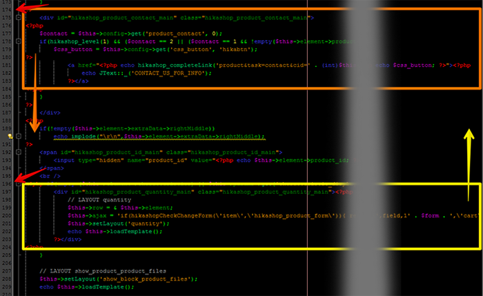

Sorry for the misunderstanding, let's try again !
You are in the good view if you use the default view, and so you have to invert the "block"
With this one :
Hope this will fit your needs.
Code:
<div id="hikashop_product_quantity_main" class="hikashop_product_quantity_main"><?php
// LAYOUT quantity
$this->row =& $this->element;
$this->ajax = 'if(hikashopCheckChangeForm(\'item\',\'hikashop_product_form\')){ return hikashopModifyQuantity(\'' . (int)$this->element->product_id . '\',field,1' . $form . ',\'cart\'); } else { return false; }';
$this->setLayout('quantity');
echo $this->loadTemplate();
?></div>
Code:
<div id="hikashop_product_contact_main" class="hikashop_product_contact_main"><?php
$contact = (int)$this->config->get('product_contact', 0);
if(hikashop_level(1) && ($contact == 2 || ($contact == 1 && !empty($this->element->product_contact)))) {
$css_button = $this->config->get('css_button', 'hikabtn');
<a href="<?php echo hikashop_completeLink('product&task=contact&cid=' . (int)$this->element->product_id . $this->url_itemid); ?>" class="<?php echo $css_button; ?>"><?php
echo JText::_('CONTACT_US_FOR_INFO');
?></a>
<?php
</div>

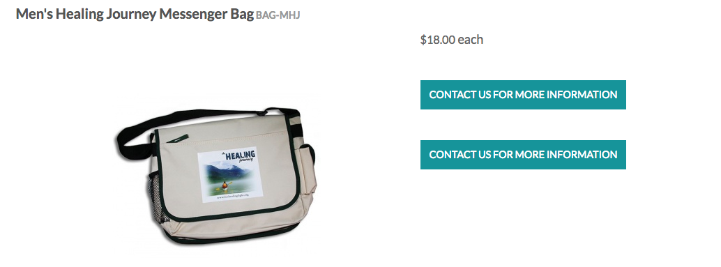

Thank you for the help, Philip. I found that I am not using the default view. I'm using the tabular view for products. So I found that same location in the show_tabular view and replaced it with your code. I'm not sure if it needs to be adjusted for that view, but now my add to cart button has been replaced with another contact button. See screen shot.

Here you have replace one block the add to cart block :
By this one, the contact form button, and of course you have 2 times the same block :
I said you have to invert or swap or switch up, have a look on this screenshot :
Hope this will be more clear.
Code:
// LAYOUT quantity
?></div>
Code:
?></a>
<?php
</div>
Last edit: 9 years 3 months ago by Philip.
