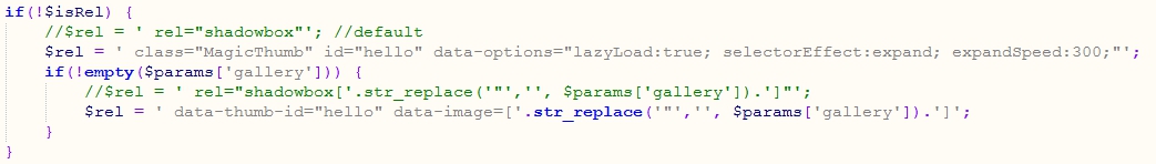

After replacing shadowbox on magicthumb (demo version), open the first photo is duplicated and not working correctly gallery. The replacement was by changing the file popup.php. Please tell me, is there a solution to this problem?

I suppose that's because the first one is the main image on the product page and the second one is the thumbnail of that image in the list of the thumbnails.
I don't see a solution to avoid that.

console chrome before load product page with magicthumb
Failed to load resource: the server responded with a status of 404 (Page not found : hikashop_main_image)
There is a suspicion that somehow not correctly fulfills the [hikashop_main_image]. When using shadowbox this is not observed. And actually, that tries to load the script magicthumb
http://lamele.ru/katalog-produktsii/dveri/product/[hikashop_main_image]
It is possible to correct the code to work correctly magicthumb?
Last edit: 8 years 11 months ago by quality.
  • Posts: 85783
  • Thank you received: 14072
8 years 11 months ago #273423
I don't know what should be corrected. You should seek help with MagicThumb because on our end we're just adding normal HTML, and if you use shadowbox, then it's shadowbox which does everything for the popup display, not HikaShop.
