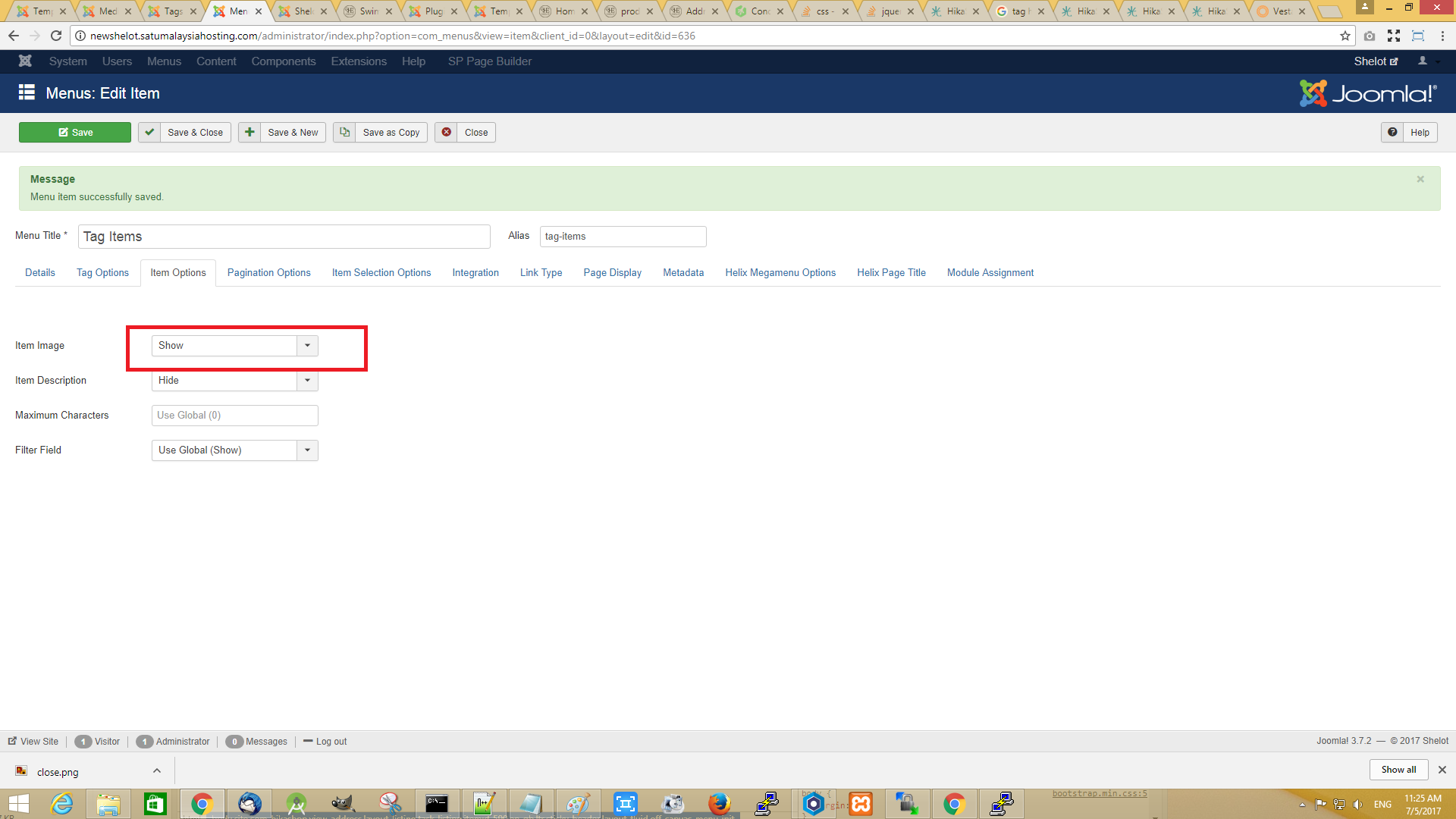

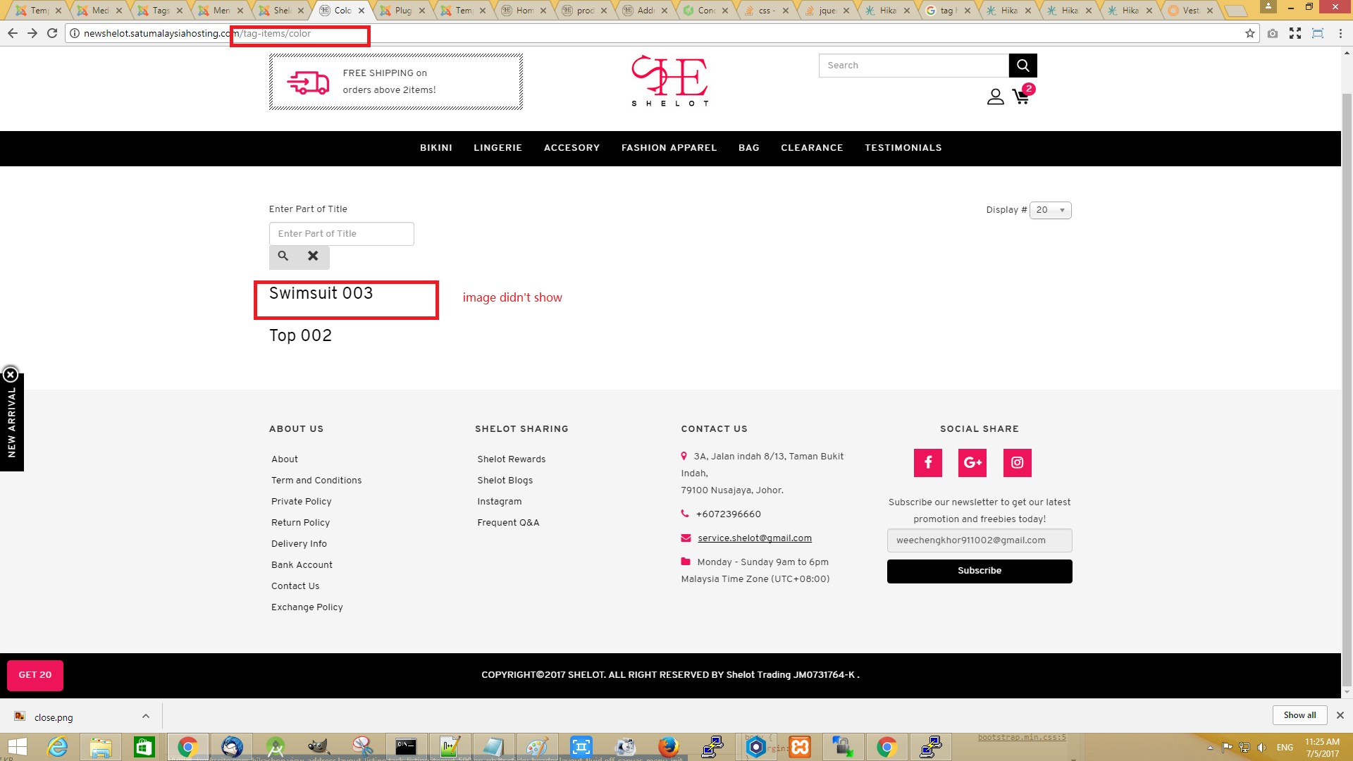

-- Joomla version -- : 3.7.2
Why the tag item didn't show the image? I have enabled show the image option
  • Posts: 83932
  • Thank you received: 13588
7 years 11 months ago #273354
The integration with the tags feature of Joomla doesn't support images for now.
  • Posts: 567
  • Thank you received: 11
7 years 10 months ago #273953
But why I enable item description, it can be supported whereas item image cannot
