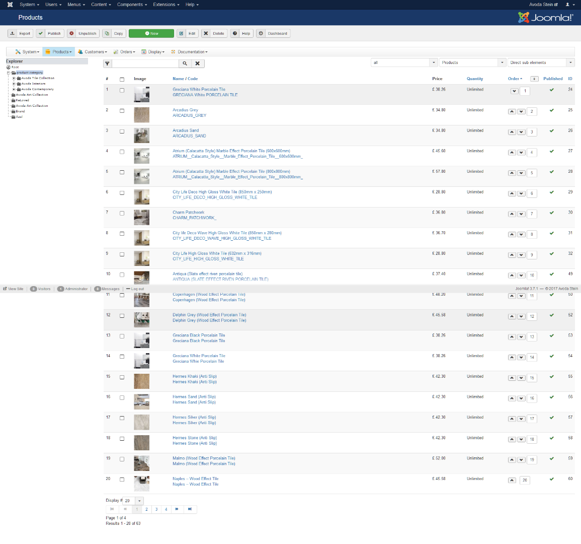

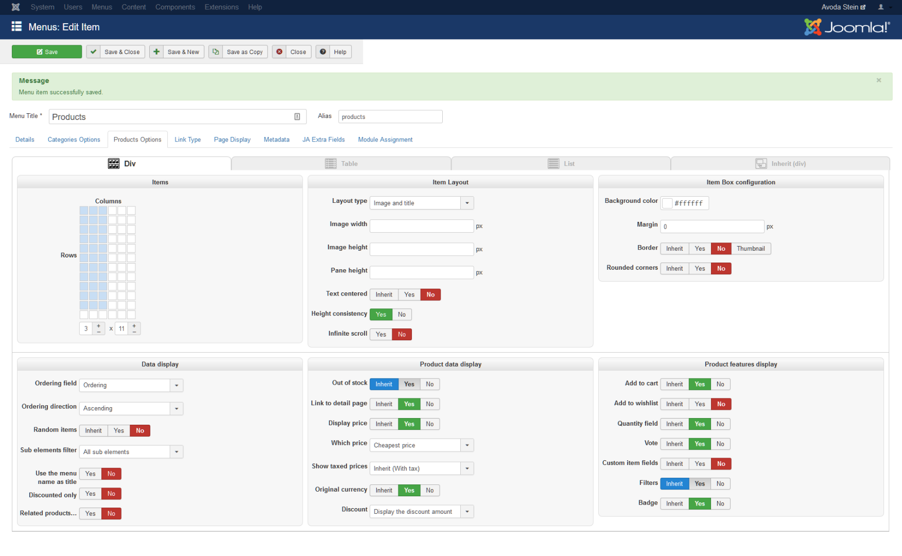

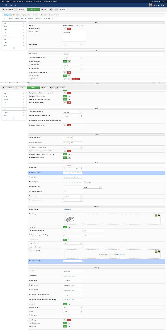

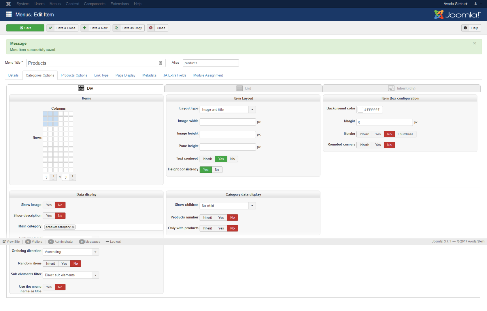

I have selected the category list menu item and configured as per attached images. However, no products show even though there are products in the main product category and in the sub categories. What am I doing wrong please?
Thanks!

You should check that :
- Your products are correctly part of the displayed category
- Your products have a stock or that the "Display out of stock products" option is set to YES via "Hikashop->System->Configuration->Main"

Hi, Thanks for getting back to me.
- Yes there are products in the categories.
- Yes "display out of stock products" is set to YES

Your configuration seems good, can you try to switch your template to default one like Protostar or else, in order to see if by doing that your listing is display.
If that solve your issue :
that means that's your issue is template related, and so you have to contact your template creator support.
If that change nothing :
Provide by using our Contact us form some backend/frontend access in order that we can process some tests by ourself.
Note : Add to your message an Url link to this topic AND notify us in this topic by a new post when it's done.

Template override issue - thank you for your help. :)
