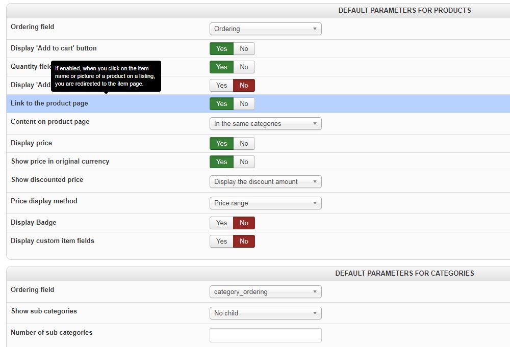

3. When you say, "on the backend products listing, you can select 'ordering' in that setting," where are you referring? Are you saying go here:
Hikashop > System > Configuration > Display tab > DEFAULT PARAMETERS FOR PRODUCTS then select "Ordering" for "Ordering field"? If so, I've already done that.

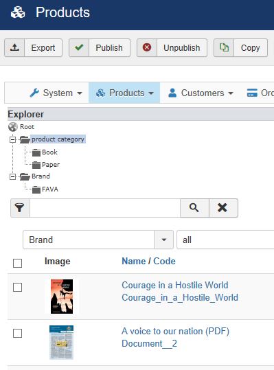

In the Components > HikaShop > Products page two products are listed: a Book "Courage in a Hostile World" and a Paper "A voice to our nation" in that order:

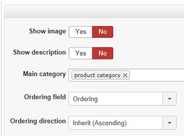

In the Menu for the Products-listing page, namely Shop (Alias: hikashop-menu-for-products-listing), The Products options tab has the Ordering field set to "Ordering":

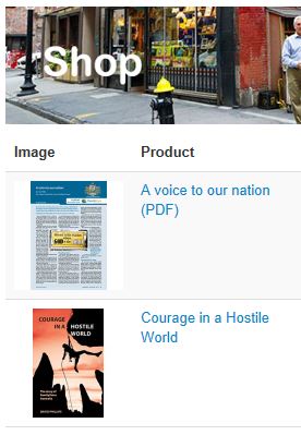

In spiite of that, the public Shop page has the ordering reversed - paper first, then book second:
What am I doing wrongly? Or, is there a bug in the system?

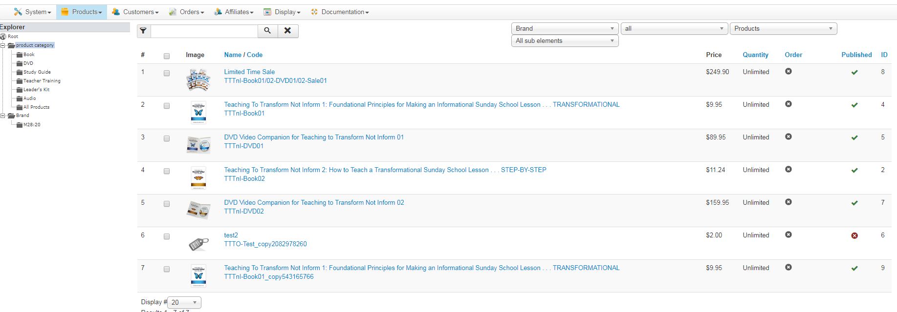

The Order column had no numbers and the dropdown above was set to "All sub elements":
I changed the dropdown to "Direct sub elements":
And everything then worked as desired.

How do i change this exact thing you show here?
I also have no numbers in the order column and i need them to change the ordering.
(if i change to direct sub elements it will show only 1 product for some reason)
