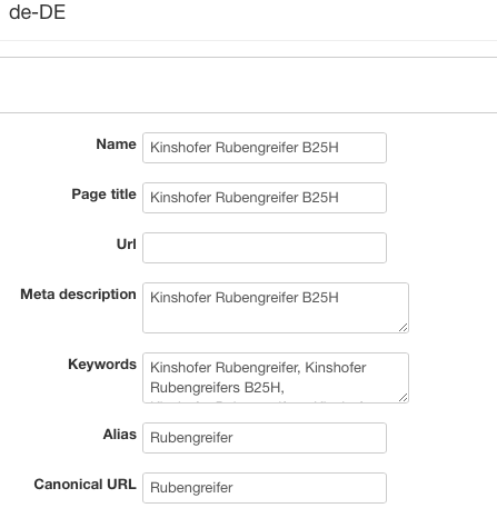

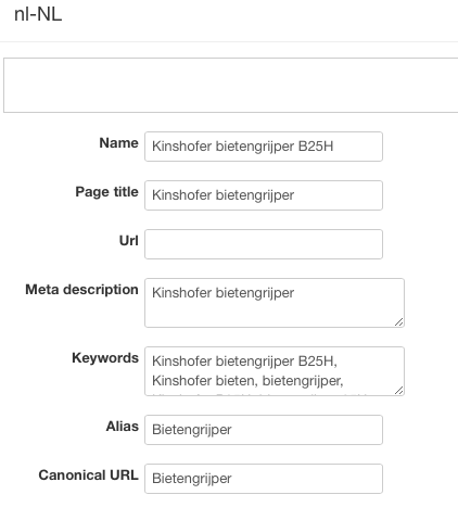

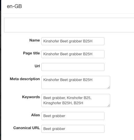

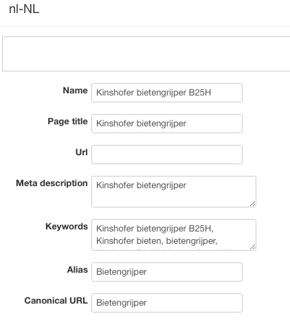

I've also a problem with Canonical urls on multilanguage site.
When I use te Canonical input field at a product it works, but when I fill it in at the pop-ups for each language is doesn't work.

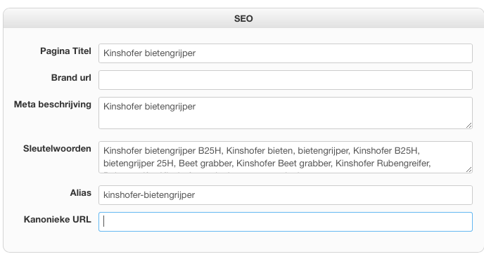

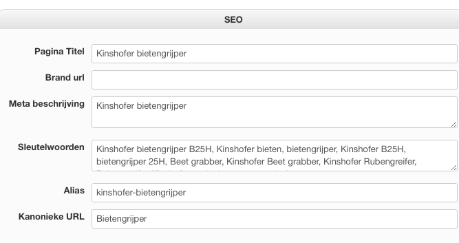

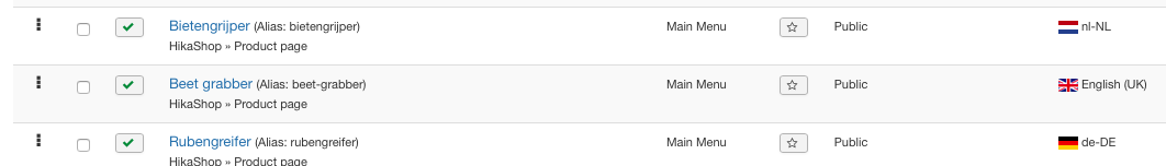

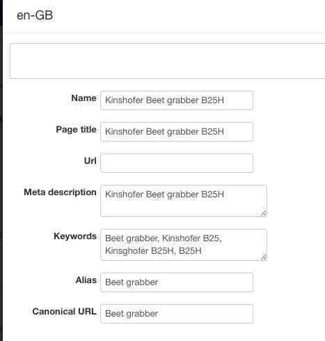

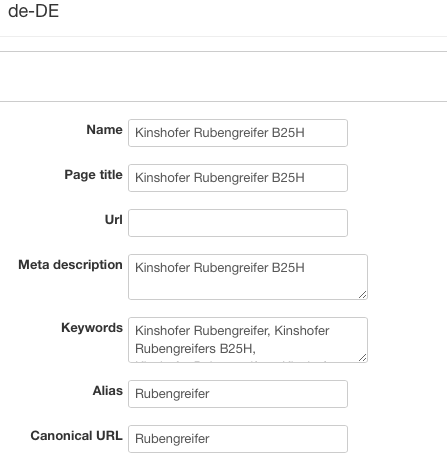

  • Posts: 30
8 years 10 months ago #276481
See the attachments: when I fill the Canonical url in the Product overview it works, but when I fill the Canonical in the language NL-nl it doesn't work. The url is made in the menu for the language NL-nl.
The url that that i want to use: rigterhandelsonderneming.nl/bietengrijper

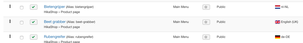

  • Posts: 26355
  • Thank you received: 4068
8 years 9 months ago #277077
We can see that you use a different alias between the main configuration (English I guess) and NL.
Afterwards, I'm sorry but we do not have the requested elements to understand what is not working :
We would need more information about what you mean by "it doesn't work" in order to help you.
What URL did you use for canonical URLs ? What are the aliases that you set ?
What error did you get ? What were the links on the frontend ?
You have the same canonical URL for your two elements and you have to understand that HikaShop do not override the Joomla routing system so you can't use any URL you want for the canonical, the URL and you need to use an URL which can work, which can be routed by Joomla to HikaShop.

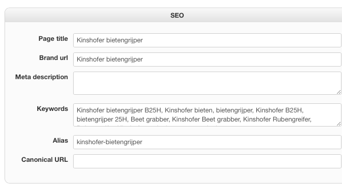

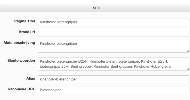

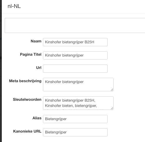

  • Posts: 30
8 years 9 months ago #277149
When I Use the main configuration Canonical URL it works, but then it is the same Canonical URL for all the languages and I want a different one for each language.
When I delete the main configuration Canonical URL and only fill the Canonical url within the language popup (one for english, one for dutch, one for french and one for German) the Canonical URL doesn't work

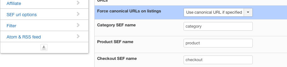

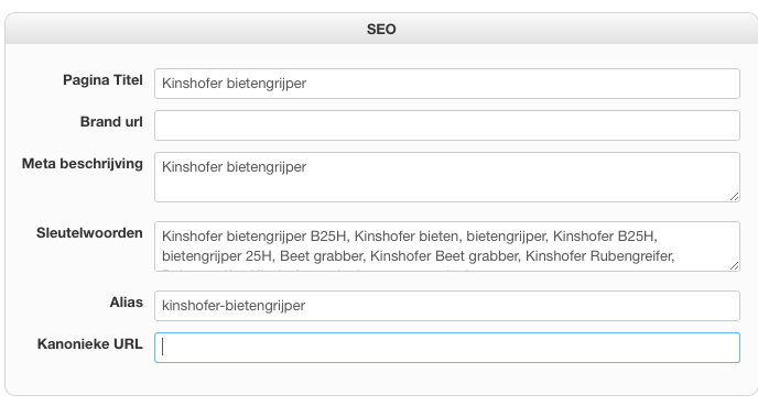

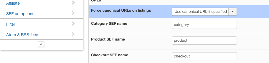

  • Posts: 85765
  • Thank you received: 14071
8 years 9 months ago #277151
Remove all the canonical URLs of the product and make sure that your HikaShop configuration is configured to only use the canonical URLs if filled.
That way, HikaShop will generate itself the URLs.
Then, if you have a different alias for each language for that product, you should be able to see the valid URL that HikaShop/Joomla's SEF system generate for the product in each language using the alias of each language.
And you can set these URLs as canonical URLs in each language of the product and it should work fine.

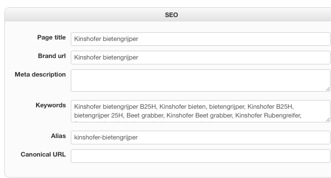

  • Posts: 30
8 years 9 months ago #277220
Sorry, still doesn't work :-(

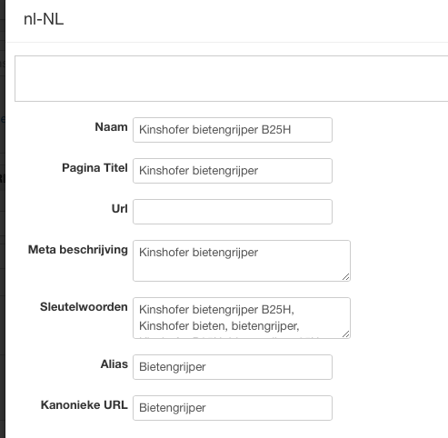

  • Posts: 30
8 years 9 months ago #277273
I don't get an error. The link that opens is not de Canonical one. For example, the the link for dutch is still: www.rigterhandelsonderneming.nl/nl-NL/hi...shofer-bietengrijper where it should be: www.rigterhandelsonderneming.nl/nl-NL/bietengrijper or www.rigterhandelsonderneming.nl/bietengrijper
In the attachments the screenshots

  • Posts: 85765
8 years 8 months ago #279358
I got the access and your email.
I fixed the aliases of the product you gave as an example and entered the canonical URLs as they should be and it works just fine for me.
Regarding the description which isn't displaying, I don't know. If you enter a description in the main product, this one displays fine. It means that the issue is that Falang doesn't find the translations for the description to replace it.
I'm afraid you'll have to contact the Falang support regarding that.
