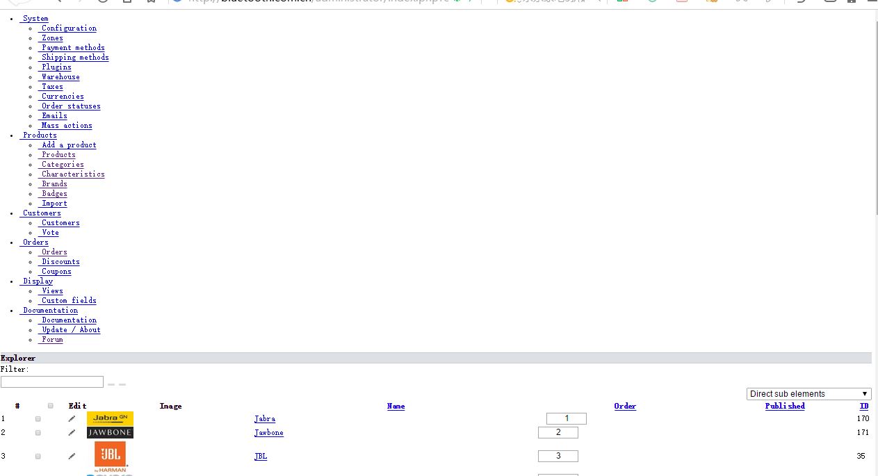

Dear Sir,
Brands couldn't display normally in backend.So I couldn't add or delete brand. Could someone know what is problem?
Thanks!
Screenshot:
8 years 10 months ago #276218
An error occurred but probably can't be displayed because the Joomla debug mode and Error reporting are disabled, can you :
- Activate the Joomla debug mode ("Administration->Global configuration->System->Debug System/Language")
- Set the "error reporting" option of the Joomla configuration to "maximum"
- Test it again so that you can see if it display an error message which will help us to understand from what your issue is coming.
Thank you.
  • Posts: 94
8 years 10 months ago #276270
Thanks Mohamed,
It displays a error when I set configuration of joomla:
"Invalid field: Redis Server Port"
Could you help me to make a test in website backend ? I will sent you a administrator info.
Many thanks!

  • Posts: 94
8 years 10 months ago #276325
Dear Nicolas,
Many thanks! Now Redis problem solved. I could set configuration now.
Then I found the error about Brands category:
"Fatal error: imagecreatefromjpeg(): gd-jpeg: JPEG library reports unrecoverable error: Not a JPEG file: starts with 0x89 0x50 in /var/www/html/administrator/components/com_hikashop/helpers/image.php on line 918"
Or could your login my website backend to have a check?
Many thanks!

  • Posts: 26355
  • Thank you received: 4068
8 years 10 months ago #276331
1 - You have images with corrupted data or images with a "jpeg" extension which are not jpeg image.
Please check and fix your images.
2 - No, that's not the goal of our support. Thanks for your understanding.
