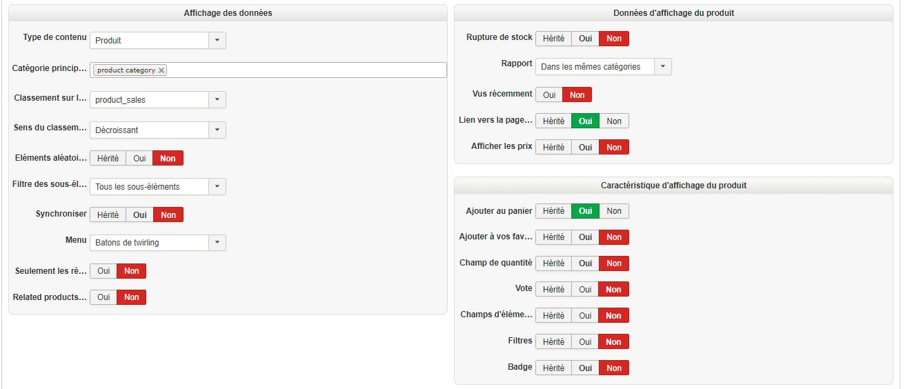

  • Posts: 202
8 years 10 months ago #279936
in the front end I need to display a module that shows the best seller product.
here are the settings I use in the HikaShop Content Module
thanks
cyril
  • Posts: 86058
  • Thank you received: 14181
8 years 10 months ago #279945
These settings look fine for what you want to do.

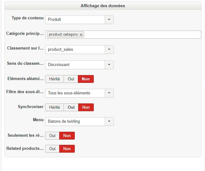

  • Posts: 202
8 years 10 months ago #280119
Here are the screeshots you requested (at least this is what I understood)
Cyril
8 years 10 months ago #280144
From all I can see, everything seems right, unless maybe your "Ordering direction Ascending" option that must be "Ascending" ?

  • Posts: 86058
8 years 10 months ago #280414
From what I can see on your backend, you set the "ordering direction" setting of your module to "ascending" so in that case it will display the product with the lowest product_sales value.
Please change it to "descending".

  • Posts: 86058
8 years 10 months ago #280518
I've checked and there were 2 additional issues on your website:
1 You've set the "sub element filter" setting of your module to "direct sub elements" so that means that it would only take into account the products directly in the category you selected in the module.
2 You had the "out of stock" setting deactivated in your module. However, the only two products with sales are products with a quantity of 0, so of course the module wouldn't take them into account.
Now I get in the module the product with the most sales in the module on your website...However it doesn't have any stock so I don't recommend leaving the module like that.
