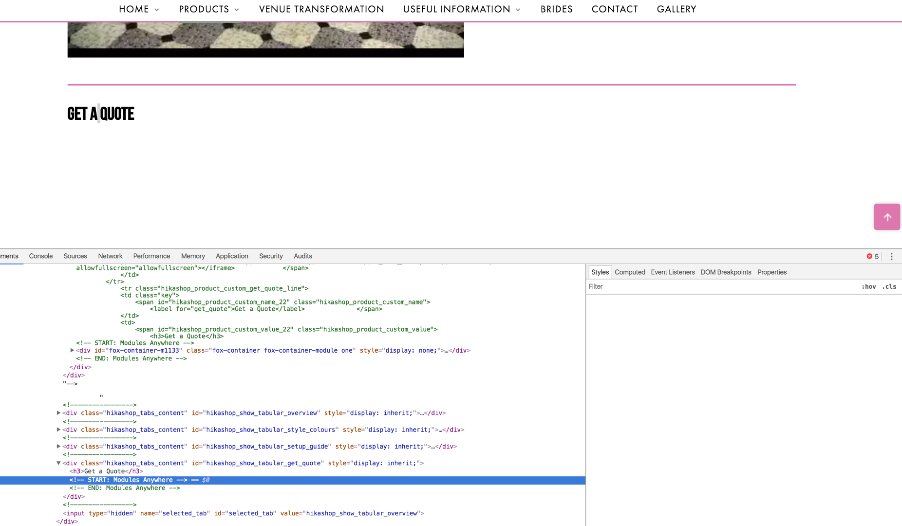

Hello I am using Modules Anywhere plugin to add a module into a custom filed I have created for a 'Get a Quote' tab.
It seems to be working and reading the snippet code but its not displaying the form. I have taken a screen shot of what the html code is displaying.
Looking at the HTML code it is displaying the form under the specification tab which I have commented out of the PHP but wont display under my new custom tab.
  • Posts: 26381
8 years 9 months ago #281447
You should look at the page source code and not the page DOM.
There you will be able to see that some of your customization break the DOM content and that's why you have something strange in your screenshot.
I will more recommend you to perform comments using PHP than HTML comments ; as you will see, there is an unwanted side effect with module anywhere start/end tags.

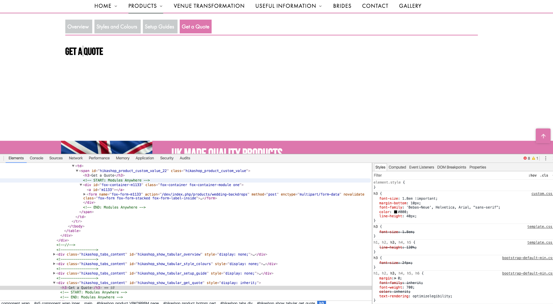

8 years 9 months ago #281517
Thanks for that, commenting out with // as improved the look on the front however. The form will still not display in the tab, but its still appearing in the commented out specification section.

8 years 9 months ago #281759
I just checked your website and everything seems to be ok, the only thing that is missing is the module that is supposed to display the "Module Anywhere" component. As you can see through the HTML code of your product page :
         <h3>Get a Quote</h3>
<!-- START: Modules Anywhere --><!-- END: Modules Anywhere -->	  </div>
