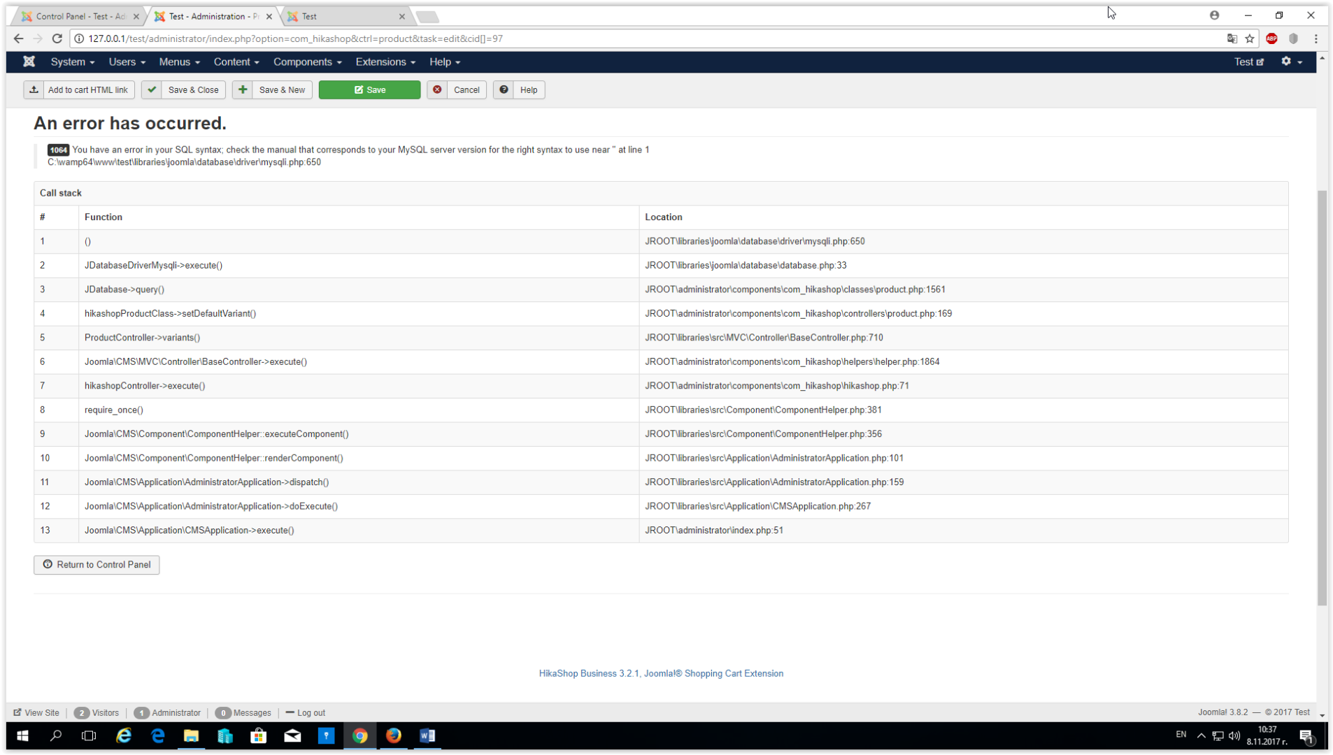

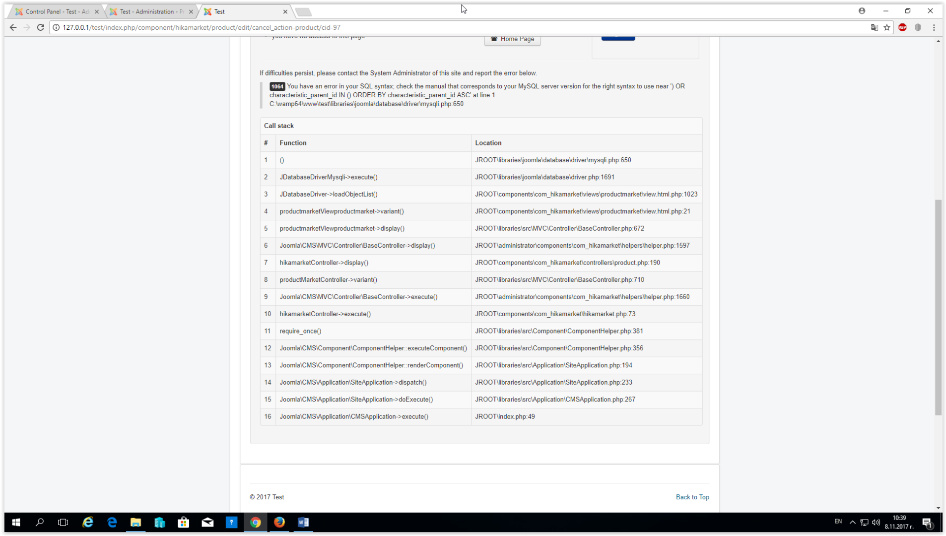

Hi, I have the following problems with the variants.
The first if I try to set a variant (created by a partner) by default from the administration of Hikashop, I will get the following error:
The second is if I try to change the variant (created by a partner) from the panel of Hikamarket will get this error:
This is a short video of the test: youtu.be/Hjh5h7AoEDE

Regarding HikaShop, this can only happen if you have variants with data in the hikashop_product but not in the hikashop_variant table.
This should normally not happen. So the issue is not really that setting the default variant doesn't work, but something else which made that situation possible.
Normally, when the first variant is created for a product, it is automatically selected as default, and the data is automatically generated in both tables for all the variants when you create them.
Are you able to reproduce the problem with another product ? What are the steps you took to reach that state ?
Also, which version of HikaMarket do you have ?

Hi, all the variants added by other users through Hikamarket is getting this problem. For the test I used the example demo of Hikashop and execute scenarios with two users-one is a user (the partner who added the variant), the other is like a super admin. You can see in the video I've shared in the first post, the exact steps I've done. I use the latest versions of your products (downloaded from today).

Basically, a characteristic "vendor" do not have any value in the database ; that characteristic is using element provided dynamically via a special trigger.
Due to the fact that there is no "values", you can't have a default value for the vendor because you can't store that information in the database.
So, something has to be changed in the "toggle" in order to avoid to affect a value where there is no available values.
Now regarding the rest, there is a line of code :
The variable $element->characteristics can have an entry without a name ; so if you do a "array_keys", you can have an empty string in the array of result and not just numbers. That explain one of the errors you got.
That's why, I proposed to replace for the HikaShop product class (in the function updateCharacteristics, that code
into
Thus it will avoid the SQL error when updating the characteristics.
Regarding the toggle part ; we have to perform deeper investigation and see how we can improve the structure to allow dynamic characteristics like the "vendors" one, to still have the possibility to have a default value (even if there is no values in the database).
Please note that you have to revert the Nicolas' patch.

We've added these patches on our end so that the interface doesn't crash when using it, in both HikaShop and HikaMarket.
For the default variant selection to work with dynamic characteristics like the "vendor" one will require a profound rework of the characteristics/variants system. We have an idea of what should be done, basically transfer the data from the hikashop_variant table to a column in the hikashop_product table for the default variant selection, but it means a lot of things to be adapted here and there to handle that change.
