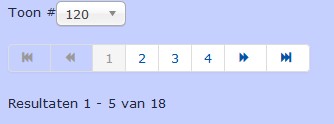

Standard I don't use pagination. After enabling pagination, I see most more products have moved to the second page (see attachment).

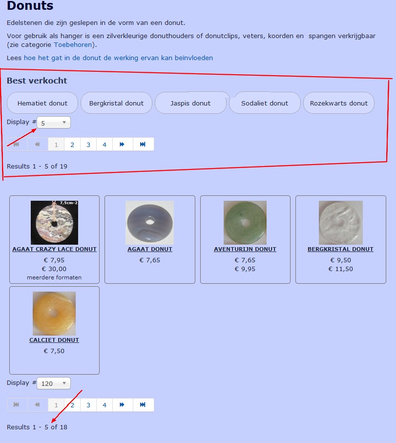

I've tried Modules Anywhere but this doesnot make any difference, the problem persists.
Providing a link to a page with the issue is problematic It's undesirable to activate Redirect POST mode on the live site, since many products wouldn't display anymore
I've attached a screen shot of a category view on the local copy of the website where Redirect POST mode is activated.
I also activated the pagination so you can see what happens.
The maximum display of bestsellers is 5, and because of that the product listing below only shows 5 products instead of all products (with a maximum of 120).
I hope this helps.
Udo
