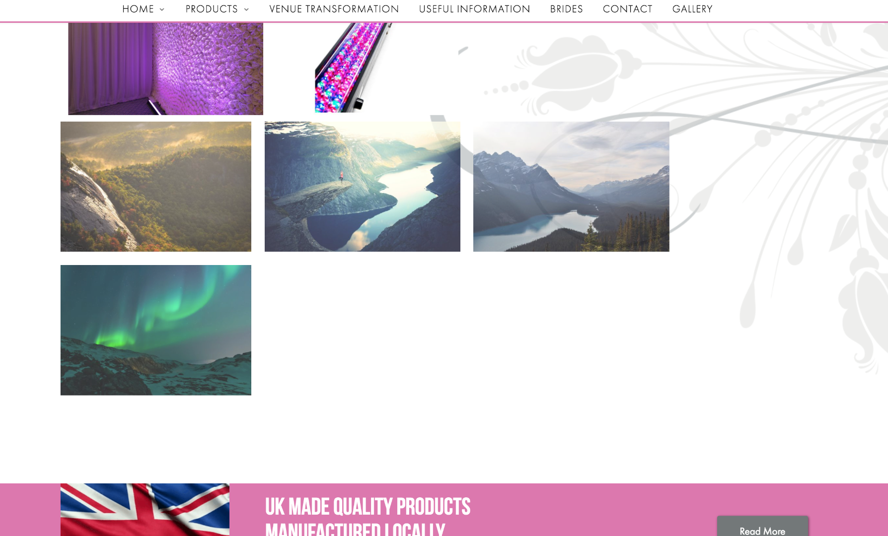

I am using a tab gallery selector in one of my product tabs, However it doesn't seem to want to read the script.
I have placed the script at the bottom of the index.php file and all the HTML within in the custom field tab.
I have tested in a regular Joomla article and it all works fine.
What would be preventing it to read the script in the custom field tab.
I have provided the exact page above and the issue is under tab 'style & colour'
It currently displays 4 images and when clicked on it should display a large image below them

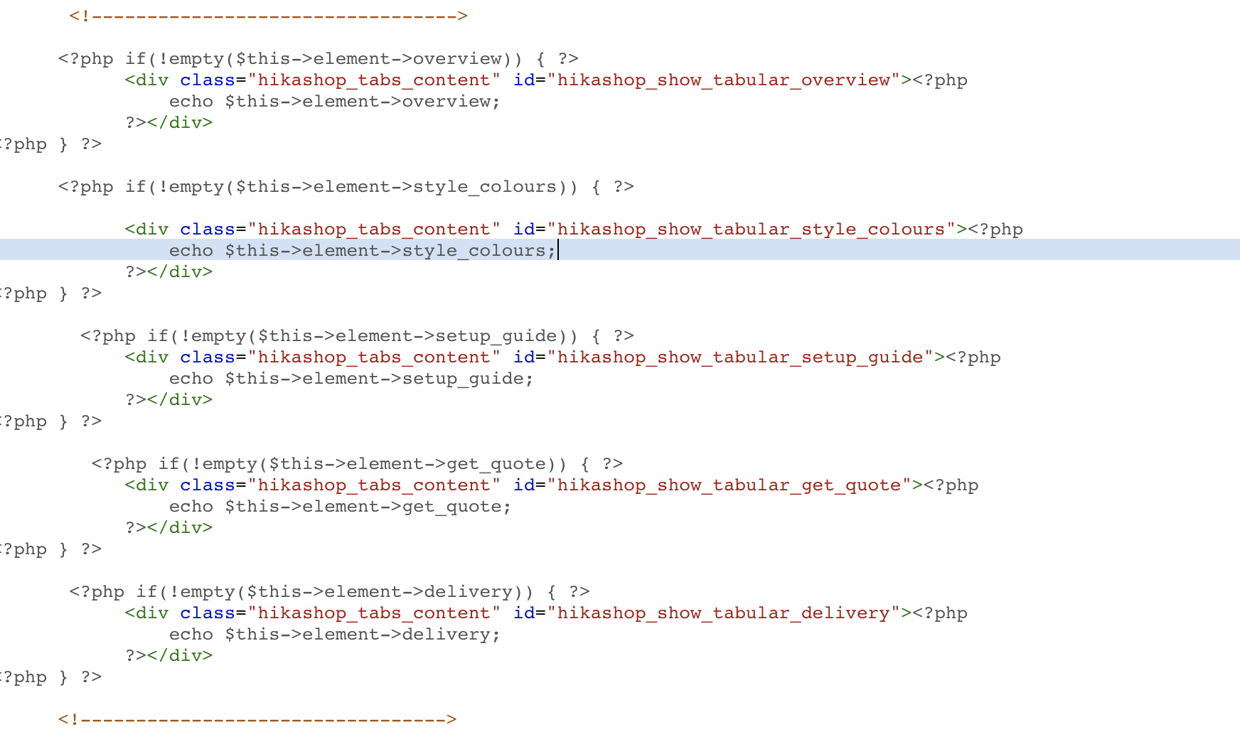

  • Posts: 256
8 years 8 months ago #284376
No its not a plugin. I have added the script into the index.php file to function and everything else is HTML and CSS.
Do I just add that PHP into the show_tabular.
I have attached what the tab section looks like under show_tabular
Here is the link to the Tab Gallery Selector I am trying to reproduce as an example of its function.
www.w3schools.com/howto/howto_js_tab_img_gallery.asp

8 years 8 months ago #284538
Ok, I've looked into it.
The issue is with your script code.
If you look at the javascript it uses, you can see that it basically adds the URL of the image in the img tag with the id expandedImg.
However, if you look at the HTML of the page, you can see that you have twice the gallery on the page with twice the img tag with the id expandedImg:
monosnap.com/file/hXFJ2q0F2YDwImnZk12PBjkLfomF95
Now, this is not valid HTML and cannot work, even in a joomla article. If you add two galleries with your code in a Joomla article, you'll see that it doesn't work properly either.
Please understand that we're not supposed to help with debugging your customizations...
  • Posts: 256
8 years 8 months ago #284648
Thankyou for helping me out. The reason it was repeating was because the specification tab was also calling in all of the custom fields as well as my own custom tab fields. Commenting out the specification in the view file as resolved this issue.
