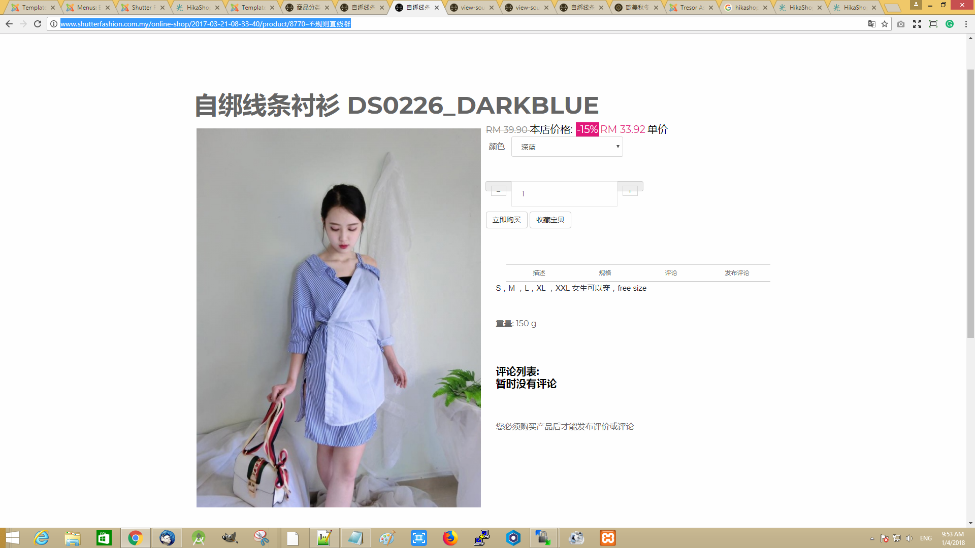

Dear Support,
I face the problem that not function when we using the tabular layout at hikashop. Can you help?
thank you
  • Posts: 86058
  • Thank you received: 14181
8 years 7 months ago #285358
If you look at your browser's console, you can see that there is a javascript error on the page:
monosnap.com/file/1MDYS4ZveO4mjAuwFIjVJWkDhuc9AO
Because of that, the javascript for the tabs cannot be initialized by the browser.
That error seems to come from a jquery compatibility issue.
Try installing and configuring the extension jQuery Easy. It should hopefully fix the problem.
