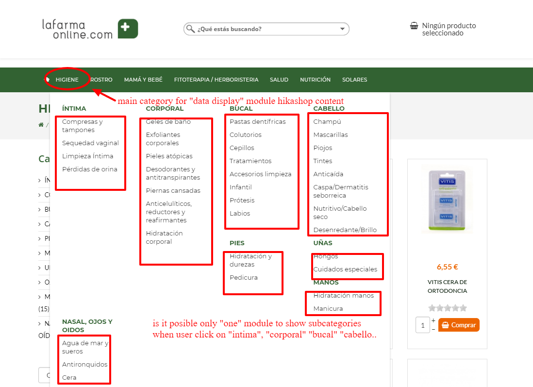

I have a site with 3 levels of menu items that show listings.
Menu item work with product listing.
I'm trying to create a module that shows the sub-categories when the products of a specific category are listed.
Hikashop content module, work fine when I work with a category, the problem is that I have many categories and I would need to know if it is possible to create a module that I synchronize with the rest of the categories.
Thany you
Javier

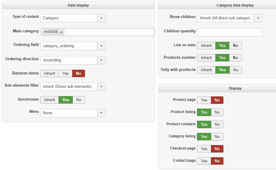

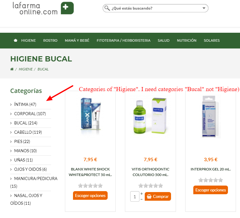

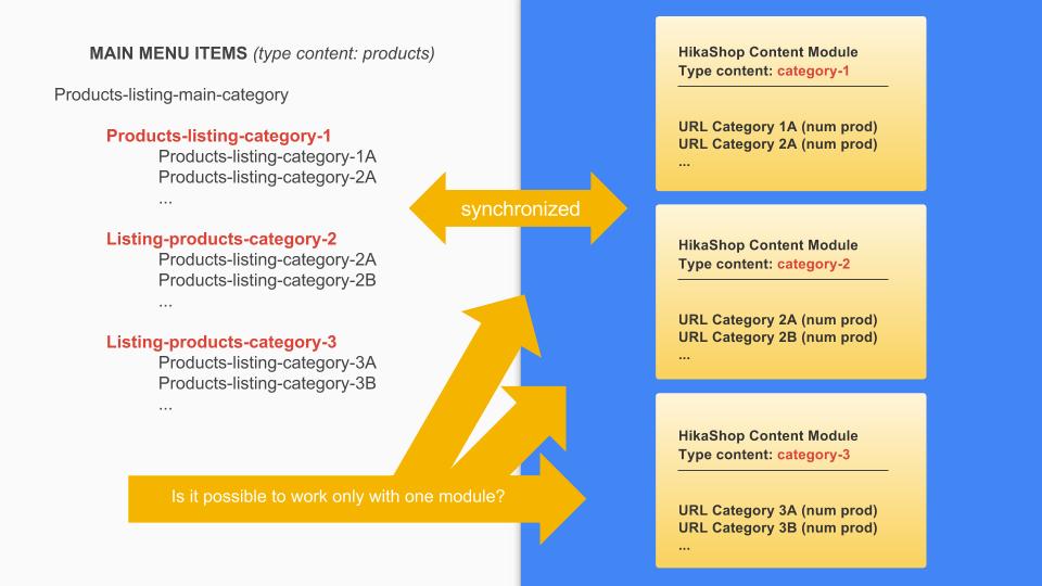

Hi, Nicolas, thank you,
I have used option "synchronize" but I this option not work when existe 3 levels of categories. Only show subcategories of category that is indicated in "Data display > main category" Hikashop Options Module Content.
Site has many subcategories in a third level, and it is much weight for the site to have to create a module for each subcategory instead of synchronizing with a single module
I attach help images
Thank you
Javier

7 years 8 months ago #286164
I don't see how that's possible. Either you have some cache preventing you from seeing the change, or you're not looking at the settings of the good module or something like that.
So please check on that.

7 years 8 months ago #286243
HI Nicolas,
cache is not enable.
I test in other site, and results are the same.it is not possible to use a single module to synchronize categories at a third level. (showing only the subcategories of the listed product category)
Thank you

7 years 8 months ago #286407
Thank you for the details. I was able to reproduce the problem and added a fix on our end for that.
If you download the install package on our website and install it again on yours, it will add a patch in order to handle that properly.
