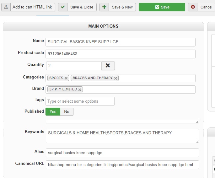

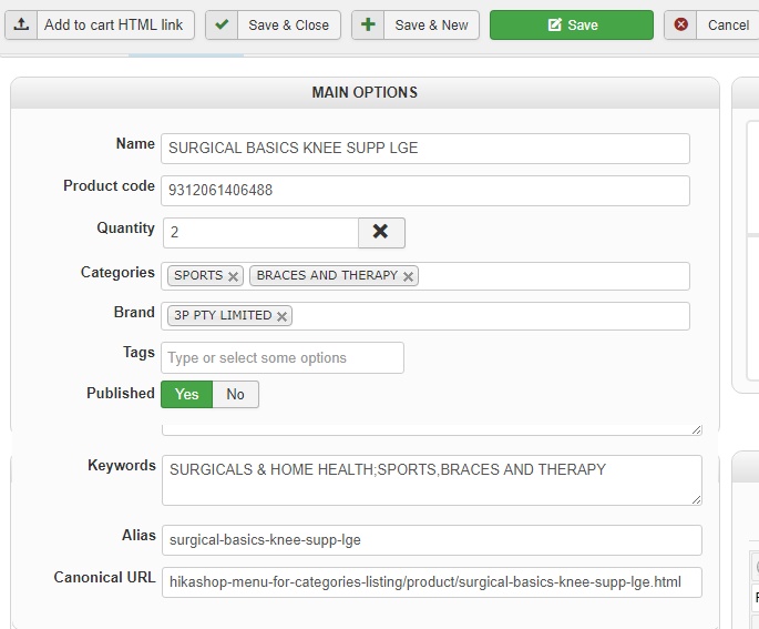

I have a product;
SURGICAL BASICS KNEE SUPP LGE

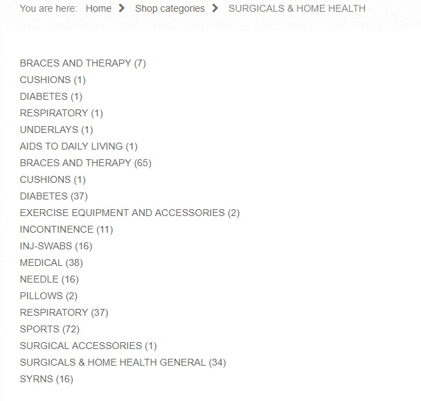

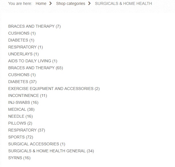

that can be searched for but cannot be located under any of the categories it is assigned to. If you browse the menu from;
here and choose 'sports' it should appear but doesn't. Also, the numbers of items listed next to the categories are correct but the items in the categories don't add up to that amount.
I've attached images showing the product's set up on the back end (keywords, categories) and the menu location where the 'sports' category is listed.

I do see that product on your link:
monosnap.com/file/8GLApjcGBt8MgDbeKVIGCe0riMlw5f

it shows everything at that level (i.e. Parent category) but when I drill down into the assigned category;
braces-and-therapy
it's not there.
Is there something we're not doing because some products do show up in the child category?

You can see that you have two categories named "BRACES AND THERAPY":
monosnap.com/file/cvYRkz99LlqhqEo3sevfaRRlyN25a2
The problem is that since both category have the same name, the link to them is the same (same alias).
So the system displays the products of one of these categories (the one with 7 categories) whether you click on one or the other.
I would recommend to delete one of the two categories and reassign the products to the remaining category.

this often happens to us when we add additional product using the csv import method and we're not sure how to make them merge. Would this be caused by something that can be easily fixed or do we just need to clear the entire inventory and re-upload the entire store from scratch with new items included?
Ian and Stu
edit: I think that the duplicates have an extra space in them. Before I erase everything and troubleshoot the csv, is there any what to edit categories that sit under a parent category? They don't seem to be editable. - Thanks

We got it to work but had to do a fresh import of everything which seems to have removed our images (we have a back-up). Leading and trailing spaces in categories was the problem causing slight differences that were had to see. The other problem is, if you have a parent category but no child categories issues arise.
