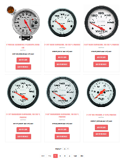

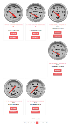

The Store should display 6 products per page. Some pages this works fine and others are all over the place. The attached images show a good page and a misaligned page. Any idea why this is happening - many thanks.

You should use the setting "height consistency" to make all "tiles" the same height and avoid that issue with the responsive grid system.

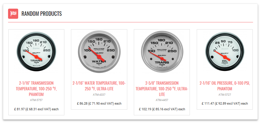

Thank you for your reply. I can confirm that "height consistency" is set to YES. I also have the same issue with Random Products where the box will be different heights due to the content. How could this be resolved? Than k you for your time.
8 years 5 months ago #289033
Your issue is probably coming from your template CSS, using that kind of CSS code will probably do the job :
.hikashop_subcontainer.thumbnail {
    height: 300px;
