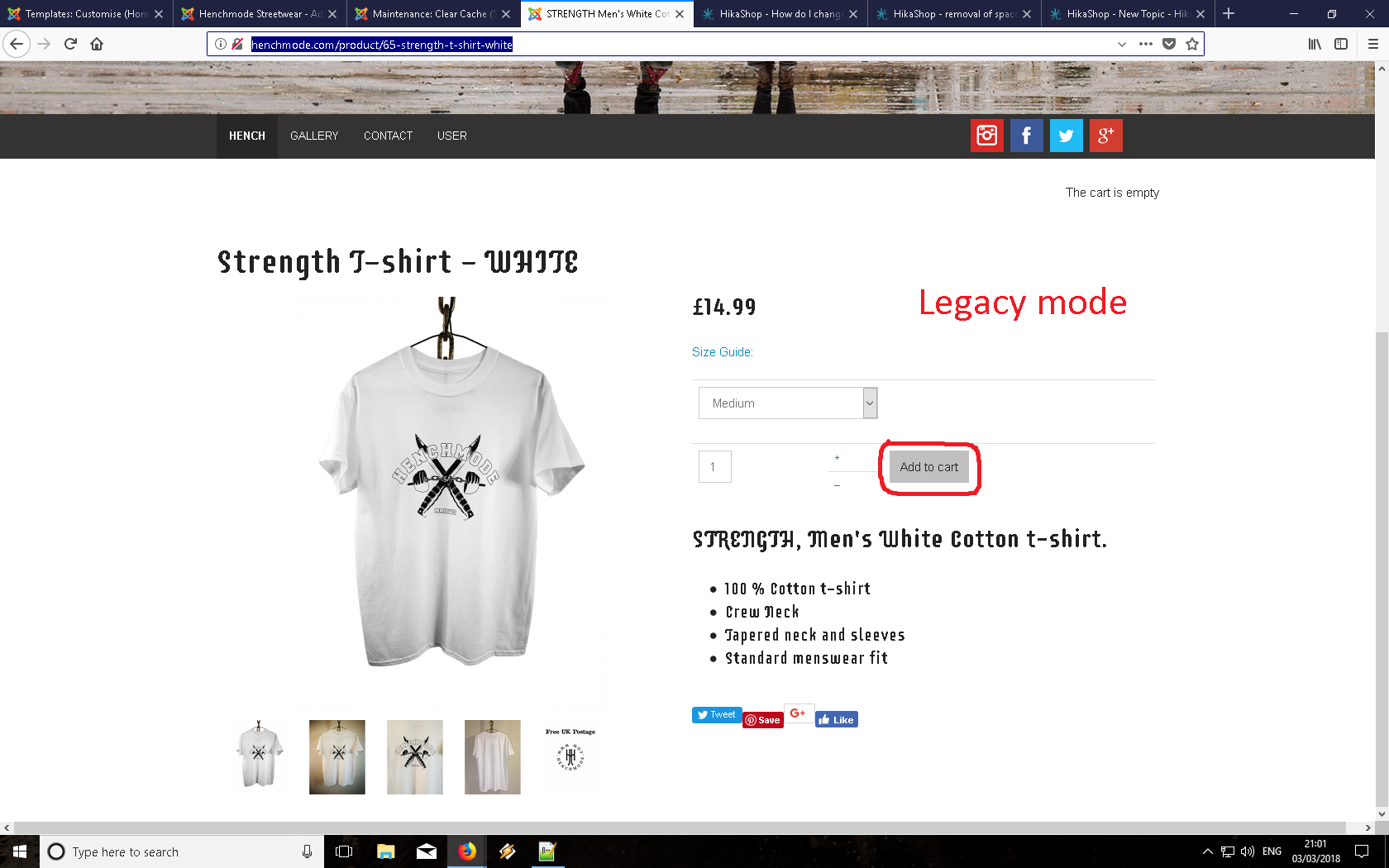

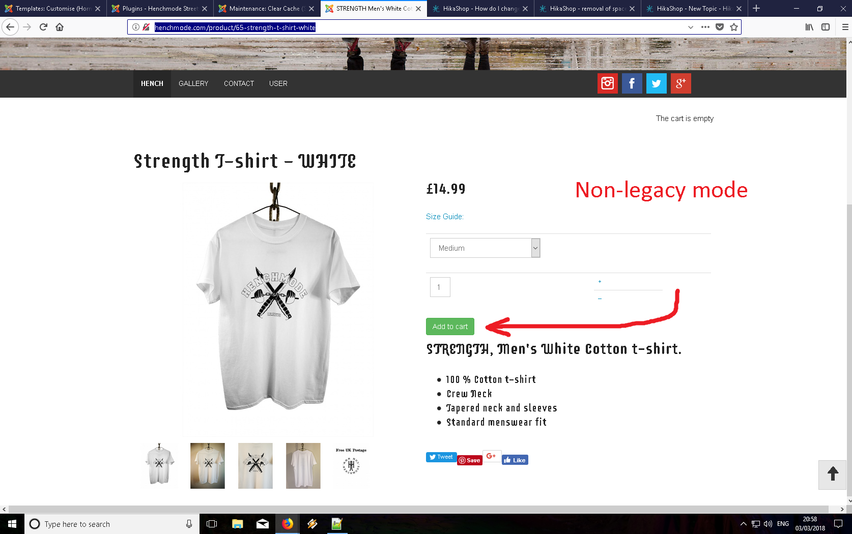

Deactivating legacy mode for the "Add to cart" button has caused the button to relocate to a different position on the product page.
Can you advise which view I need to access, which piece of code I need to relocate and where it needs to be placed in order to get the button to return to the position it was in whilst in legacy mode?

Whenever legacy add to cart is activated, the button is contained within the last cell of the table in "product / quantity.php"
Whenever I turn off legacy mode, the button relocates to outside of the table. Is this not something to do with the PHP in the "product / quantity.php"

As Jerome said, the point may be Css, I can be sure of it because switch to legacy mode or not don't leads the add to cart button to move.
But the add to cart button class change from "button hikashop_cart_input_button" to "hikabtn hikacart", that's why before touch the Html/Php structure, the most simple is maybe to adapt the Css.
